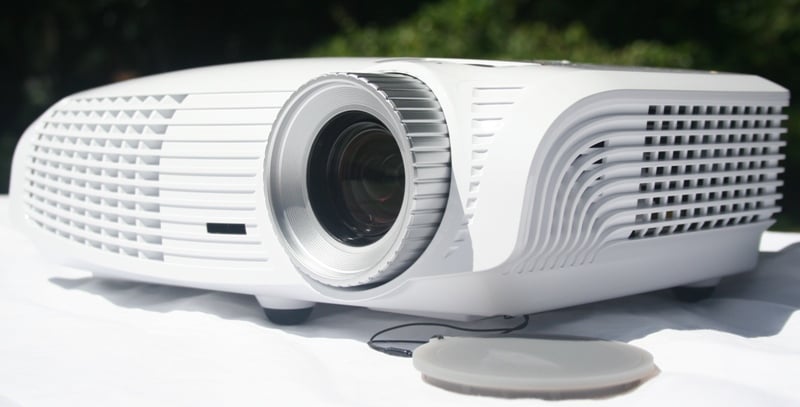

Optoma HD20 DLP Projector Review
by February 26, 2010
  • Product Name: HD20 DLP Projector
  • Manufacturer: Optoma
  • Performance Rating: StarStarStarhalf-star
  • Review Date: February 26, 2010 05:00
  • MSRP: $ 999
  • Buy Now
Display Type Single 0.65” 1080p DMD DLP Technology by Texas Instruments
Resolution Native 1080p (1920 x 1080)
Brightness (Typical) 1700 ANSI Lumens
Contrast Ratio 4000:1 (Full On/Full Off)
Lamp Life and Type Estimated at 4000/3000 Hours (STD/Bright)
230W P-VIP Throw Ratio 1.5 to 1.8:1 (Distance/Width)
Projection Distance 4.92’ to 32.8’ (1.5 to 10m)
Image Size (Diagonal) 37.6” to 301.1” (0.95 to 7.64m)
Aspect Ratio 16:9 Native, 4:3 and LBX Compatible
Displayable Colors 1.07 Billion
Uniformity 70%
Remote Control Backlit Remote Control
User Controls Complete On-Screen Menu Adjustments in 21 Languages
Computer Compatibility HD, UXGA, WXGA, SXGA+, SXGA, XGA, SVGA, VGA Resized, VESA, PC and Macintosh Compatible
Video Compatibility NTSC, PAL, SECAM, SDTV (480i), EDTV (480p), HDTV (720p, 1080i/p)
Projection Lens F= 2.55-2.87, f= 22.4-26.8mm, 1.2x Manual Zoom and Focus
Horizontal Scan Rate 15.3 to 91.1 KHz
Vertical Refresh Rate 24 to 85 Hz

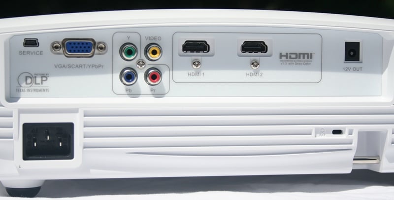

 I/O Connectors Two HDMI, VGA-In, Component Video, Composite Video and +12V Trigger
Security Kensington® Lock Port, Security Bar and Keypad Lock
Projection Method Front, Rear, Ceiling Mount, Table Top
Offset 116%
Weight 6.4 lbs (2.9kg)
Dimensions (W x H x D) 12.76” x 3.82” x 9.21” (324 x 97 x 234 mm)
Noise Level (STD/Bright) 32dB/34dB
Keystone Correction ± 5° Vertical
Operating Temperature 41° to 95°F (5° to 35°C), 80% Max Humidity
Power Supply AC Input 100-240V, 50-60Hz, Auto-Switching
Power Consumption 308 Watts (Bright), 254 Watts (STD), <1 Watt (Standby)
Standard Accessories AC Power Cord, Composite Video Cable, Remote Control, Batteries for Remote, Lens Cap, User’s Manual, Quick Start Card and Warranty Card
Optional Accessories Ceiling Mount, Component Cable, HDMI Cable, Composite Video Cable and Panoview™ Series Screens
Warranty One Year Limited Parts and Labor, 90 Days on Lamp
  • Price
  • Great plug and play performance
  • Noise reduction
  • Marginally adjustable
  • Poor jaggie reduction
  • Auto-source doesn't give enough time for HDCP
  • Blinding backlight on remote
  • Light leakage from front of unit
  • Loud fan
Introduction
Optoma has upped the bar with their release of the HD20. This sub $1k projector is full 1080p, has more than enough inputs for most applications, and gets you into a front projection system for an unbeatable price. Value shop for a power retractable screen and a mount and you're only out around $1700. I know lots of people that have paid that (and more) for a 50" flat panel. At this price, if it turns on it's pretty much a success. Well, I'll spare you the suspense - it turns on.

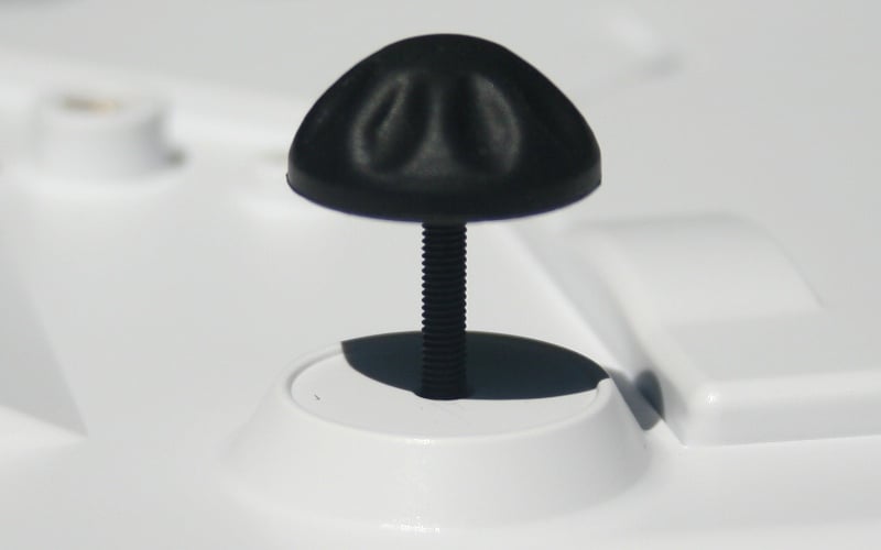

the normal offset is 7.8 hell 8“inches) tilt the projector slightly upward if you need to..usually have to with low ceiling and a ceiling mount.. the picture will start a foot or more below the ceiling. and get about a 3-5”“ top and the keystone feature will fix the vertical.. only a little keystone correction goes a long way.I wouldn't suggest tilting it upward more than 6-8” .. I have not noticed any difference in the picture or any additional artifacts tilting it upward (6“ on 100” diag. screen) … You only get a very dark gray at best…. so that's the trade-off with a darkchip 2 vs darkchip 3 projector.. compare the price difference and live with this shortcoming..

The HD20 does not have lens shift. It has minimal offset though which you can see with the projection calculator at projector central.
http://www.projectorcentral.com/Optoma-HD20-projection-calculator-pro.htm
A 100“ diagonal has 7.8” of lens offset - FIXED.
