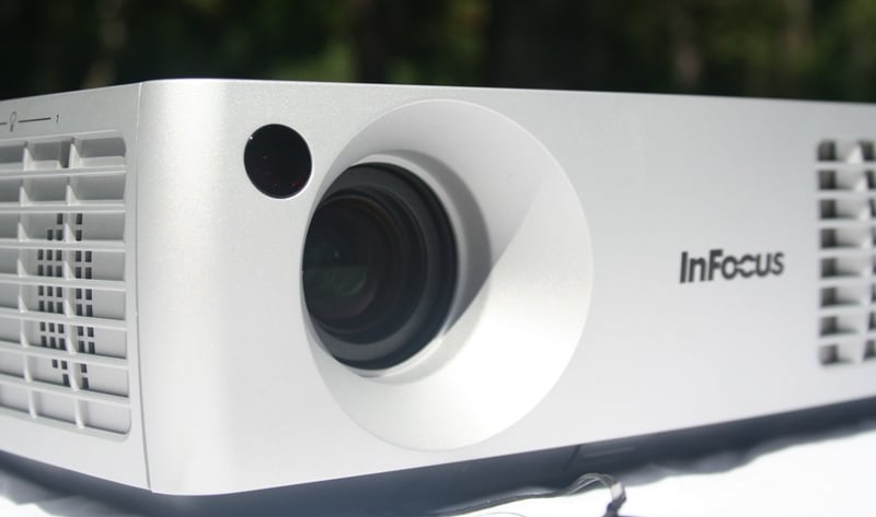

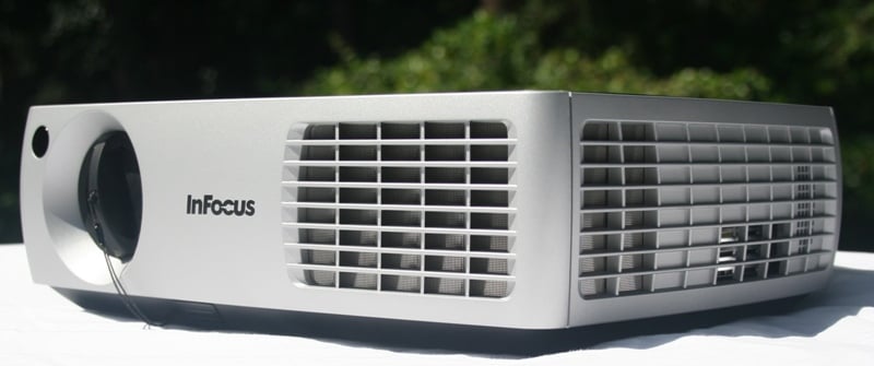

The InFocus IN3108 DLP projector is, first and foremost, a very attractive product. It comes in a nice canvas carrying case that is well padded and braced at the sides, has a Velcro strap to hold the unit in place, and a padded fabric top to protect it from whatever else you might want to throw in there. It even has individually labeled pockets for each of the cable types. There is a card holder for your business card an extra mesh pocket to hold the manual. This is a projector that, InFocus at least, expects to be portable.

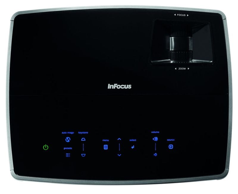

The projector itself sports a gloss black top and gray body. There is a manual adjustment control on the top and three connection points for ceiling mounts on the bottom. There are no visible controls when the IN3108 is powered down except for an illuminated power icon on the top in amber. Once you press it (there is no tactile feedback - it's like controlling one of those capacitance touch screen cell phones), the rest of the controls light up in blue. You have controls for Auto Image, cycling through Presets, Menu, Volume, and cycling through the different Sources. The only downside to this is that it is very easy to accidentally hit a control. The upside is that the top presents a very clean look and has a very high-tech "iPod-esque" feel.

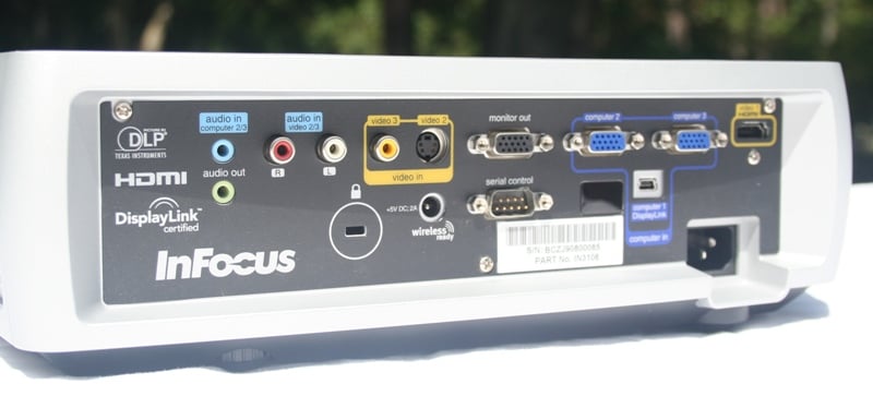

The back of the unit has a number of different inputs and outputs. There are 3.5mm jacks for both audio in and out, composite, S-video, and HDMI inputs, stereo RCA inputs, two VGA computer inputs, a VGA monitor output, an RS-232 port for automation, and a USB "DisplayLink" port. While most of these are self explanatory, the DisplayLink is a bit different. The way this works is you can connect any (recent) Mac or PC to the projector via USB and get both video and audio without having to load in drivers. You'll need Windows XP SP2 or Vista or MAC OS 10.3 (Tiger) or better with a USB 2.0 port. The interesting part is that you can get a DisplayLink Extender which uses Ethernet to extend the range up to 330 feet. Using the DisplayLink technology, you can run up to 6 projectors off of one computer which is, frankly, awesome. All I need now is for InFocus to send me 5 more projectors to test this out with. And if we could set that part of the review up to coincide with the Super Bowl, that'd be great.

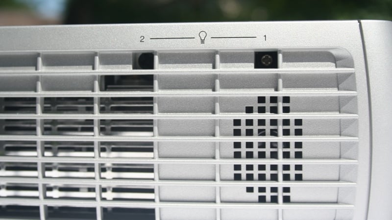

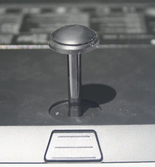

The projector has three mounting holes on the bottom as well as rubber feet, the front of which extends with a push of a button for tabletop placement. There is an automatic sensor for the orientation so you won't have to manually select ceiling or table configuration. The IN3108 really is a plug and play projector. It auto senses inputs, it auto keystones, and it knows if it is on the ceiling. The focus is manual but there is digital zoom, horizontal and vertical lens shift (a very nice feature not normally found on these types of projectors), and some color correction control. For a 90" screen you have a minimum throw distance of 9.8 feet and a maximum of 10.9.

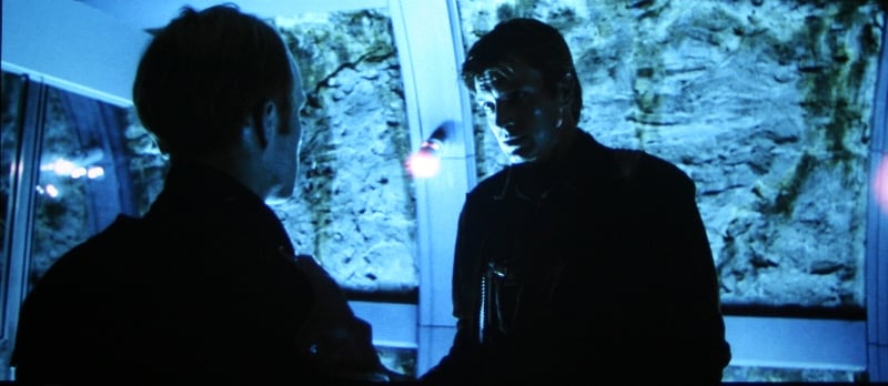

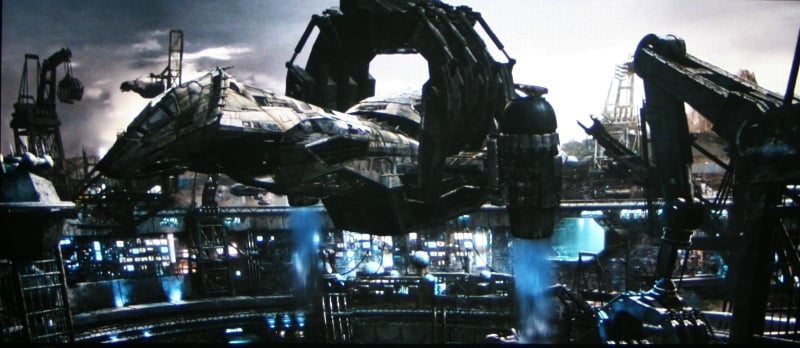

If the InFocus IN3108 had a weak point, it was black levels. In the below picture from the Blu-ray version of Serenity, you can see how the blacks are really gray. Even then, some of the detail in the dark areas is still being lost. As we bumped up the brightness, the detail came through but at the expense of washing out the picture. We had to compromise between seeing the detail that we knew was there and having darker blacks.

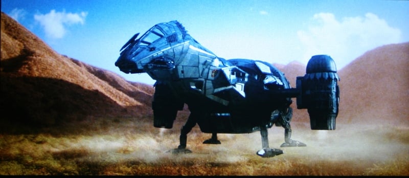

You can also see, however, the detail that the InFocus IN3108 can produce. With a decent signal, you get stunning detail with little to no pixel blur. We were shocked at how crystal clear the picture was. Brightness was also not an issue. Even with lights on in the room, the picture was easily discernible and quite enjoyable. Changing the bulb to low power reduced the overall brightness but not significantly. Even in well lit environments you won't have much of a problem viewing most content.

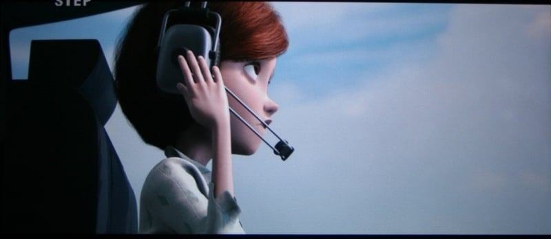

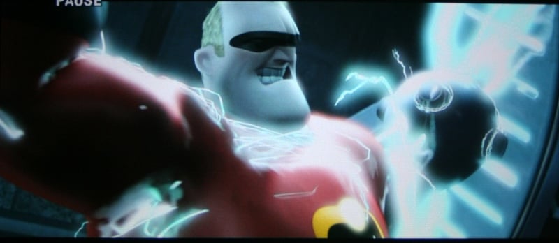

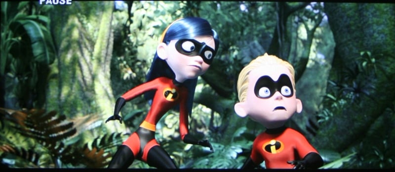

One movie we love to test color saturation with is the Pixar classic, The Incredibles. As you can see, colors were well saturated and vivid. Detail was sharp and crisp. The IN3108 can accept virtually any source and is compatible with NTSC, PAL, SECAM, 480i, 576i, 480p, 576p, 720p, 1080i, and 1080p/60 all via HDMI. With a 480i stream across HDMI, the picture was jittery and unstable. accurate deinterlacing is virtually non-existent on this projector. You'll want to mate it with as clean a source as possible. As it is really designed to be paired with a computer, this shouldn't be much of a problem.
