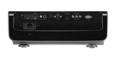

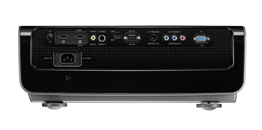

| Inputs (Video): | (D-sub 15pin) x 1, HDMI v1.4 x 2, Component Video x 1, Composite Video in (RCA) x 1, S-Video (Mini Din 4 pin) x 1 |

The new BenQ W7000 isn't all about 3D, however; it does have a few other features. First, it sports two HDMI v1.4 and one each 15pin D-sub, component, composite, and S-Video input. This should be more than enough for almost any installation. It also brags 125 percent vertical and 40 percent horizontal lens shift adjustment with zero vertical offset which should make non-optimal placements a breeze. This is really good at this price point. The 2000 ANSI lumen output is certainly respectable as is the 50,000:1 contrast ratio. The W7000 has a dynamic iris and supports all the current 3D formats.
