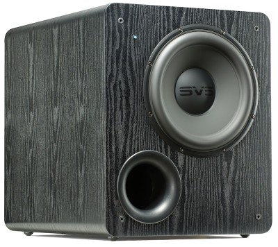

SVS PB-2000
The reason for all these driver improvements is not just to increase performance and to improve longevity. The new Sledge STA-500D amplifier is conservatively rated 500 watts RMS continuous and 1100 watts peak dynamic and is described by SVS as delivering "crushing power". SVS felt that no normal driver would be able to stand up to their new amp. But power isn't the only thing in the STA-500D arsenal. This amp has integrated DSP controls for fine-tuning your bass experience for your particular environment. While specifics are unavaliable, SVS says the STA-500D has, "an array of filters," as well as volume, gain, and phase controls. There is a frequency-dependent limiter/compressor algorithm with adjustable attack/release and compression parameters to protect your subwoofer performance from accidental volume increases.
The SVS 2000 series subs come in two flavors - sealed and ported. The SB-2000 (pic at the top of this article) is sealed and is just large enough to enclose the driver and amp (14.2" cube). It weighs in at an impressive 35lbs and brags a usable frequency response down to 19Hz! It looks to have a fairly standard black ash vinyl wrap which is to be expected at this price point. This is the perfect sub for those on a budget that want performance but don't have the room for a larger sub. While other manufacturers charge more for their smaller subs (usually because of the larger amp requirements), the SB-2000 is the less expensive of the pair at $699.
The PB-2000 has a front-firing port for easier placement but has all the same components as the SB-2000. With the ported enclosure, SVS was able to tune the PB-2000 to a staggering 17Hz low point. The PB-2000 is much larger than the sealed 2000 series sub at 20.9” x 17.3” x 22”. The PB-2000 is also much heavier at 66 pounds so you'll probably want to get some of those carpet sliders until you get the PB-2000 into the perfect position. The extra materials in constructing the enclosure bump up the price of the PB-2000 $100 to $799.

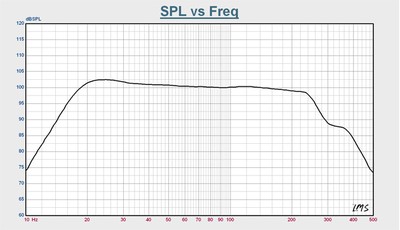

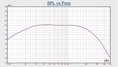

SVS SB-2000 Published Frequency Response
SVS PB-2000 Published Frequency Response
- 20Hz 103.8 dB
- 25Hz 107.6 dB
- 31.5Hz 109.6 dB
- 40Hz 110.1 dB
- 50Hz 110.5 dB
- 63Hz 111.5 dB
Bassaholic Roomsize Rating: Large
Source: About.com Stereos from Brent Butterworth Testing
SB-2000 CEA
2010 Results (2 meter RMS)
20Hz 92.1 dB
25Hz 97.1 dB
31.5Hz 102.8 dB
40Hz 108.3 dB
50Hz 108.9 dB
63Hz 109.2 dB
Bassaholic Roomsize Rating: Medium
Which One Should You Get - the SB-2000 or PB-2000?
The question you need to ask yourself when you're looking at the Series 2000 subs is: "What is the size of my room?" If you have a large room and need a lot of output, the ported PB-2000 is your sub. If you have a smaller room, then save yourself the $100 and choose the smaller SB-2000. The smaller sub will certainly please your significant other by blending into the room decor more easily.
The PB-2000 earns our Bassaholic Large room rating - which is appropriate for a room over 3000 cubic feet. The SB-2000 received our Bassaholic Medium room rating - meaning it can slam a room that's less than 3,000 cubic feet in volume at reference level.
Of course, the amount of output isn't the only difference between these two subs. The larger PB-2000 has a bit more low extension, dropping down to a bone-rattling 17 Hz. But lest you think the SB-2000 is a slouch, its sealed enclosure will provide a more than respectable 19 Hz. The output differences, however, are pretty significant. Expect the ported PB-2000 to play about 10 dB louder below 30Hz.
