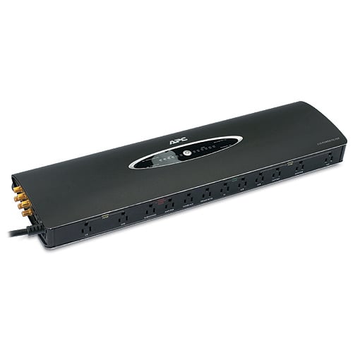

The APC AV C10 Power Filter is based along the design principles of their H15 Power Conditioner but it lacks voltage regulation. Instead it’s a straight up power filter but not a typical one you find from their competitors. This baby’s got some meat on its bones which will surely make the end user happy knowing they are actually buying a device that will do no harm to their equipment while at the same time actually protecting it from dangerous surges and power spikes.
Design Overview
The APC AV C10 is not your typical power filter. In fact, if it was any other company, they would have stamped the words “Power Conditioner” on the product, not gone through the extensive and costly UL certification process, and simply called it a day. APC AV chose the high road here. As competent as the C10 is for surge suppression and noise filtering, they don’t consider it to be a power conditioner. Their definition of power condition is on the same page as mine in that it must meet the three following criteria:
- Surge suppression
- EMI/Noise filtration
- Line (voltage) regulation
The C10 meets 2 of 3 of these requirements. If you want line regulation, you have to step up to an H10 or higher model.

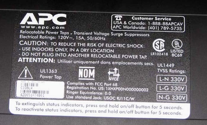

Safety agency approvals: UL1449, UL1363, UL + CSA FCC Part 15 and Part 68 Class B
- UL1449 - Standard for Transient Voltage Surge Suppressors
- UL1363 – Standard for Relocatable Power Taps. A relocatable power tap (RPT) is intended only for indoor use as a temporary extension of a grounding alternating-current branch circuit for general use.
- Part 68 - uniform standard for the protection of the telephone network from harms caused by connections of terminal equipment. What this means is this device can NOT cause harmful interference and it must accept any interference received even if it can cause undesirable operation. The telephone on-hook impedance must be preserved and the line must remain properly balanced so that no hum or added crosstalk can ingress at the customer premise or central office and there is no interference with the telephone ringer.
- Part 15 B - has to do with radiated emissions for commercial usage. Generally, this means the device leaks a signal at some level. Because it costs money to filter out noise, there is always a balance struck between regulatory compliance and perfect filtering in these devices. Microwave ovens or devices with microprocessors may leak within allowable limits but may generate an undesired signal that interferes with something in the way of a licensed communications device such as a radio or phone.
The APC C10 RJ11 phone splitter even includes an REN# (Ringer Equivalence #) which pertains to the electrical load the telephone line sees when the device is connected. 1 REN is equivalent to a 693 ohm resistor in series with an 8uF capacitor. The lower the REN# the better so that it doesn’t interfere with call waiting or caller ID. Most modern phones have a REN# of around 0.2. The APC C10’s REN# is a whopping 0.0 so basically when it’s connected to your phone line, it’s transparent.

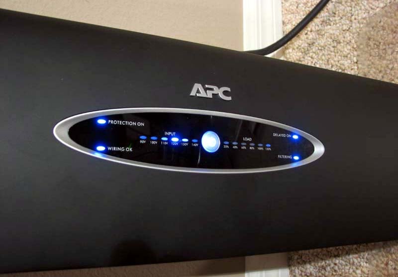

Display
There are a number of lights on the front panel which indicate the state of the unit. You have some control over them with respect to turning all of them off but the main power and protection ones by pressing and holding the on/off button.
- Protection On - on/off LED status illuminates blue when the unit is working properly
- Wiring OK - LED status illuminates blue if your outlet wiring is correct
- Filtering - LED status illuminates blue when the unit is working properly
- Input - monitors line voltage via blue LED indication from 90V to 140V in 10V increments
- Load – monitors the load condition on the line via LED indication from 20% to 120% in 20% increments
- Delayed On – LED illuminates blue when the delayed outlets are active (6 sec delay during initial power up)
I felt the LED display for line voltage and load was a bit cheesy and would have preferred a digital read out like Monster offers on their similarly priced HTS-1000MKIII. But considering the APC C10 has 4 additional filtered outlets over the Monster product, I think I’d take more filtered outlets over a digital readout I’d likely spend very little time monitoring. The APC in comparison is not nearly as flashy or busy looking as the Monster but instead is a much cleaner more ergonomically friendly solution.

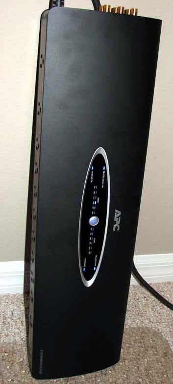

Placement
I brought this unit over to my brother’s house and wired it to his home theater system which consisted of an older Yamaha A/V receiver, Sharp Aquos LCD display, Toshiba DVD player, Sony CD changer, Brighthouse cable box, and a JVC VCR. I neatly horizontally placed the unit under his A/V rack on the ground which was out of sight but still accessible. The C10 has pads on the bottom which increases static friction so it can be placed horizontally on the ground without fears of it moving around either from cable tension or excessive bass output from a local subwoofer. The unit also comes with a metal bracket which is said to be used for wall mounting but comes with no hardware to attach and I didn’t quite understand how to secure it to the unit. Regardless I feel the C10 is much less obtrusive when placed on the floor under an entertainment center then being mounted on a wall.
Once I flipped the power switch on my brother’s A/V system, it came alive and he breathed a sign of relief now that his system was fully protected. He remarked that the picture quality seemed to improve on his cable signal but I wasn’t certain I saw any appreciable benefit. This very well could have been a placebo affect. I was confident that the C10 didn’t cause any signal degradation, while at the same time ensured his system was protected against the numerous lighting storms and power surges we typically get in Florida. The APC AV C10 marks another well executed and no BS A/V power product from a company that is, in my experience, unparalleled in their collective knowledge of power protection and backup. I highly recommend this unit for anyone looking for a cost effective surge and power conditioning solution with ample outlets and unparalleled reliability.
