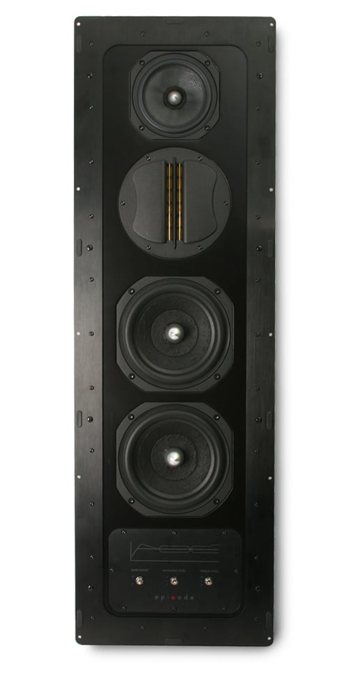

ES-HT950-IW-7
- WOOFER: Dual 7" NCS Cone, Aluminum phase bullet, High Temp 1-1/4" diameter Voice Coil
- MIDRANGE: 5.25" Tri-layer Honey Comb Cone, Aluminum phase bullet, High Temp Voice Coil
- TWEETER: 4.65" Ribbon Kapton film with aluminum conductor traces / Neodynium magnet structure
- POWER HANDLING: 250W RMS, 625W Peak
- NOMINAL IMPEDANCE: 4
- FREQUENCY RESPONSE(-6DB): 48 Hz - 40 kHz
- SENSITIVITY -2.83 V / 1 METER: 87
- ADJUSTMENTS: Woofers: Bass boost (0/+3dB), Midrange: Level (+2dB/-2dB), Tweeter: Level (+2dB/-2dB) plus screen EQ
- COLOR: White
- CROSSOVER FREQUENCY: 525 Hz, 2.0 kHz
- CONNECTOR TYPE: Woofers: Bass boost (0/+3dB), Midrange: Level (+2dB/-2dB), Tweeter: Level (+2dB/-2dB) plus screen EQ
- WEIGHT: 41 lbs.
- GRILL TYPE: Magnetically held Aluminum Micro-Perf Mesh
- CUTOUT DIMENSIONS: 38.2" x 11.2"
- MOUNTING DEPTH: 4.0"
- FINISHED DIMENSIONS:    39.63" H, 12.62" W, 4.64" D

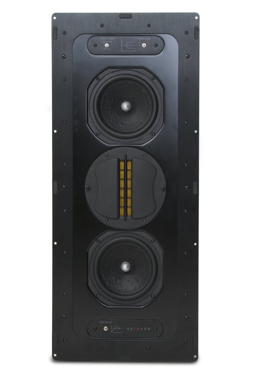

ES-HT900-IWLCR-6
- WOOFER: Dual 6.5" NCS Cone, Aluminum phase bullet, High Temp Voice Coil
- POWER HANDLING: 200W RMS, 500W Peak
- NOMINAL IMPEDANCE: 8 ohms
- FREQUENCY RESPONSE(-6DB): 65 Hz – 40 kHz
- SENSITIVITY -2.83 V / 1 METER: 89 dB
- ADJUSTMENTS: Woofers: Bass boost (0/+3dB), Tweeter: Level (+2dB/-2dB) plus screen EQ, Orientation: Horizontal/Vertical mounting.
- COLOR: White
- CROSSOVER FREQUENCY: 2.2 kHz
- CONNECTOR TYPE: Bi-Amp / Wire via 5 Way all metal / gold plated Binding Posts
- WEIGHT: 26 lbs.
- CUTOUT DIMENSIONS: 28.2" x 11.2"
- FINISHED DIMENSIONS:    29.63" H, 12.62" W, 4.56" D

The ES-HT950-IW-7 (pictured above) is a more traditional in-wall speaker in that it has a single orientation - vertical. There is a 5.25" tri-layer honey cob cone midrange with an aluminum phase plug and a high temp voice coil at the top. At the bottom you'll notice dual 7" Natural Cell Structure woofers, again with aluminum phase plugs and high temperature voice coils. In between is the main feature of the new Episode 900 series speakers - the 4.65" Kapton film ribbon tweeter with aluminum conductor traces and neodynium magnet structure. The 950 is rated down to 48 Hz and up to 40 kHz at -6dB (that -6 is most important on the low end since you stopped hearing it somewhere around 20kHz). This means you'll have little problem crossing it over with a subwoofer which you'll definitely need with that frequency response. The 87dB sensitivity and 4 ohm nominal impedance means you won't definitely need an amp if you spent a lot on your receiver, but you probably will get one anyhow.
 ES-HT900-IWLCR-6 is a little different in design. It is a more traditional D'Appolito MTM design with the 4.65" Kapton film ribbon tweeter flanked on either side by a 6.5" NCS cone woofer with an aluminum phase plug and a high temp voice coil. The 900 (as the LCR in the name suggests) can be used either vertically or horizontally (you can rotate the tweeter for horizontal placement) so that it can be used either flanking a display or under/over it. This speaker has a rated frequency response (again at -6dB) from 65 Hz to 40 kHz. The 8 ohm impedance and 89 dB sensitivity means that you'll be able to pair this with a midline receiver in a smaller room if you have to.
