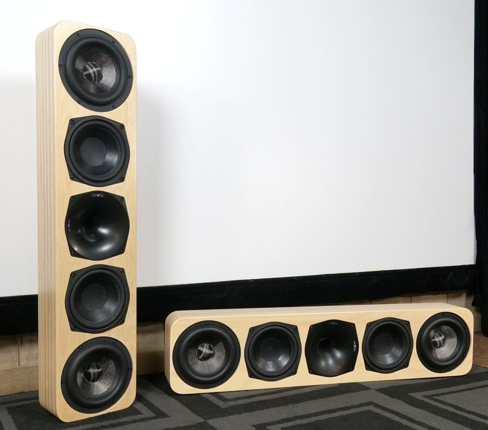

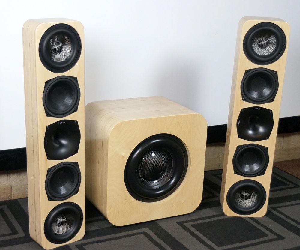

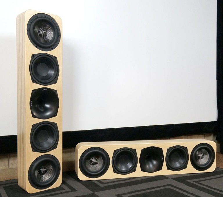

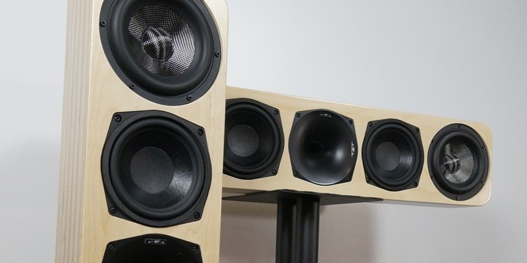

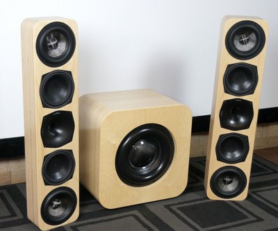

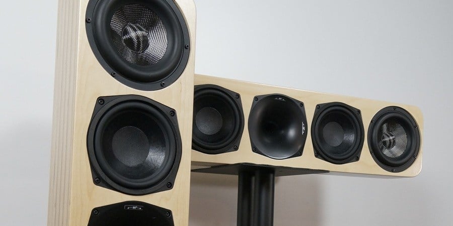

JTR Kallos 465 Appearance
Once unpacked, we are greeted by some tall and thin speakers that pack an array of drivers over a gorgeous lacquered wood finish. The cabinet is made from thin layers of birch which can be seen from the side paneling. The edges running back are heavily radiused for a softer appearance. There are five drivers mounted on the front which all have a black appearance that stands out against the natural wood grain. The Kallos 465 can also be had in a matte black which will blend in better with the drivers. A grille is provided that can hide the drivers. It stretches black fabric over a frame and makes for an opaque covering for the front baffle. My guess is that most owners will use the grilles since they make the speakers look cleaner and less busy.

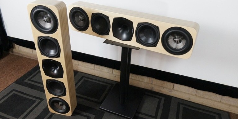

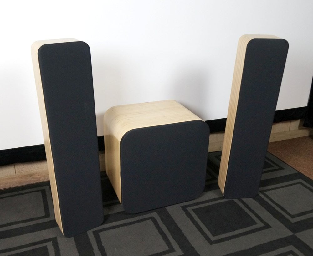

Kallos set grilles3   Kallos set5
They are fairly large as on-wall loudspeakers go, but I don’t think they will be a problem when considering the kind of televisions they will be paired with. At 35” tall, they have about the same height as a 70” television. And with a 4.25” depth, they shouldn’t protrude out from the wall any more than a television with a typical mounting system. They should fit in well with a larger television display, and I don’t think anyone is going to buy such high-powered speakers and pair them up with a small display.

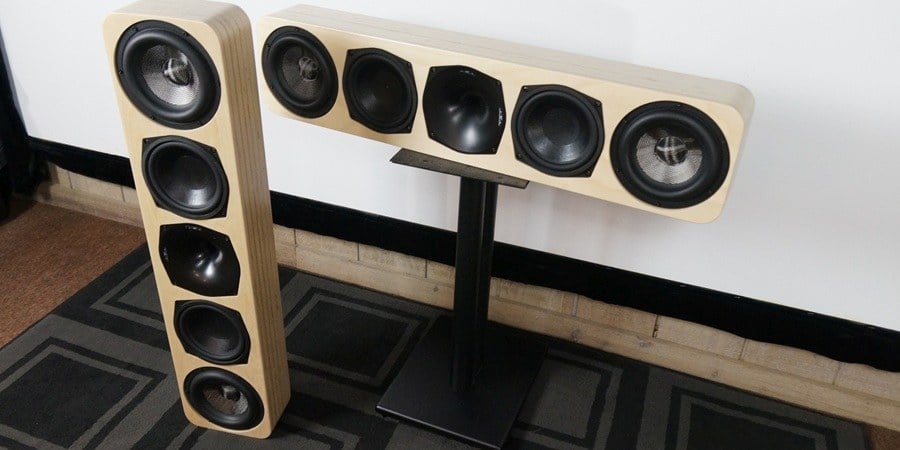

JTR Kallos 465 Design Analysis
At a glance, the JTR Kallos 465 speakers are a sealed MTM (midrange-tweeter-midrange) design that uses passive radiators in the outside edges of the driver array. There are many such on-wall speakers with a similar design, so what separates the Kallos speakers? In a word, firepower. The Kallos 465 will hit way harder than a typical on-wall speaker. So how does it do it? Basically, JTR uses some of the highest-performing drivers around. Not only are these drivers extremely powerful, but they are also highly linear. Let’s begin our discussion of the drivers at the top of the frequency band by talking about the tweeter.

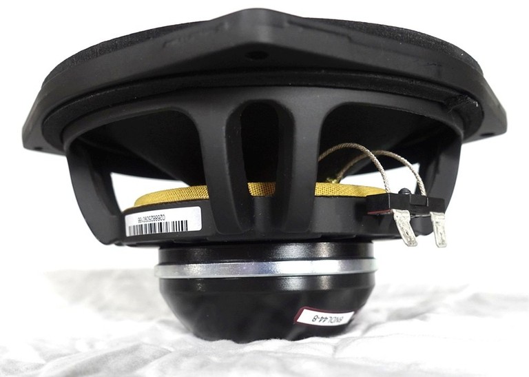

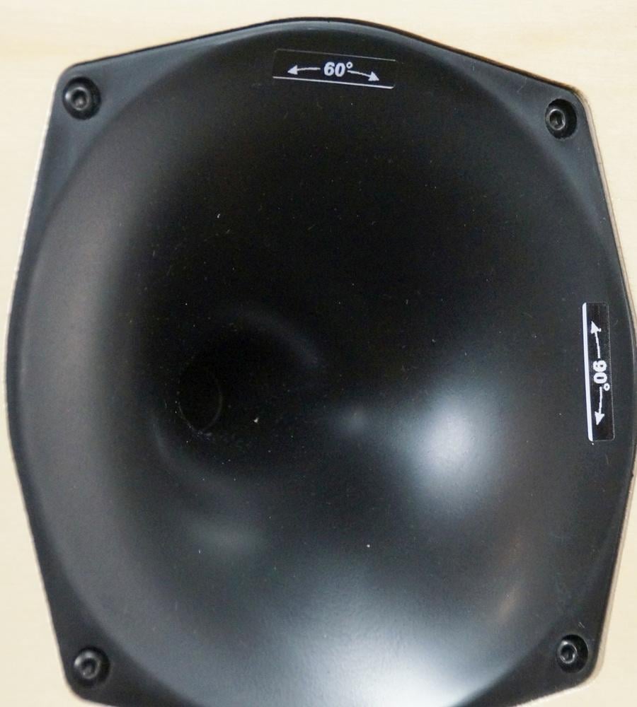

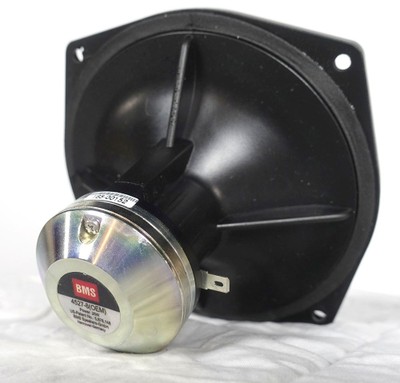

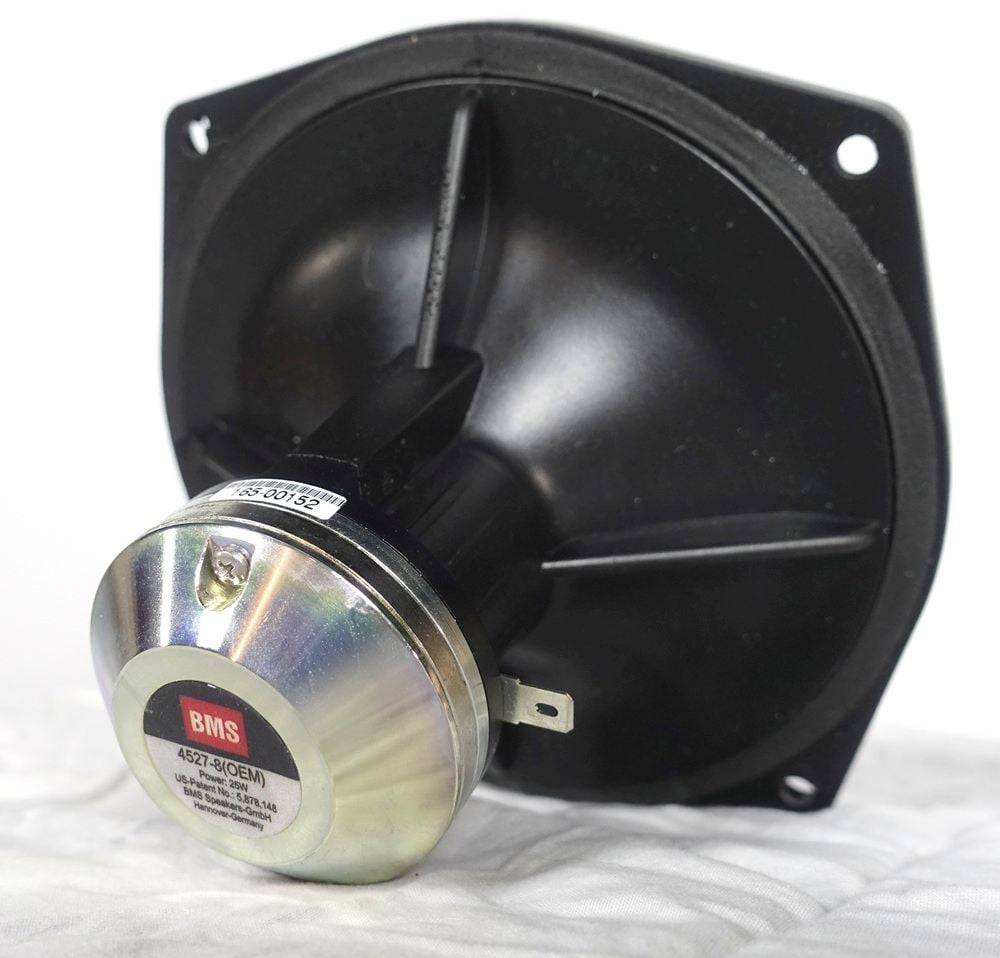

Kallos 465 tweeter horn   465 tweeter motor3

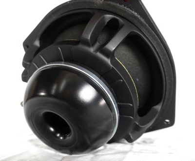

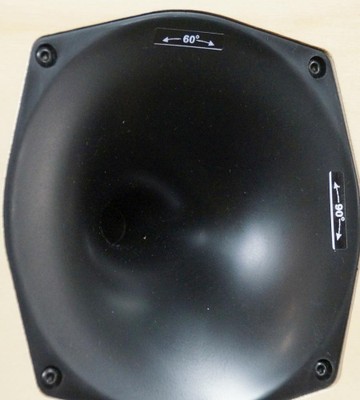

The tweeter is a compression driver mated to a horn. It’s a driver from German manufacturer BMS that looks to have a 1” diaphragm. JTR claims it is capable of 136dB, although it does not say at what distance. It uses a very powerful neodymium magnet motor. The horn looks to have an elliptical curvature with a 60-degree by 90-degree coverage pattern.

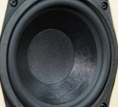

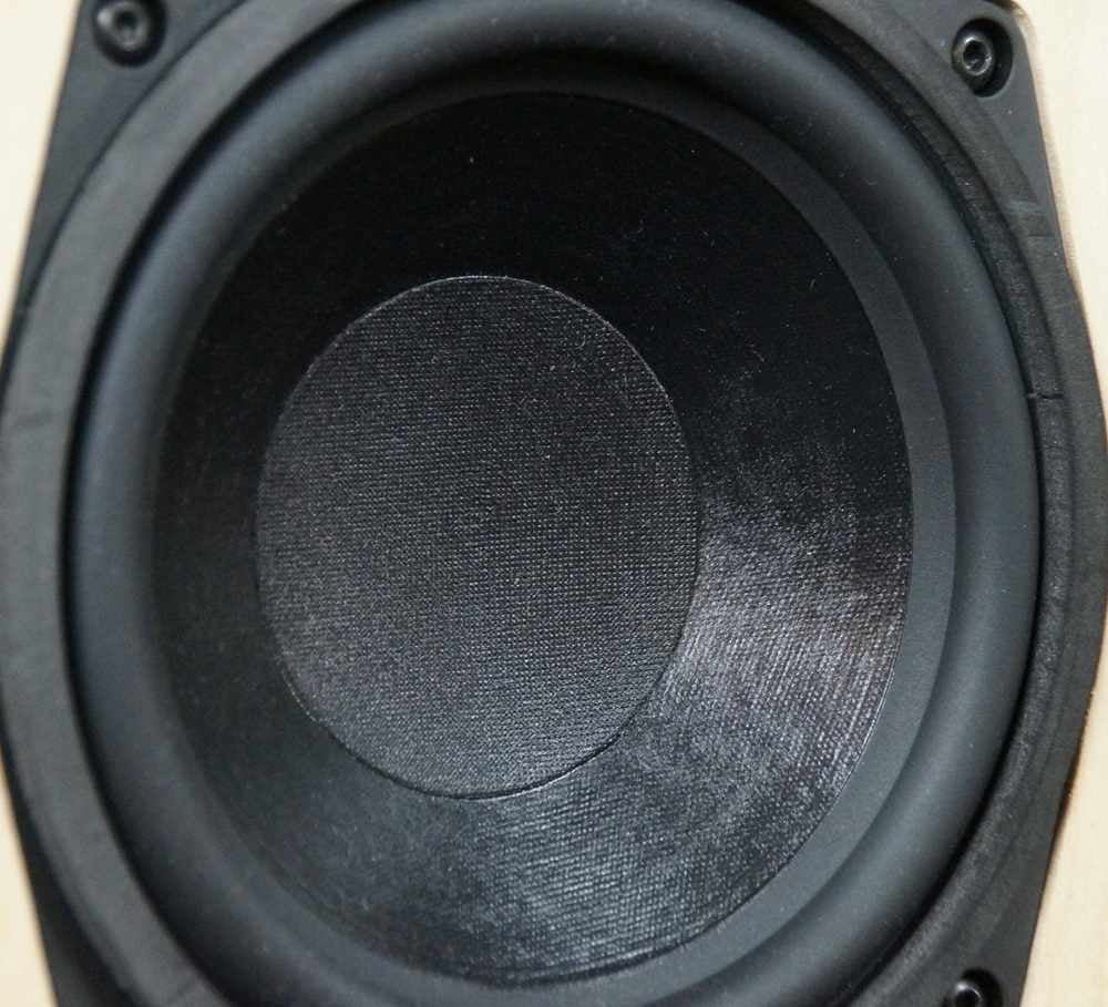

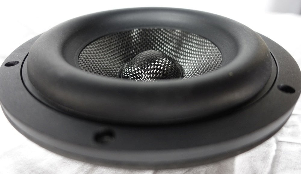

Kallos 465 midrange cone   465 midrange motor2

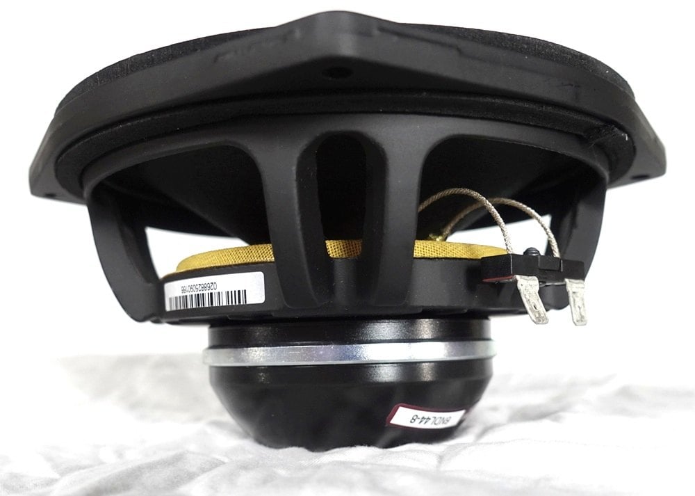

The midranges are two 6.5” drivers from B&C Speakers that use a paper cone. They have a 91.5dB sensitivity with a 400-watt power-handling spec, which is very powerful, especially for an 8-ohm driver. The voice coil has a 1.7” diameter and uses an all-copper winding. The magnet is a very powerful neodymium unit that likely costs a small fortune. It was probably needed in order for the driver to fit in the small amount of depth available; similar and less expensive results might have been had from an iron ferrite magnet, but it would have made the driver too large to fit in the enclosure. Venting is done through the pole piece. The basket is a heavy-duty aluminum piece that looks like it can withstand a lot of vibration.

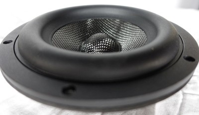

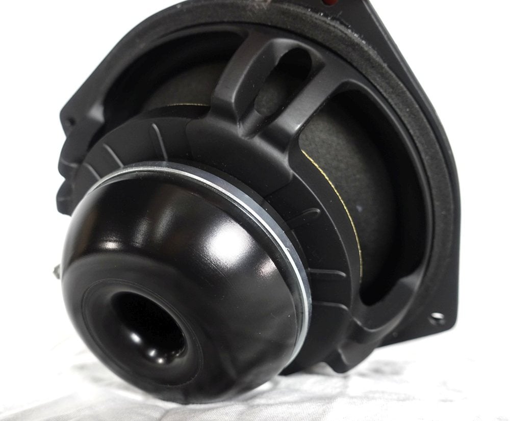

 465 PR front  465 PR rear

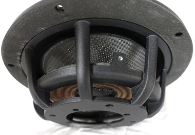

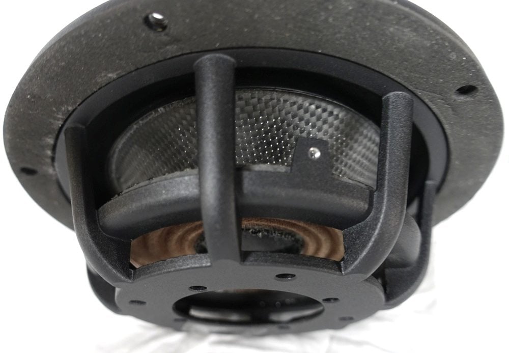

Deeper bass is handled by a pair of passive radiators that have a carbon-fiber woven cone. The radiators have a very beefy surround, which is needed because they are going to require a lot more excursion than the active drivers.

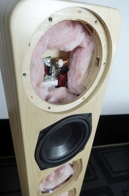

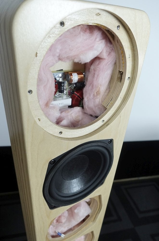

The crossover circuits are made with high-quality components, including high-grade perfect-lay inductors and metallized polypropylene capacitors. Taking a peek at the circuit, it looks pretty involved and looks expensive. The crossover frequency is 1,500Hz.

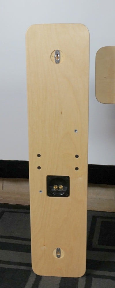

465 internals   Kallos 465 rear
The enclosure is made from stacked Baltic birch and has a lot of bracing and reinforcement around the driver mountings. It is a very strongly built cabinet and has a real feel of solidity. The interior is densely packed with fiberglass stuffing. The ‘knock test’ feels like rapping on a boulder. The cabinet has keyhole slots as well as a 100mm X 100mm VESA mount. If it can be accommodated, the VESA mount is a better way to install the speaker. I think a French Cleat hanging system would have been a good addition too, and easier to mount than the keyhole slots. The speaker connects to the wire with a standard 5-way binding post in a terminal cup. One change JTR might think about is making a groove leading from the binding posts in the back of the speaker, where wire can be threaded; that way, the speaker can be mounted flush against a wall.

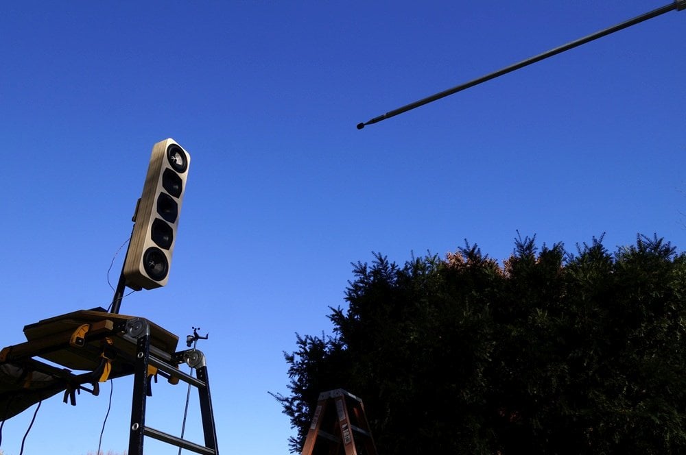

JTR Kallos 465 Measurement and Analysis
Kallos 465 outdoor testing4

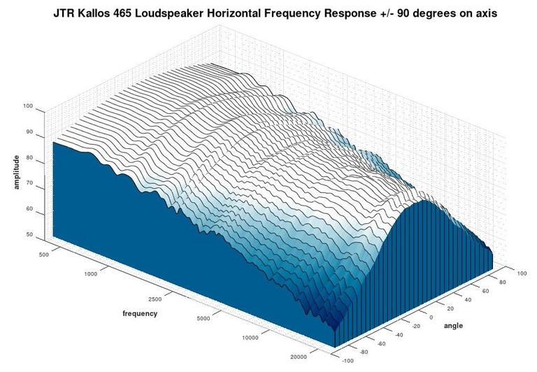

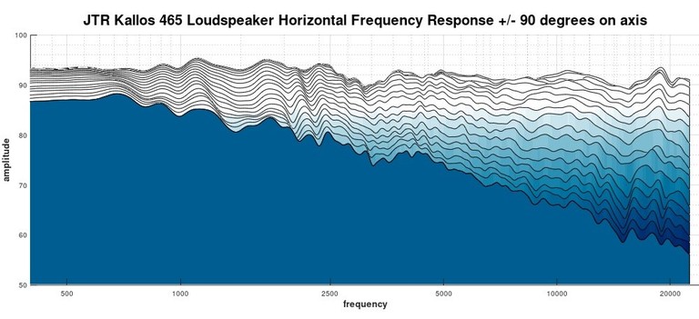

The JTR Kallos 465 was measured in free-air at a height of 4 feet at a 2-meter distance from the microphone, with the microphone raised to an 8’ elevation that was level with and aimed at the tweeter center. The measurements were gated at 8 milliseconds. In this time window, some resolution is lost below 400 Hz, and accuracy is completely lost below 200 Hz. Measurements have been smoothed at a 1/24 octave resolution.

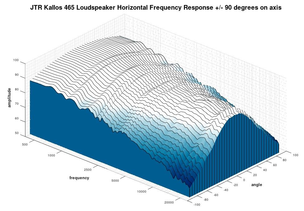

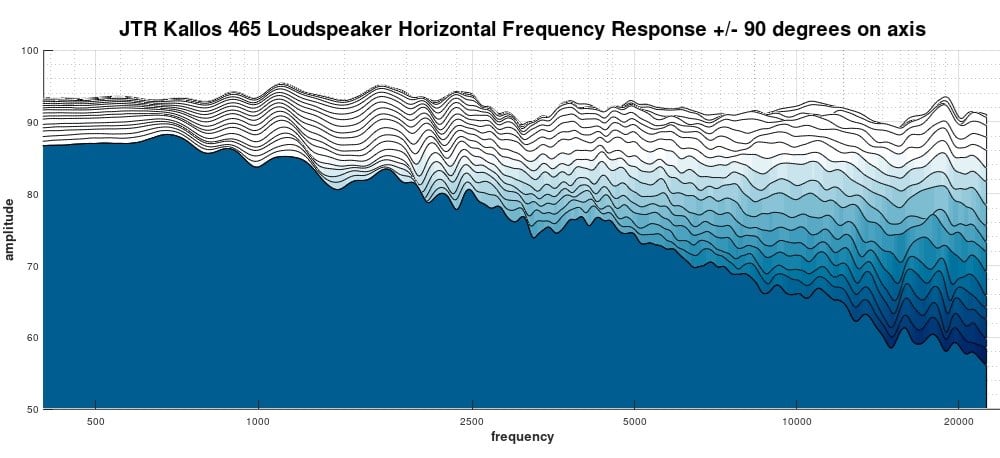

465 3D Waterfall response
465 2D Waterfall response

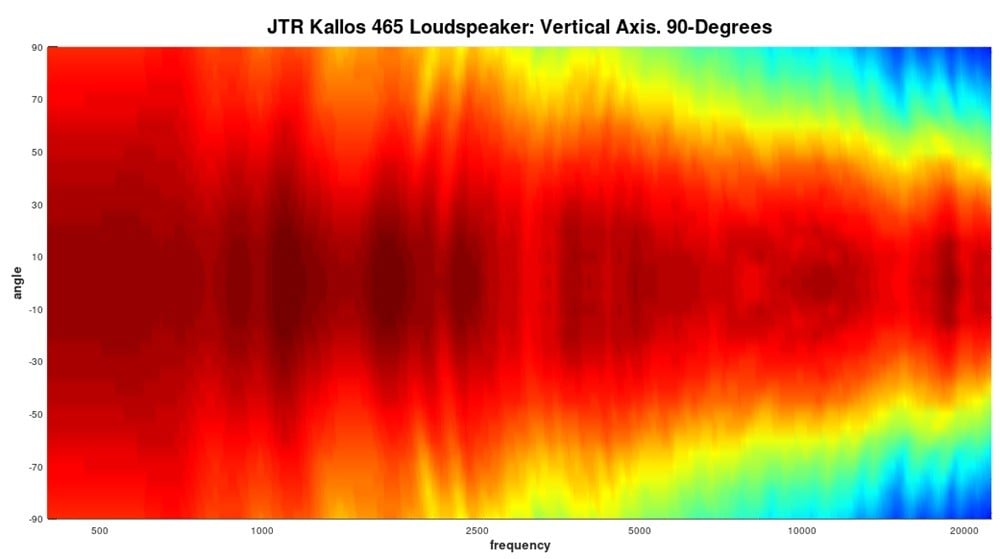

The above graphs depict the Kallos 465’s direct-axis and horizontal dispersion out to a 90-degree angle in five-degree increments. Information on how to interpret these graphs can be read in this article: Understanding Loudspeaker Review Measurements Part II.
The above response exhibited by the Kallos 465 is very good, on the whole. It maintains a fairly flat response with some slight imperfections, but is mostly an accurate loudspeaker. The most obvious flaw is a slight dip centered around 3kHz. It takes out a couple of decibels at a region where human hearing is most sensitive; however, it is not a very wide recession, so I don’t think it will be very audible. The range below the dip seems to have a slightly higher elevation on the response than the range above, and I do think this will lightly color the sound, giving it a slightly warmer signature than a totally neutral loudspeaker. Personally, I didn’t find the Kallos 465 to be a warm speaker in my own listening, and I didn’t notice any coloration like this. I like warm-sounding speakers, and since I didn’t get a sense of warmth from the 465s, I don’t think this elevation in the response is enough to put a particular signature on the sound. Something to note about the above graphs is just how well-controlled the tweeter is. Many horn-loaded tweeters do not have such a nicely balanced response, but the BMS tweeter used by JTR is an excellent one.

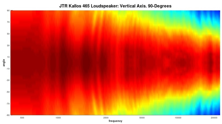

465 Polar Map
The above polar map shows the same information as the preceding graphs but depicts it in a way that can offer new insight regarding these speakers’ behavior. Instead of using individual raised lines to illustrate amplitude, polar maps use color to portray amplitude, and this allows the use of a purely angle/frequency axis perspective. The advantage of these graphs is that they can let us see broader trends of the speaker’s dispersion behavior more easily. More information about interpreting this graph can be read in this article: Understanding Loudspeaker Measurements Part II.
The above response is a great example of controlled directivity from the Kallos 465 speakers. This speaker does not have a small ‘sweet spot,’ but rather holds an even tonal balance over the breadth of its dispersion. The dispersion narrows as frequencies increase, but only gradually, and there are no odd directivity errors or regions of misbehavior. This speaker is not a wide-dispersion speaker, but it isn’t as narrow in dispersion as other larger horn-loaded loudspeakers. The waveguide used is simply too small for a really tight dispersion, as well as the size of the midrange driver. What this all adds up to is a speaker that will behave predictably in any normal room. The listening room won’t need any special acoustic treatment to address anything from the speaker itself, and any equalization that is applied should yield an expected response. This type of response lessens the need for equalization, but at the same time, it will make any equalization more effectively used, especially sophisticated auto-EQ systems like Audyssey or Dirac.

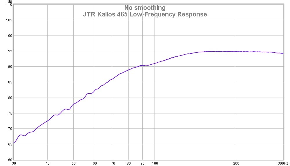

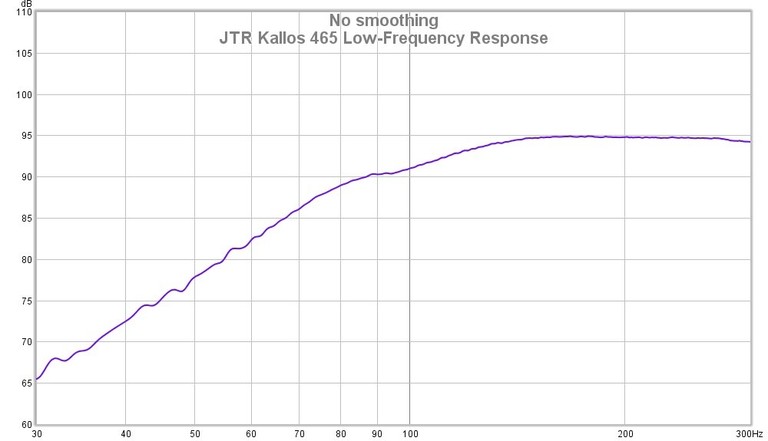

465 bass response
The above graph shows the Kallos 465’s low-frequency responses captured using ground plane measurements (where the speaker and microphone are on the ground at a 2-meter distance in a wide-open area). Here, we see the need for a subwoofer for these speakers. Below 80Hz, it starts to roll off the response fairly rapidly, and that is about what one would expect given the design. Having passive radiators in a small enclosure is not a recipe for deep bass. Rather than extending the response, the radiators are likely just taking a load off the lower end of the midrange driver’s bandwidth, thereby alleviating distortion that comes from the higher excursion requirements of lower bass. The good news in this graph is that the bass response is fairly smooth and linear. There are no surprises in this graph, and that is a good thing.
More of a load can be taken off the woofers with a higher crossover frequency, and this will increase the dynamic range as well, so if you want the Kallos 465 speakers to hit even harder, use a 100Hz or 120Hz crossover frequency. However, a multi-sub setup is really needed for this, at least to avoid bass localization to a single sub’s position. The curve of this low-frequency response suggests a slightly higher than the traditional 80Hz crossover frequency may be optimal.

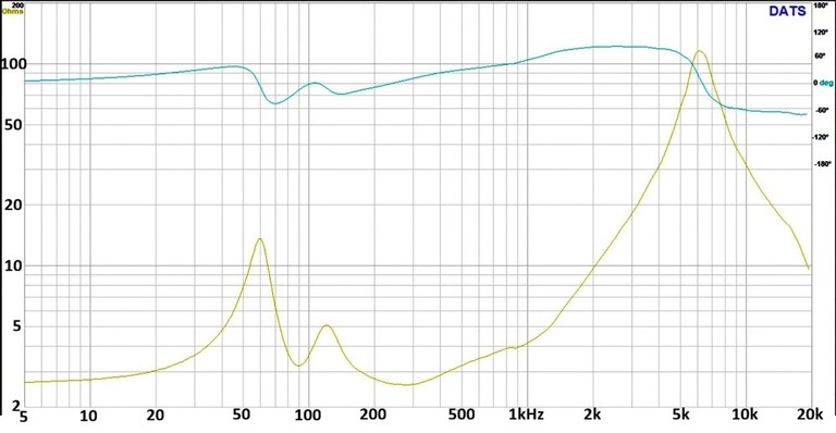

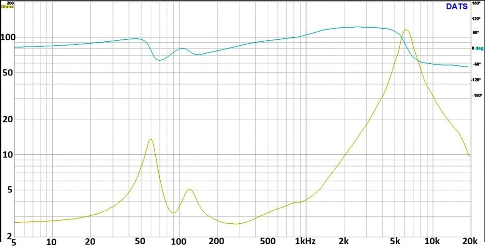

456 imp labeled
The above graph shows the electrical behavior of the Kallos 465s. These speakers are not the easiest electrical load for amplifiers. The impedance minima approach 3 ohms at around 300Hz. A 4 ohm stable amplifier is certainly a requirement for the 465s. The good news is that since the sensitivity is higher than average, the amplifier gain will not have to be jacked up to get these speakers loud, thereby giving the amp a break. The phase angle is not especially steep in that frequency band either. So while the speakers will want a decent amplifier, users will not need a super amp to run the Kallos 465s. I don’t think this will ever be a problem since I doubt anyone will attempt to run these $2.5k/each speakers with a budget amp. Something else to note here is that we can see the passive radiator tuning frequency looks to be 90Hz from the low point of the saddle dip in the lower end of the response.
I measured the 465’s sensitivity to be 96.6dB for 1 meter at 2.83V. This is very close to JTR’s own spec of 97dB for 1 meter at 2.83dB. That has to make these some of the most sensitive on-wall speakers around. But this measurement doesn’t even factor in the additional gain that a half-space placement will net, so the reality is that the Kallos 465 speakers will see a higher sensitivity than their spec in practice. These speakers don’t need a high-power amp to get loud, although they can certainly handle more wattage than typical on-wall speakers for those who like extreme dynamics.
