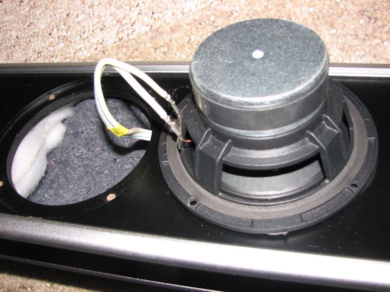

Constructed from extruded aluminum, these speakers convey serious enclosure quality. I am a big fan of these cabinet types as they not only look great, but often offer superior control of cabinet resonance compared to conventional MDF designs. Tapping on the cabinet revels a consistently dead sound throughout. In fact, I peered inside the cabinet by removing the grill and popping out one of the drivers. I was pleased to find the cabinet was well insulated and EMP spared no expense at using real cast drivers instead of cheap stamped baskets like so many competitor products tend to do to cut corners. The carbon fiber woofers are basically treated paper similar to drivers I’ve seen from a reputable companies such as Peerless. The tweeter is a 1” silk dome with a conventional motor structure. Note that these speakers are not magnetically shielded but it shouldn’t present a problem unless you are using them in close proximity to a CRT based display or anything with a hard drive (keep them away from your DVR). In that case, I suggest some good old 1970’s big box Lafayette specials.

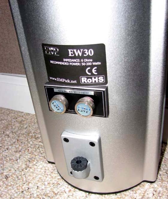

The backside of the EW30s sport hefty mounting plates top and bottom and silver terminal nuts which you must unscrew to push the speaker wire through. They dressed the speaker up nicely but extra care must be taken to observe polarity since it's marked behind the terminal cap and not clearly visible on the speaker cabinet itself. Upon first glance, I almost missed it. It would have been good measure for EMP to include color coded terminal caps to match the color polarity on the threaded connectors mounted on the back casing.

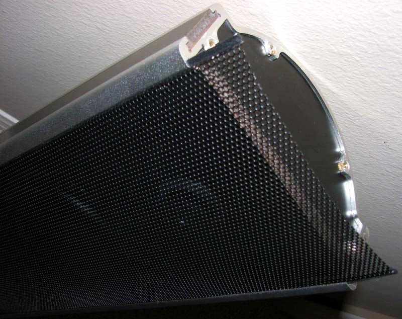

Before installing the EW30s you must first consider a couple of things such as your preference for grill cover color, the location you wish to mount them, and by what method. The EW30s come preinstalled with the black grills but they provide you the optional gray grill cover to better match your plasma display should the casing be non black such as the older Panasonics. Taking off the grill cover was much easier than replacing it. You start by removing the 4 hex screws on the top and bottom panels of the speaker. Then you gently flex the grill while lifting it out on one end and slowly following through to the other. Next replace the grill with the optional silver one, carefully ensuring it is centered before replacing the top and bottom panels of the speakers. The manual recommends you insert one side into the grill track and then gently bend the other one to fit it in place. Of course I couldn’t accomplish that in one or two tries so thinking I was clever, I slid the grill in from one side which was going fairly easy until I reached the halfway point and noticed rubber shavings on one side. At that point, not even my kung fu grip could pry it lose. I was committed to stay the course realizing once I did get the grill cover back on, it would never be a “removable” grill cover again. Luckily I stuck with the black cover which is what I wanted and began muscling the cover to get it in place. That lasted a good 3 or 4 seconds as I reached for the rubber mallet to get the job done. This was an experience I don’t want to repeat and I strongly encourage you to either follow the guidelines in the manual or leave well enough alone. Just because you can change out the grill cover doesn’t necessarily follow that you must change it out.

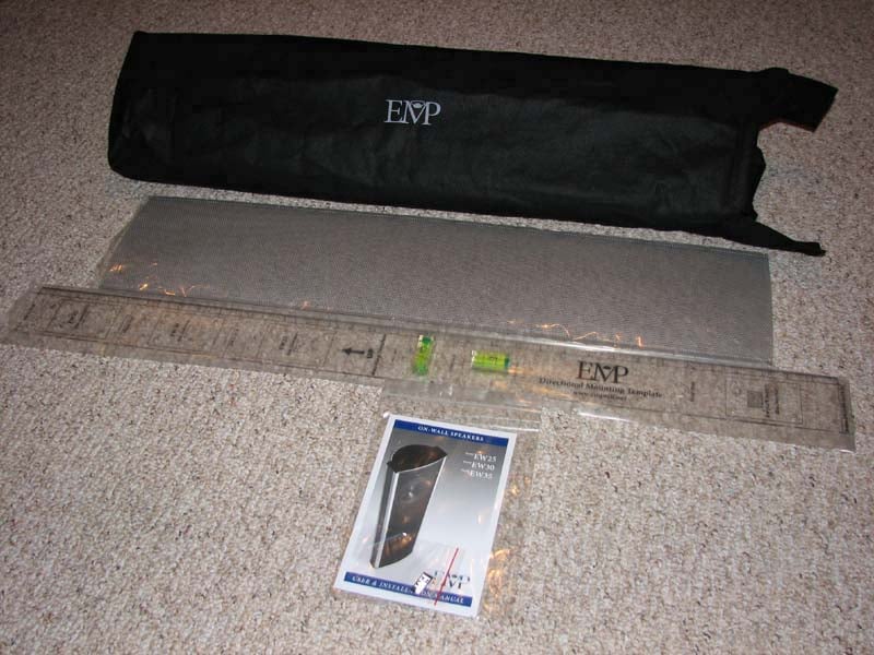

The EW30s come complete with a Directional Mounting Template (DMT) to determine and mark your desired speaker location. It features a bubble type leveling system to help out guys like me that can’t eyeball it or draw a straight line with a ruler. The manual stresses that the installer utilizes the centering cross hair marks on the template if you are installing the EW30s and not the marks for the EW25’s or 35’s. Based on my recent debacle with the grills, I’d suggest following the manual guidelines very closely. After you mark off the four mounting holes with a pencil for the upper and lower brackets, you must decide on the method of mounting them. If you are driving into studs, then use the supplied screws. If you are driving into drywall that you need to use the supplied drywall anchors to support the heft of these speakers. Pay careful attention to the bite direction when installing the wall brackets. Next connect the speaker wire to the speakers (note polarity). Finally, follow the mounting directions in the manual and ensure you properly tighten the hex nuts until the speaker can no longer pivot. Be very careful to ensure you have a solid installation as you don’t want these metal monsters crashing down on an end table, or worse a loved one or pet.

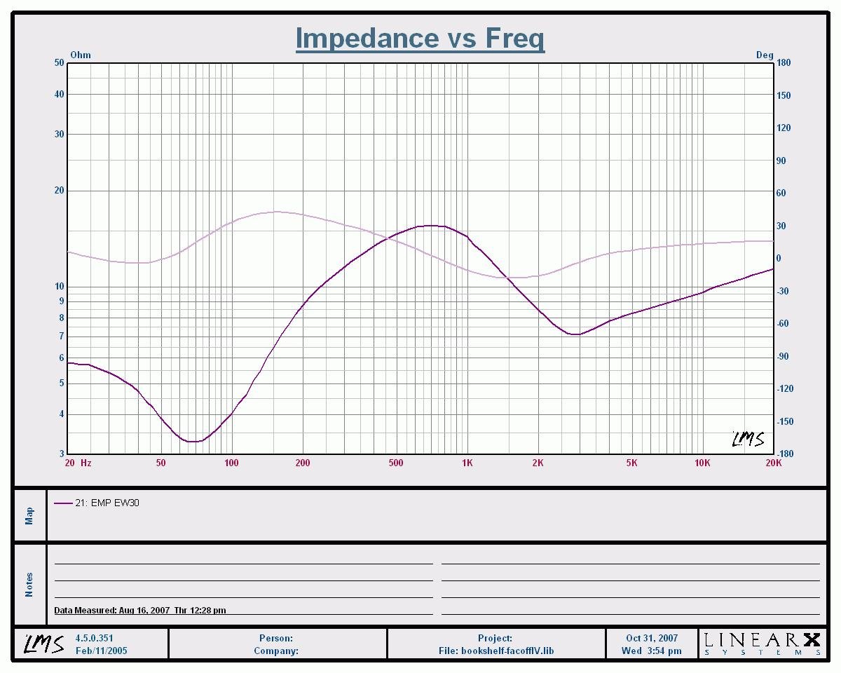

Impedance / Phase Measurements of the EW30
I was surprised to see the system impedance dip to 3.5 ohms from 50-100Hz which in my opinion is more reason to bass manage these speakers to remove the strain from the amplifier and let the more capable subwoofer produce the bass. The EW30s exhibit a relatively benign phase response of well under +- 30 degrees throughout the entire audio band indicating some good thought was applied to ensure these speakers would consistently sound good no matter what amplifier they were being played on.

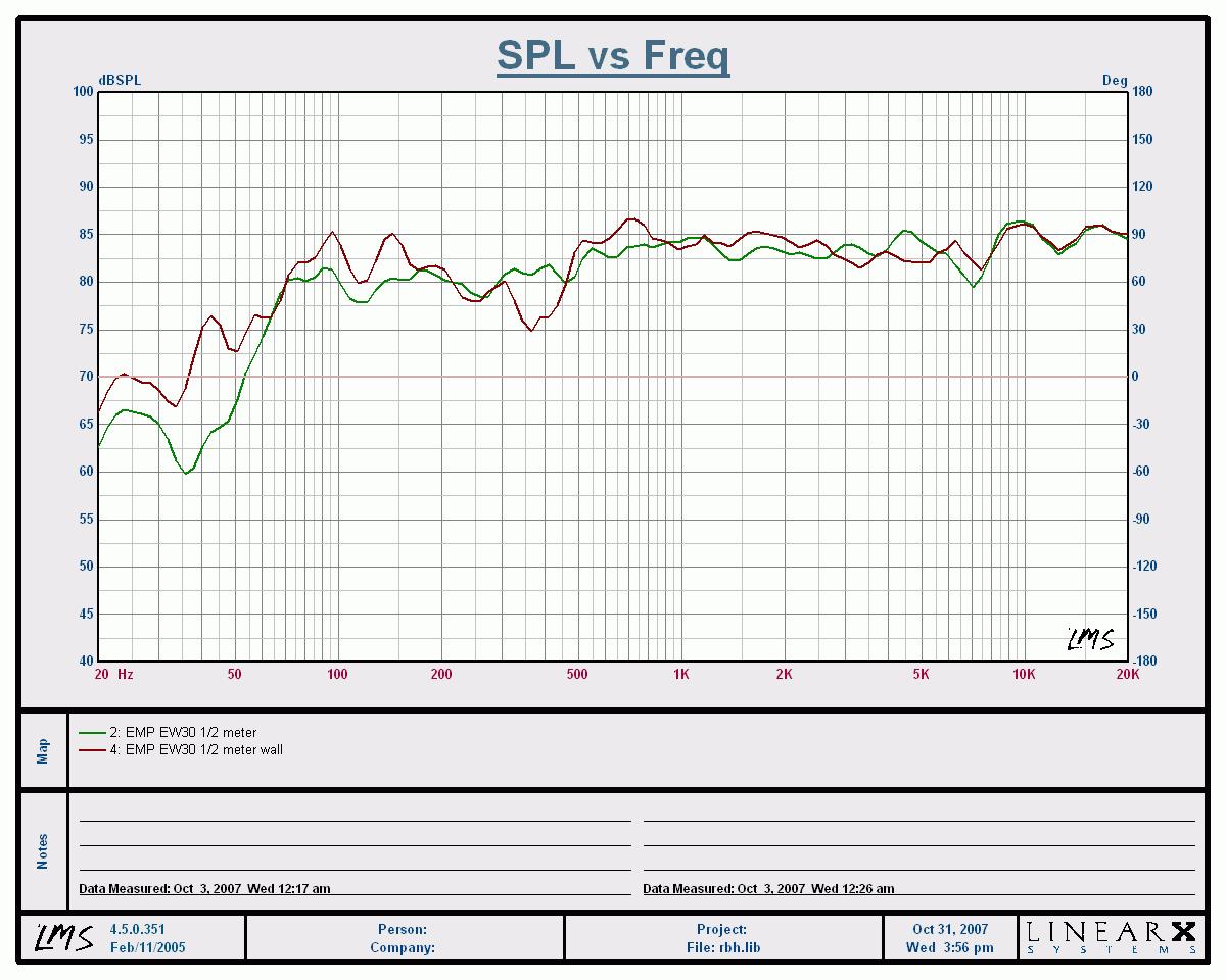

In Room ½ Meter
Frequency Response (1/12th octave smoothed)
Green – off wall, Brown
– on wall
Above
500Hz, these speakers are surprisingly very linear maintaining a +-3dB in room
frequency response. Below 500Hz there
seemed to be a slight tapering off of bass which may indicate why I felt they
lacked a bit of upper bass punch.
Placing them against the wall (their intended designed placement)
boosted the bass response significantly due to boundary gain as indicated in
the measurements below 150Hz. These speakers were designed to be placed against a wall and thus incidentally measure most linear and sound their best when placed as such.
