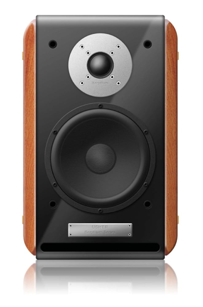

Usher Audio speakers and electronics are built for the experienced listener who won't compromise on sound quality even at moderate prices. The spectacular stand-mounted Be-718s--the Tiny Dancers with Huge Presence--features Ushers’ own 1.5-inch Be beryllium dome tweeters and carbon-impregnated paper-cone midbass drivers.
The Be-718s effortlessly fill even medium-large rooms with impressive musical dynamics; the integration, speed and clarity of its drivers are exceptional. Expansive, quick upper frequencies are redolent with harmonics for rendering female vocals or the quick shimmer of brass. A fast, open and seductive midrange caps deep, taut, powerful and tuneful bass.
Our beautifully engineered Be tweeters uncover low-level details usually lost in the noise floor of less resolving speakers. The esteemed Dr. Joseph D’Appolito serves as Usher’s technical consultant, providing guidance in crossover design. The result is suave, elegantly powerful, transparent sound from beautifully-crafted and lustrously-finished cabinets at very affordable real-world prices.
The Be-718s, like all Usher speakers, are produced with skill and pride in an ultra-modern factory in Taiwan with great attention to manufacturing efficiency and productivity, turning out beautifully-crafted speaker systems incorporating advanced technologies like the Be beryllium midrange drivers found in the floorstanding Dancer Be-10 and Be-20 along with our superbly-engineered beryllium tweeters.
Take The Usher Challenge! Audition The Be-718s And Just Try To Convince Yourself They’re Only About $2,500/pr!
