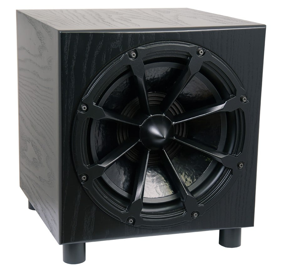

MJ dual 10 subCompared to most subwoofers, MJ subs are designed to work a bit differently. From the way you connect them into your system to the way their crossovers work, MJ subs are a little unusual. But if you are familiar with REL subs, much of what I will describe here might sound familiar, as both outfits espouse some of the same core philosophies that inform their design choices. (Indeed, I read in an online forum that MJ Acoustics was originally started up by a faction of ex-REL employees who wanted to go out on their own, but I was not able to confirm this claim in my own research.) Like most REL subs, MJ subwoofers are designed to operate seamlessly below the primary frequency response of the main speakers, which should be left to run full-range, rather than high-passed. I should point out that this arrangement is counter to what we usually recommend at Audioholics — there are definite benefits to high-passing your main speakers in many situations. But there are many paths to great sound, and anecdotally, I should also point out that I have heard many superb-sounding 2-channel systems that used REL subs alongside speakers running full-range. Care should always be taken to ensure your speakers can handle full range bass without causing overload or damage at the levels you like to listen at.
Another difference from most modern subwoofers — and another similarity to RELs — is that MJ Acoustics subs eschew DSP completely, relying instead on “meticulously-engineered analogue audio filter circuits.” The subs offer precise gain and crossover controls for “flawless integration,” according to the brand, including crossover adjustment in 1Hz increments down to 20Hz, and gain control in 1dB steps, allowing for a “more natural and accurate system blend to deliver true-to-source bass response for both music and cinematic applications.” MJ Acoustics believes that the use of DSP is tantamount to distorting the source signal, and is “not an option for a true audiophile setup,” which involves a pure conversion of electrical signal to cone motion to moving air. Again, we at Audioholics have found that the use of DSP can offer a number of worthwhile advantages, but we have also heard great bass from subs that do not use DSP.

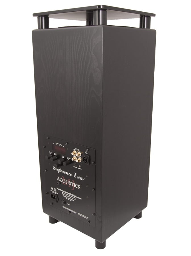

Most subwoofers are connected to a preamp or processor via RCA or XLR cable, whether for home theater or 2-channel duty. MJ Acoustics has a different approach. While the LFE signal for home theater can be connected this way, for 2-channel audio the brand recommends using a high-level cable to directly connect the output of your power amp to the sub’s built-in Neutrik Speakon connector input. (Again, this arrangement will be familiar to REL users.) The subs have a variable crossover filter unique to MJ, called the DAMP 3rd Gen Active Bass Crossover. It is an active circuit with its own buffered, high-impedance input, meaning it won’t have any effect on your power amp(s), according to MJ Acoustics. The company claims that there are many benefits to this approach. Firstly, it reportedly allows the subs to work in any size room with virtually any speakers. It is also said to better preserve the imaging characteristics of the main speakers, and can actually improve imaging and soundstage depth, according to MJ.

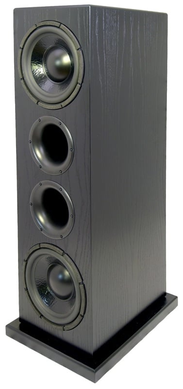

MJ Acoustics drivers are all designed in-house to reproduce low bass transients, with resonant frequencies that are exceptionally low, according to the company. Woven patterns and impregnated long-travel suspensions are used, resulting in high output for the ideal motor assembly elements, according to MJ. The drivers — or “bass engines,” as MJ refers to them — are reportedly designed to start and stop quickly. “It is the pauses in between notes that define the rhythm of music agility and audiophile reproduction,” says the brand’s literature. The drivers only sound as good as the crossover circuits that come before them in the signal chain, of course, and MJ uses twin independent crossovers, allowing for separate adjustments to LFE effects and the main-speaker bass signal working in tandem with the main speakers. MJ Acoustics says it’s like having two subwoofers in each cabinet. (Most REL subwoofers also offer this, although the brand’s Serie HT models, designed for home theater use, only have a single LFE input. See James Larson’s REL Acoustics HT/1510 Predator II Sealed Subwoofer Review.) Crossover points as low as 20Hz can be set. “Our designs produce truly deep bass, whereas many of our competitors settle on loud middle bass,” says MJ Acoustics.
A second-order variable low-pass filter making use of a combination Butterworth and Bessel functions (was) chosen for the most linear phase response. There are absolutely no group delays in the signal path. An additional fixed second-order Bessel filter follows the variable filter, removing unwanted midrange signals that, if left unfiltered, cause midrange colouration of the main speakers. All filtering is performed in the analogue domain using high-quality, matched components with tight tolerances to ensure the highest possible performance. In the case of Reference and Master-Class Series, we hand pick and performance measure the specs for each component in the circuit. This is a time-consuming process but provides for the very tightest of tolerances and superior performance that is consistent from product to product. When adding multiple Sub-Bass Systems to your setup it is important to be confident in the consistent nature of the filter circuits.

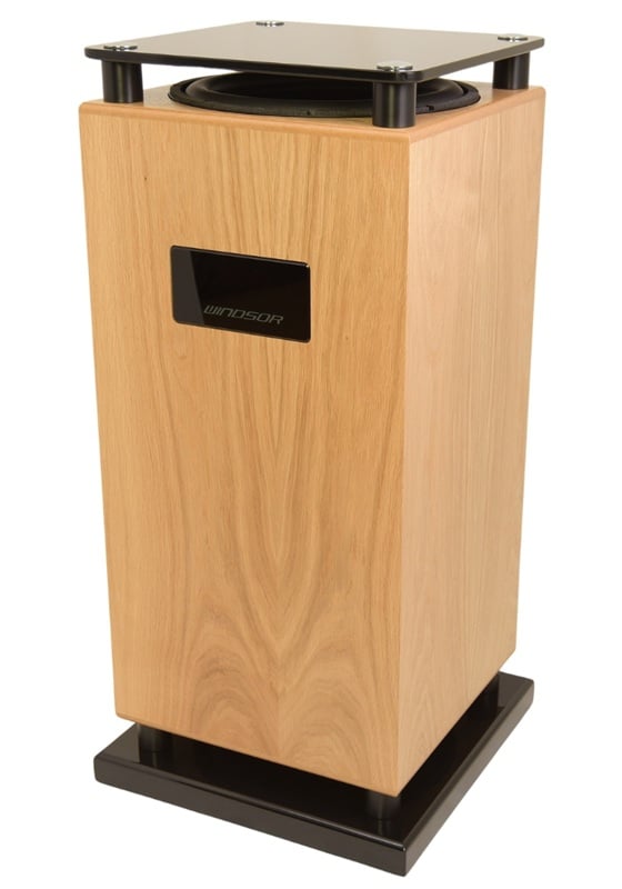

MJ Acoustics Windsor subMJ Reference 1 Mk IV
Unlike some brands, MJ Acoustics doesn’t boast about kilowatt amplifiers, choosing instead to focus on “the perfect combination of low moving mass and strength in our bass drivers, resulting in the overall design being more electro-mechanically efficient.” Thanks to this higher efficiency, the subs do not require massive amounts of power. In addition to reducing the carbon footprint of your audio setup, these subs benefit from “a faster moving cone assembly, which gives us the speed and agility to match the finest audiophile speakers,” according to MJ Acoustics. The cabinets, made from “the highest-grade European-sourced MDF,” are custom-designed for acoustical performance and finished with either wood veneers or “the very same lacquers that are used on the most expensive and highest-quality furniture and automobile interiors,” according to the company.
