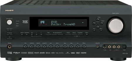

UPPER SADDLE RIVER, NJ (7/31/07) -- Integra, the leading manufacturer of home theater components designed specifically for the custom installer, has introduced the THX Ultra2 Certified DTC-9.8, an exceptionally versatile audio-video preamplifier / processor designed to meet the complex needs of system integrators and custom installers while providing state-of-the-art features and performance for the home theater enthusiast. This three-zone processor features HDMI v. 1.3a switching, HQV Reon-VX video processing, complete 7.1-channel processing including onboard decoding for lossless and HD audio formats, and an extensive suite of multizone/multisource and system integration control features all at a suggested retail price of just $1,600.
"With processing and switching capabilities that allow installers to squeeze every possible bit of performance out of the latest HD audio and video sources, this will be a market-leading component," said Integra Director of Sales Keith Haas. "Add to that a remarkable combination of integration options, including Ethernet-based control compatibility and three-zone A/V distribution, and we believe there is nothing anywhere near this price point that can compete with the DTC-9.8."

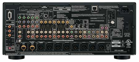

Featuring four HDMI inputs and two outputs, the DTC-9.8 is a flexible centerpiece for even the largest high-end home theater installations. It is fully compatible with HDMI v. 1.3a, including 1080p and Deep Color™ 36-bit video signals. Additionally, the controller includes the acclaimed Silicon Optix HQV Reon-VX onboard video processing, capable of scaling and transcoding all video source material to 1080p output over HDMI.
The DTC-9.8 features 7.1-channel professional-grade balanced XLR outputs for connection to compatible multichannel amplifiers. Three advanced TI™ 32-bit DSP chips provide all audio processing. There is onboard decoding for nearly every major format in use today, including the latest high definition and lossless audio formats specified for HD-DVD and Blu-Ray disc formats. The unit features an oversized Toroidal transformer for the main power supply as well as separate transformers for the audio and video circuitry. Each channel also employs premium quality Burr Brown audio DAC's and Integra's VLSC (Vector Linear Shaping Circuitry) for dynamic, low-distortion reproduction at all output levels.
The Integra DTC-9.8 includes a comprehensive package of features specifically tailored to the needs of custom installers, including an Ethernet port for integration with network-based control systems such as AMX Device Discovery and Crestron E-Control. It also includes bi-directional RS-232, RIHD (Remote Interactive over HDMI) system control integration over HDMI, three programmable 12-volt triggers, dual IR inputs, and three unique assignable IR code sets. Lockable customized dealer settings can be independently stored for easy recall, making it simple for installers to maintain complex installations.

AUDIO
PROCESSING:
• THX Ultra2 Certified
• Toroidal Transformer Plus 2
Separate Power Transformers for Audio & Video Processing
• HDMI (v.1.3a)
• Audyssey MultiEQ XT Advanced Room
Correction
• DTS-HD Master Audio, DTS-HD High-Resolution Audio, Dolby TrueHD,
Dolby Digital Plus Decoding
• Burr Brown 192khz/24-bit DACs for all
channels
• Neural THX Surround Processing
• Three Advanced TI 32-Bit
Processing DSP Chips
• Linear Optimum Gain Volume Circuitry
• VLSC -
Vector Linear Shaping Circuitry - All Channels
• Bi-Amp Capability for Front
L/R Channels
• IntelliVolume Input Level Calibration System
• 15-band
Graphic Equalizer
• Variable Crossover Settings by Channel Pair
• Accurate
Speaker Distance Settings (0.2 ft increments)
• A/V Sync Delay Adjustment by
Input (up to 250ms)
VIDEO
PROCESSING:
• HQV Reon-VX Processing for Premium Quality HDMI
Upscaling/Transcoding of All Sources (up to 1080p)
•Deep Color™ (36 bit)
Capable HDMI (4-in/2-out)
• HD Component Video (100 MHz)
w/Upconversion
CONNECTIONS:
• 7.1 Channel Balanced Line Level XLR
Outputs
• 2 Channel Balanced XLR Audio Input (assignable)
• 7.1
Multichannel Input & Pre-output
• XM® & SIRIUS Satellite Radio Ready
[Required XM or SIRIUS tuner, antenna, and subscription sold separately.]
HD Radio Reception Capability
• Assignable Digital Inputs (4 HDMI/3 optical/3
coaxial)
• HDMI/Component Video Assignable to Tape/CD/Phono
• 1 Optical
Digital Output
• Front Panel A/V Inputs (including optical)
