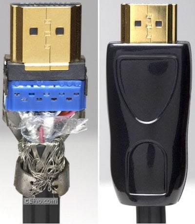

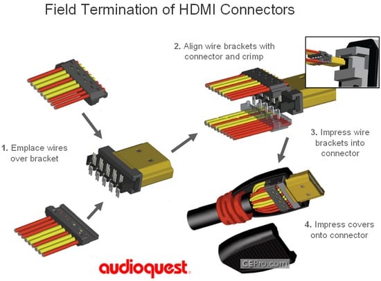

According to an article in CE Pro online, AudioQuest has announced a way to field terminate HDMI cables. This is a first as far as we can tell, and means that installers will soon be able to pull raw cable through the wall and terminate it to exact lengths. The company invented a connector, appropriately named "Bayonet" which utilizes V pins that cut through the wire insulation and trim the excess wire in one action of the proprietary crimping tool. A cable tester will be provided by the company to test the cables following the HDMI field termination.
