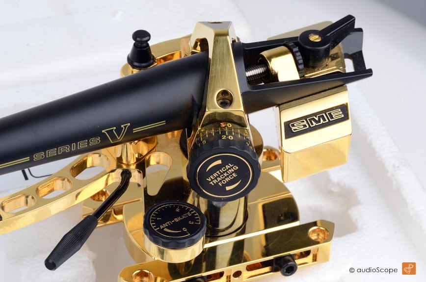

tone-armPossibly the most overlooked area of assembling a turntable/cartridge system is matching the cartridge to the tonearm. Two properties must be matched; the compliance of the cartridge and the effective mass of the tonearm. The “compliance” of the cartridge refers to the ease of deflection of the cantilever, which is the miniature tube that holds the stylus; the needle. It’s the thing that you accidentally bend or break through abject carelessness, and then you curse loudly and your dog hides under the bed. At least mine does.
The “effective mass” of the tonearm is determined by the weight of the tonearm from the pivot to the end of the arm. More mass moved farther from the pivot increases effective mass. Some turntables and all separate tonearms publish an effective mass number, which is good because few of us would be able to figure it out on our own. Including, especially, me. Seriously, you can find articles online that go into this in painful detail; articles penned by folks who know a great deal about the physics of turntables, arms, and cartridges.
If you look up a particular cartridge’s compliance, you’ll see what appears to be a cryptic formula. Ignore it, other than the first two digit number. (Example: 20 x 10-6 cm/dyne.) A low-compliance cartridge will have a number below 11 or 12. A moderate compliance cartridge will fall between 13-18; and a high compliance cartridge will be in the neighborhood of 20-25. This number of the compliance has nothing at all to do with quality, but the compliance has to match the tonearm. The general rule is “high compliance cartridge, low mass tonearm,” and “low compliance cartridge, high mass tonearm.”
The combined resonant frequency of the tonearm, cartridge, mounting hardware, etc. should fall within the 8 Hz-12 Hz range. If it’s lower than that (high mass arm with a high compliance cartridge) record warp and foot stomps will cause your woofers to move uncontrollably. Conversely, if the resonant frequency is too high (15 Hz-20 Hz range) music, warp, record noise, etc. in the lowest of audible ranges will resonate with the arm/cartridge, also causing huge speaker excursions. If a note coincides with an audible tonearm/cartridge resonance the cartridge can mistrack or at the very least, you’ll hear an exaggerated boom in the bass.
The best ways to avoid poor cartridge/tonearm mating are either to buy a turntable with the appropriate cartridge pre-mounted and balanced, or refer to an online chart such as this one to guide you in matching an appropriate cartridge to the arm:
http://www.resfreq.com/resonancecalculator.html
The tonearm will limit you to a range of choices, and you can’t go beyond that range and expect good results.

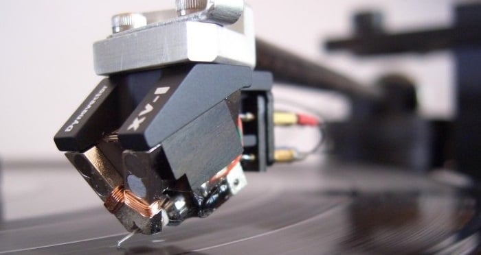

There are two basic types of good cartridges; moving coil and moving magnet. You may have heard of ceramic cartridges, but they are to be avoided because they’re antiquated, crappy, they’ll destroy your records, and they won’t work in magnetic phono inputs. But, other than that…
If you can recall Faraday’s Law of Induction, movement within an assembly that includes a permanent magnet and a coil will induce voltage in the coil. When playing a record, the stylus moves in concert with the undulations of the record groove, and that moves the cantilever, which is connected to either a magnet or a coil. To induce that voltage in a moving coil cartridge, the magnet is stationary and the coil moves. In a moving magnet cartridge, the coil is stationary and the magnet moves. Neither design is inherently better; just different. A moving coil cartridge almost always has lower output due to the desirability of lower mass of the coil and the resulting lower output. Almost all MC cartridges require a “head amp,” separate phono preamp, or step-up device because they don’t provide enough juice to properly drive the phono input in your preamp or receiver. Some audiophiles justify the lower output, slightly higher noise, and added cost of another component because moving coil cartridges are known for extraordinarily detailed and articulate treble.
Most cartridges, however, are higher-output moving magnet designs. MM cartridges are usually higher in compliance, and they work better in lower-mass tonearms. MC cartridges can keep the important resonant frequency between 8 Hz-12 Hz only in higher-mass arms. If you are at all confused, see a local specialty dealer (if you’re fortunate enough to still have one), or refer to the link posted above. There’s no need to dial in the arm and cartridge to perfection, though. Getting close is usually just fine.

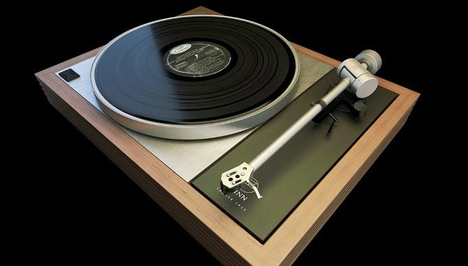

Linn Sondek LP-12
Which turntable to get?

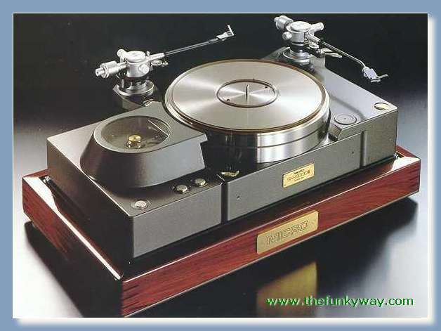

There are many vintage used turntables available, some with old cartridges. If you don’t mind installing and calibrating a new cartridge, that might be your best bet. An old Linn Sondek LP-12 can be made to sound exquisite, but they are somewhat difficult to set up properly. One safe bet is a vintage B&O turntable with a conventional radial (pivoting) arm. The B&O arms were extremely low mass, and the cartridges were very high compliance, (as high as 35 x 10-6 cm/dyne) and the combined resonance was known; around 14 Hz. They also offered amazing isolation from bass. The B&O cartridges sounded very natural and even somewhat dull and unexciting to some listeners. One might also look at vintage Thorens (TD-125 and later), Oracle, Dual, Phillips, or one of those massive DD ‘tables from the Japanese companies. Any old Micro Seiki; direct-drive or belt; would be a great choice.

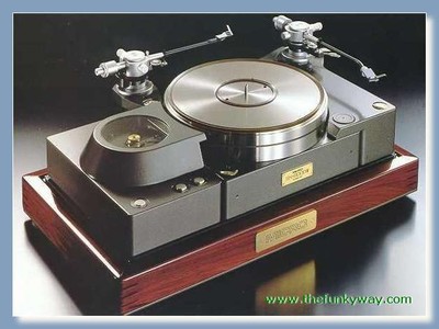

Micro Seiki SX-8000 II

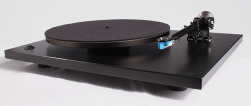

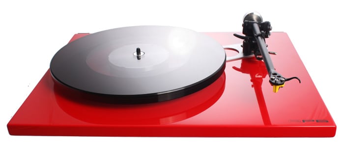

It’s encouraging to see a new wave of reasonably-priced and very good audiophile turntables from Rega, Music Hall, Pro-Ject, and others. They’re superior to entry-level turntables of the ‘70s and ‘80s in most cases.
Rega RP6 (left) and Rega RP3 (right)
