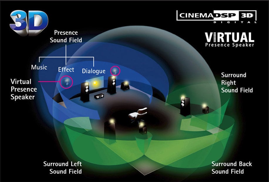

Do your speakers sound like they are in a tunnel, cave, bathroom, auditorium, or a similar location? If so, chances are that you have some type of DSP, or Digital Signal Processing, going on in your system. AV receiver manufacturers often include a number of different DSPs that are supposed to recreate the sound of a particular venue, but these modes can be distracting. Yamaha tends to be the king of DSPs, with options like Hall in Munich, Hall in Vienna, and The Roxy Theater. Their current flagship receiver, the RX-A3020, actually boasts a total of 23 different DSP programs (and that doesn't include the myriad of permutations, settings, and options you can apply to those base DSP modes)!
We have found that most DSP programs that recreate a type of venue can produce undesirable results, especially in already live (reflective) rooms. However, other post processing DSPs, like Dolby ProLogic IIx or Mono Movie, can be quite helpful. The key is to play around with the different sound modes and understand their limitations and how they can enhance your listening experience. Luckily, most receiver manuals have a detailed breakdown of at least the basics of what each DSP mode does.
