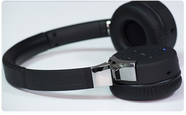

Frankly, the headphone design is ho-hum to us but if the sound is good enough, we don't care.
XTZ promises a lot with their Headphone Divine solution. The headphones are on-ear, the earcups can be folded inward for easy transportation, and they are Bluetooth enabled. Supporting aptX, the Headphone Divine can accept CD-quality sound wirelessly. While there is no battery indicator, XTZ suggests the expected battery life will be around 14 hours. In addition, the Headphone Divine comes with a detachable cable for wired use. XTZ says that you can charge the headphones while using the cable though, in our experience doing so usually introduces noise into the system.

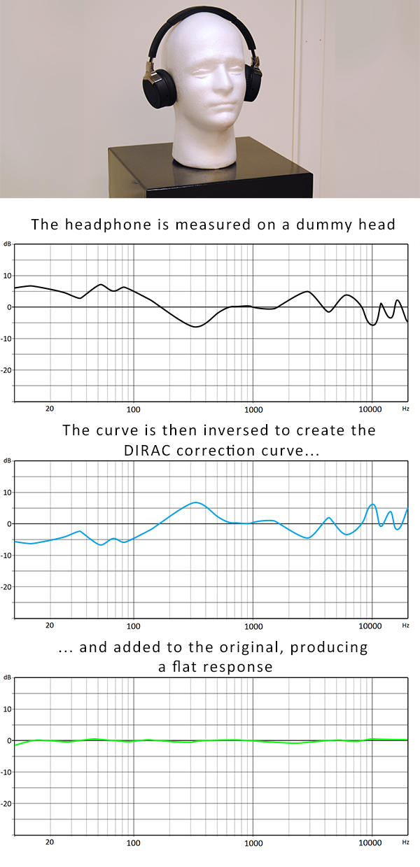

XTZ has paired with Dirac to create a player that can be downloaded from the Apple or Android App store. Through this player, the Dirac DSP correction can be applied to the headphones. Dirac is well known to us as we reviewed their app for the Apple earbuds a while back and were impressed with the results. We fully expect that the Dirac processing will improve the sound of the XTZ Headphone Divine.
devine_correction
Now the question is if you actually want a flat response - some research suggests you don't.
On top of that, XTZ has a few DSP curve modifications available. At the touch of a button, you can modify the DSP to increase or decrease the bass and/or treble to predetermined amounts. According to the website, these curves are fixed and there doesn't, at this time, seem to be plans for user control.
