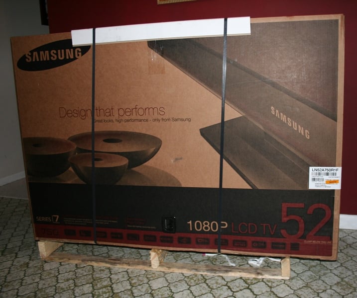

The Samsung LN52A750 arrived
as displays always do these days - in a tall, thin box strapped to a half
pallet. In all honesty, I can't believe that more of these displays aren't
damaged in transit. The standard packaging that everyone seems to use just
seems a bit inadequate to me. But, after doing so many reviews of displays, I
have to admit that it must be working as I've seen damaged boxes but no damaged
displays.

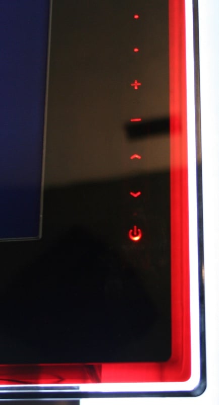

The front of the LN52A750 is as clean as can be. In fact, you'll probably have a hard time finding the front controls. Gone are the buttons that my kids are so used to playing with. The Samsung has a small touch screen on the right with labels that are so light that you can only see them in the right light (and even then, only on an angle). When the unit is powered off, you can find the power button by looking just below the red "standby" light. When the unit is powered on, the standby light is not illuminated which means you'll have to memorize the location for just take a stab at it. The "buttons" don't have any feedback so it is a little "hunt and peck" but once you hit the power button, all the rest of the buttons illuminate. The channel and volume controls illuminate with their normal arrow shapes making them easily identifiable but the source and menu buttons are just dots. Since the control labels are so faint, it is generally pretty hard to use these functions correctly without memorization.
The LN52A750 is a very sharp looking display with all gloss black for
the case and stand and a large ~3 inch glass border (a little more on the
sides, a little less on the top and bottom). The border is mostly black which
switches to a red layer and finally clear. The "Touch of Color" is
actually a very nice aesthetic addition that mostly goes unnoticed but really
stands out when you see it. The only real issues is the beveled edge of the
glass is hard to handle when you move it (as mentioned) and it tends to reflect
what is shown on the screen. Generally, when the screen image is all the way to
the edge (i.e. not letterboxed), the bevel will reflect on two sides. This
wasn't noticeable all that much except is a very dark room and even then, only
occasionally.
When powered on, there is a red light in the lower right of the border that illuminates whenever an IR signal is received from the remote. In fact, I've noticed it illuminating when IR signals are received from a number of remotes. Now, this illumination only seems to translate into action when it is the Samsung's remote that is being used and I couldn't seem to get it to consistently illuminate with any specific button push on any other remote but it was weird that it would light up.

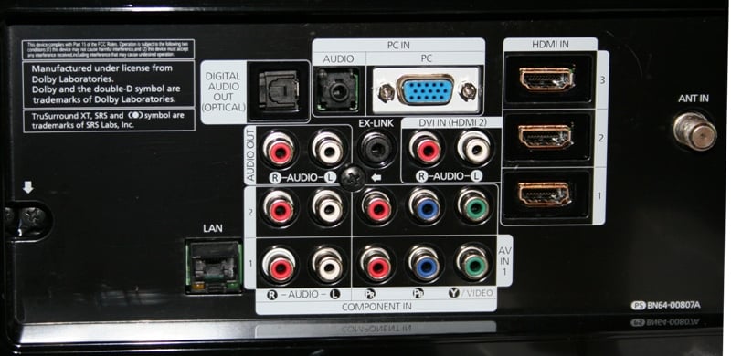

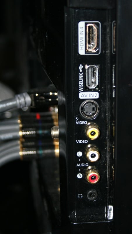

The LN52A750 has 4 HDMI inputs which is more than enough for most users. There
is a PC input for those still holding on to the promise of an HTPC and a couple
of Component inputs. Samsung also included a Composite and S-video input or two
but at this price point, no one really expects the user to have many of these
devices left.

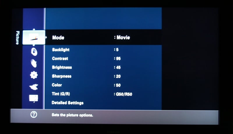

Picture Menu
There are tons of
options under the picture menu, very few of which you'll ever have to use. I
would definitely suggest going into the Picture

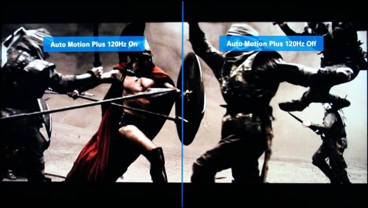

OptionsDetailed Settings submenu and play with the Auto Motion Plus 120Hz options. It
defaults to Low but has a very nice "Demo" function has overlays on
what you are actually watching with half the screen the 120Hz on and the other
half off. The Brightness, Contrast, Sharpness, Color and more are easily
accessible. If you want more direction control, look under for Black Adjust, Dynamic Contrast, Gamma, and
the all important White Balance. While all these controls are nice, for most
installations, just set the Mode to "Movie" and Film Mode to "Auto"
and you're good to go.

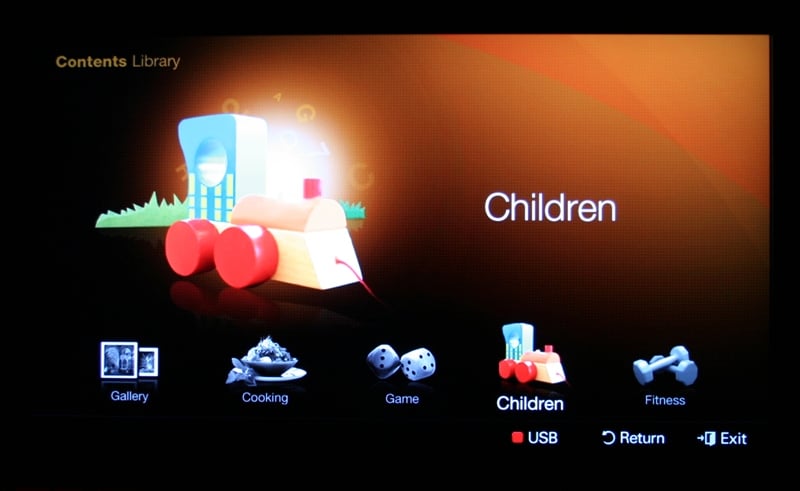

The Application menu allows
you to configure and setup some of the network abilities of the LN52A750 such
as the WISELink Pro and Anynet+. WISELINK Pro allows you to access and play
content such as MP3s, JPG, AVI, and other movie formats off of a USB key. It
also allows you to connect through an Ethernet connection to your router and
access content off your computer with a program called DLNA. Of course, you'll
have to install a program on your computer as well. The same connection can be
configured to give you access to Samsung's InfoLink giving you onscreen access
to news, stocks, weather, and more. Anynet+ allows you to control other Samsung
Anynet+ capable devices with your Samsung remote. Lastly there is the oddly
named "Content" which can be accessed directly from the remote as
well. Here you can display cycling artwork or pictures (included with the
display), play fairly lame games, and even get recipes and/or exercise advice.
While you won't be spending days in this menu, the Gallery is nice for parties
as the images are very high quality and really show off the abilities of the
display.

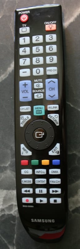

Remote Control
The remote for the
Samsung LN52A750 is very hit or miss for me - mostly hit. It sports a glossy
black top to match the display with large, easy to read buttons. The power
button is on the top left and is isolated so it is easy to identify and use.
Just under it and to the right is the backlight button - which lights up every
button on the remote except for the wheel and it's center button. This is probably
one of the cooler aspects of the remote. If you turn the backlight on and let
it time out, then the remote becomes motion sensitive and will light up at the
slightest provocation. We've experienced remotes like these before and a
generally annoyed by how reactive they are and how quickly they go through
batteries. Luckily, if you turn off the backlight manually, the motion
sensitive feature is disabled saving your batteries. Awesome.
The button layout is fairly well done, and though the buttons are a little too uniform, the backlight really negates this problem. There is a control wheel similar to something on the iPod though it doesn't work nearly as well. Fortunately, you can forgo the use of the wheel and just click on it in the cardinal directions. The only real problem I had with the button layout was the proximity of Menu and Source buttons. Changing sources is something that I'd have to do a lot and tended not to want to switch on the backlight. The proximity of the two buttons and the fact that the Menu button was larger meant that when I was trying to change sources I often engaged the menu. The switching of the location of the two buttons would have been fine in my book.
While most of the above is nitpicky at best, the one real problem with the remote isn't so much with the remote as it is with the display. It seems that Samsung just decided to put so much stuff into the LN52A750 that it wasn't responsive to commands. At the best of times, it took nearly a second to respond. On occasion, it would slow down (this seemed to happen if it was negotiating the HDCP handshake while I was in the Menu) to an absolute crawl. This was on of the reasons that the control wheel was pretty useless. By the time it reacted, you had rotated a full two or three times.

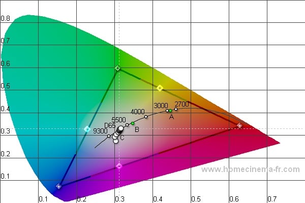

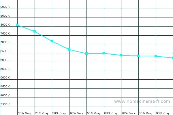

LN52A750 Measurements and Viewing Evaluation

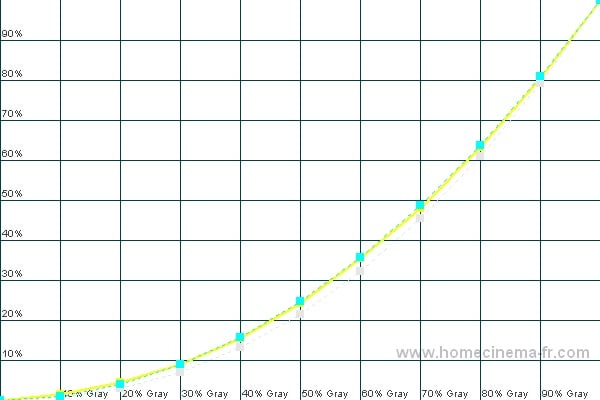

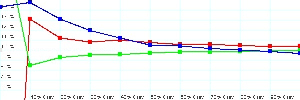

For calibration I'm using both the Sencore ColorPro5000 and Colormetre HCFR software. Basically, Sencore is great for calibrating your set but doesn't give you the pretty graphs that we like to show in our reviews. That's where Colormetre comes in. From the default settings, I measured:
Dynamic - 11000k (4850:1 contrast ratio)
Standard - 8500k (2300:1 contrast ratio)
Movie - 6500k (1450:1 contrast ratio)
Calibration options were nearly unlimited on the LN53A750 not that you needed them. All the standard stuff was there (Brightness, Contrast, Tint, etc) along with your gain and cut adjustments under the White Balance menu under Detailed Settings. I fiddled with these controls but in the end, I don't think you need to do much else other than turn the set on. I was able to achieve these measurements from the default Movie setting (Note: throw out any color readings below 30IRE due to limitations of the colorimeter I am using):
Color Temp (left); CIE (right)
Luminance (left); RGB (right)
Perfect Score is 130
Samsung
LN52A750 Benchmark total score: 120/130.
All tests were run through the HDMI 1 input.

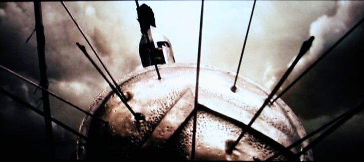

DVD: 300

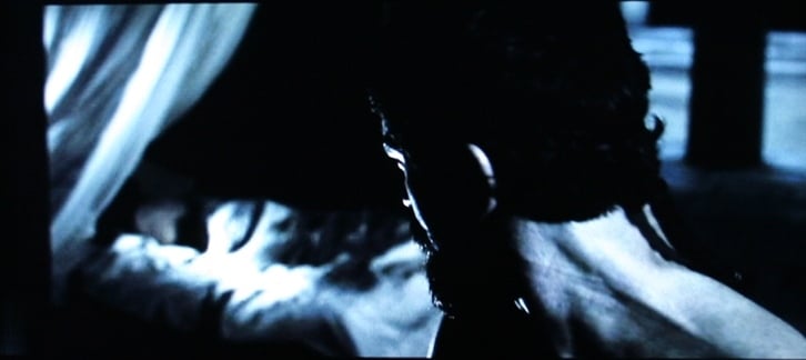

300 is easily one of
my favorite movies to use in reviews. The picture quality is a little grainy
(by design) but there are tons of dark scenes, brown tones, and deep reds not
to mention a lot of action. I used this disk for a number of subjective
evaluations including dark definition. The Samsung LN52A750 showed all the
proper definition in the prodigious amount of darkness in this movie. Even
during the night scenes, you could pick out the detail in hair and backgrounds.
While Lionidas is climbing the hill to see the oracle, even through the smoke
and darkness, there is never any sense of loss of detail. Is it as good as a
high definition disc? No, of course not. But it is still very good and sure to
impress your friends.

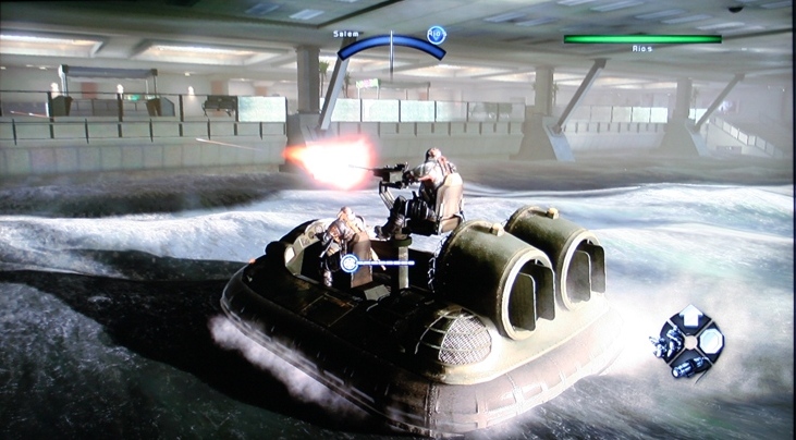

Xbox 360: Army
of Two

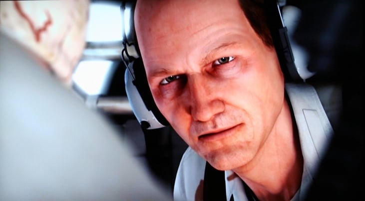

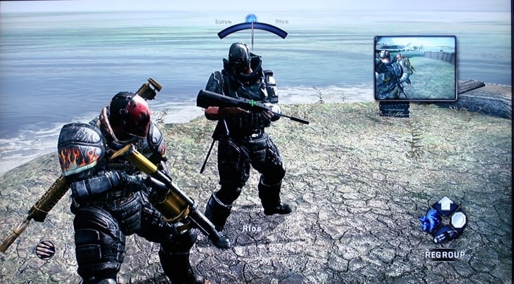

With the recent update
of this game, Army
of Two has recently hit my play rotation again. For the purposes of this
review, however, I was looking at vibrancy of color, ability to handle fast
motion, and over all picture quality. Army of Two has some of the most stunning
graphics (in game or cut scene) that I've ever seen. The LN52A750 absolutely
shined through this portion of the review. The 4ms response time in conjunction
with the default setting of "Low" on the Auto Motion Plus 120Hz
setting made for a very clean and fluid image. While I played around with the
Auto Motion Plus setting a bit, I never really experienced that "too real"
phenomenon that people associate with it. Often, this is because real film
doesn't refresh that quickly. To me, it just looked gorgeous. All the
characters were rendered beautifully and the colors really popped. If it wasn't
for all the people shooting at you, you could get lost in the graphics of this
game. And don't even get me started on the lush cut scenes. Rarely is there a
game where I will voluntarily watch the cut scenes more than once. With Army of
Two, it is rare for me to skip them.

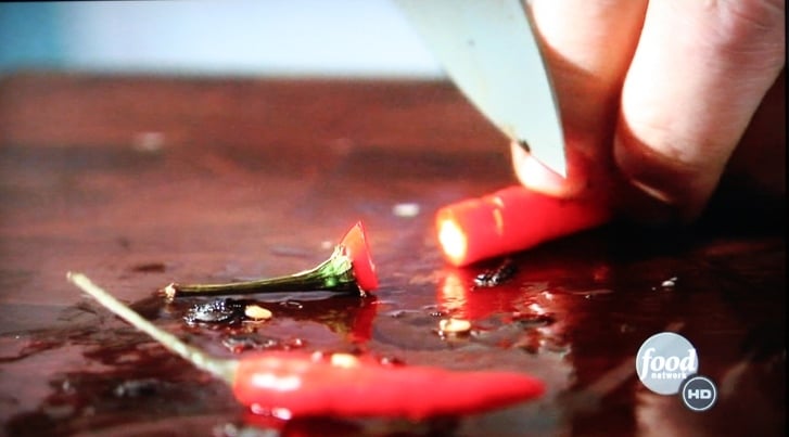

HDTV: Various Shows
One thing that the
LN52A750 cannot do is fix a bad cable signal. Motion blur and stuttering is as
often a sign of an overcompressed HD signal than anything else. For example,
the picture I took of Burn Notice was
from a late night recording that stuttered badly and generally had poor picture
quality while the second picture was from a special on the History Channel
about Indiana Jones during or near prime time. The difference is pretty
astounding. Just to check, I played with a number of the settings on the
Samsung to try to clean up the bad signal as much as possible on Burn Notice but nothing helped. A bad
source is a bad source. When you are running a display as good as the LN52A750
and you see something wrong, it is one of two things. Either the unit has a
setting enabled that it shouldn't or your source is bad. In this case, it was
the latter. I also grabbed a few shots from FoodTV specifically for the detail
and the color. I'm not sure what show that is but it looks like a box of
crayons threw up all over her home. If I every walk into a home like that, I
guarantee you that I'll turn right around and walk out. It's either that or
gouge out my eyes.
