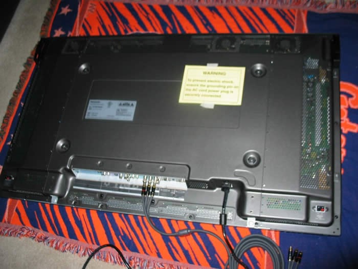

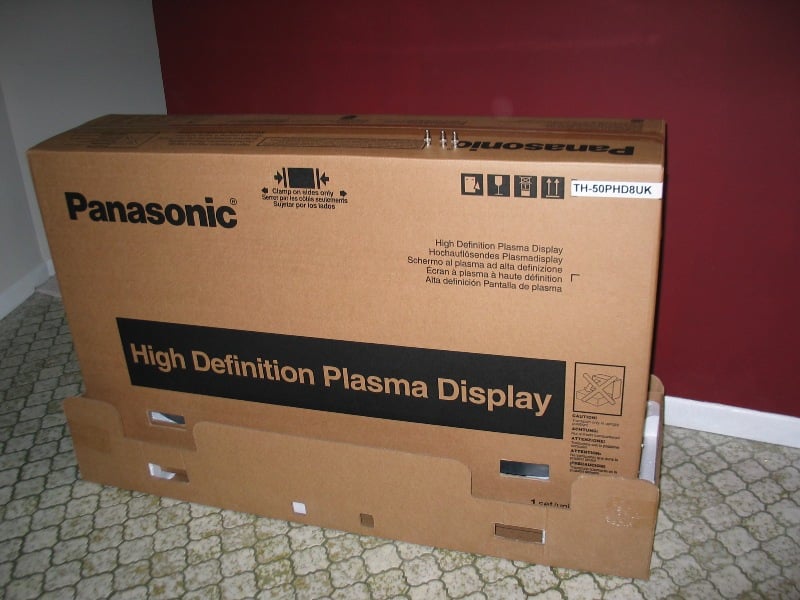

backThe 50PHD is a hefty unit so you'll need at least a friend (preferably two) to help you set it up. The set came triple boxed - the outmost box seemed to be just a mask for the brand labeling on the inner carton. Didn't want people to know that a plasma was being shipped I suspect. Honestly, though, what else could it be? A thin box that large has got to be a flat screen right? The delivery driver helped me unpack it and inspect it for damage - no problem there.
As impressive as the box is (it's freaking HUGE), the screen is no less so. A 50" screen is the stuff of dreams (at least mine) and frankly, it lived up to my expectations. The back of the unit has two removable handles near the top that are useful when installing. I set the unit up on the TY-ST08 stand. There was some assembly required... a few screws is all... and the setup went well. All my male friends in town wanted to come over and help me set the unit up but none of them could come over until that evening. A few moments after I broke the news, my wife, who's main "workout" is picking up our children helped me get the unit set up. Afterward she told me someone else would have to help me take it apart, but we did it.

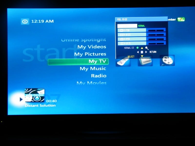

Menu_Size.JPGThis menu adjusted the position and size of the image on the screen. I had no issues with the default settings. If you did, you could stretch/compress the horizontal and vertical dimensions or reposition the image on the screen. With these settings you can really dial in the display, especially when using it to complement a HTPC or other computer output.

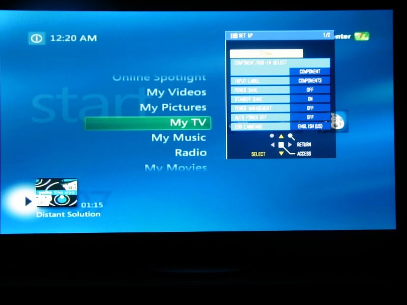

Menu_Setup_2.JPGThe Setup menu lets you select the input and define other functionalities. The TH-50PHD8UK has only one component, one s-video, and one composite input which means that you probably will have to do your video switching from an external source (switcher or receiver). I decided to let my Denon AVR-3805 handle the switching duties and connected it via component video. There were no DVI or HDMI inputs for this display which means that, except for a cable or satellite receiver, the best resolution you can pass to the unit is 480p from most DVD players (unless you have something like the Helios HVD2085 DVD player).

Menu_Setup_1.JPG Other configurable options included:

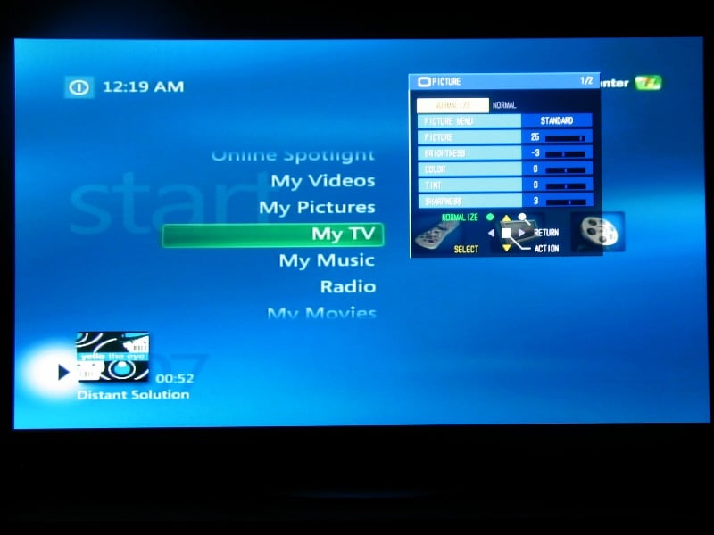

Menu_Pic_1.JPG The Picture menu houses all your standard picture adjustments. There are three different "Picture" menus (default settings) that are selectable. Out of the box, it was set to Dynamic which was a bit too bright but probably works well under fluorescent lighting. Cinema mode seemed far too dark. Standard seemed to be the best out of the box. Calibration confirmed this to be true.
Other than your normal Picture, Brightness, Color, Tint, and Sharpness, the menu included an Advanced Settings area you could enable. Under this submenu, you could control your red and blue levels, the black extension, and gamma among others. Generally I left this alone as well.

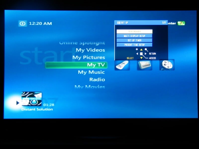

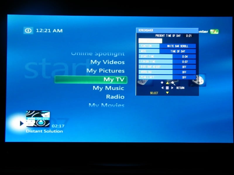

Menu_Screensaver.JPG If you are going to use Normal mode or watch endless hours of news channels or are an avid video gamer, you may be concerned about burn-in. The screensaver is a nice feature to reduce burn-in. You can actually configure the screensaver to engage during certain times of day (though the unit has to be on, it won't turn itself on - a feature for future iterations of this unit which would benefit commercial users).
The two options are negative image (if a static image is shown during business hours, a negative would ensure that all the pixels are used equally) and white bar. The white bar will travel the screen from left to right.

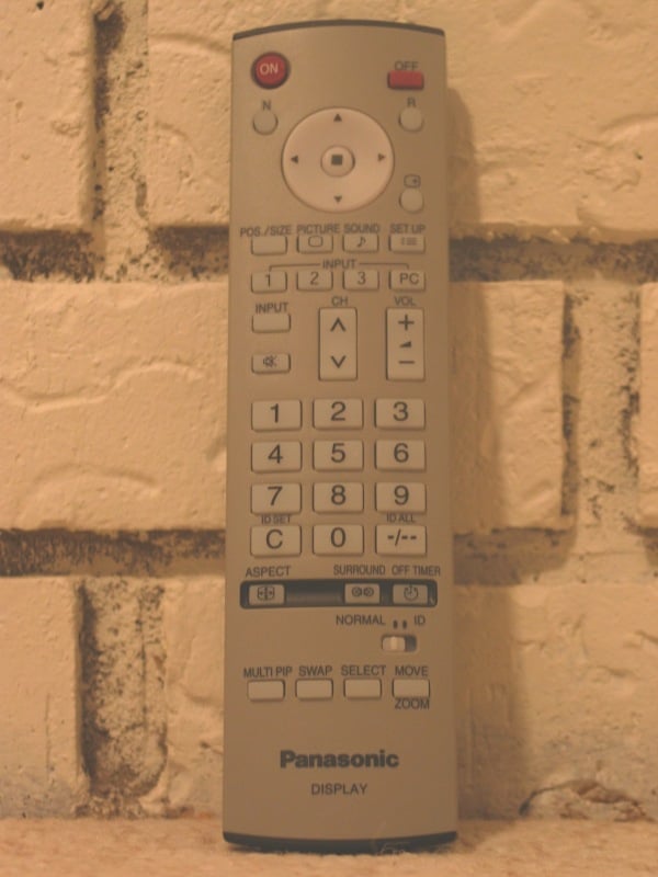

Remote Control
Remote.JPGAs much as I like to bash remotes (and I do, really) this one wasn't so bad. Now, other than turning the unit on and off, changing the aspect ratio, and adjusting the settings, I didn't have much use for it. The buttons are fairly well laid out and it isn't too light. The directional keys at the top work well and are very near the settings keys (which is a good thing). Personally, I'm pleased to see Panasonic split the on and off functions into two separate buttons. This makes it incredibly easy to program macros into even entry-level universal remote controls.
The remote is as ergonomic as a 7" piece of 1 x 2 and it wasn't backlit (though it looked like it could be). I found the lack of backlighting confusing as the buttons seemed to be made of the white, translucent plastic common on backlit remotes. My few complaints were that the aspect key and PiP keys at the bottom of the remote kept getting mixed up. My only other quip was that I sometimes had problems getting my unit to respond to the remote. Usually, this happened when turning on or off the unit. I'm not sure if it was the position of the sensor on the unit (bottom left) or an inherent issue with the IR transmitter/receiver system. I could see the light flicker indicating that a command had been received but then nothing would happen.

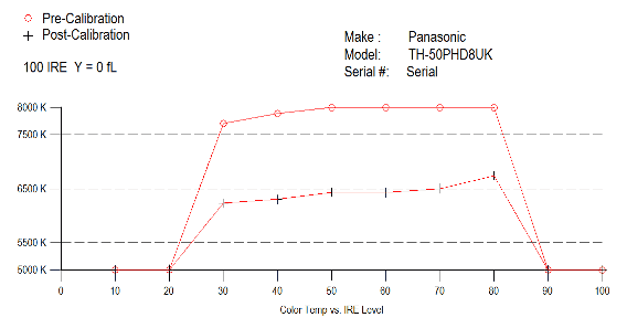

We used the Sencore Color Pro 5000 (CP5000) to calibrate the display. As you can see, the set ran cool out of the box (varied between 7700k and 8300k between 30 and 80 IRE) with a heavy blue emphasis. After correcting for the overabundance of blue, it was much closer to the target of 6500k between 30 and 80 IRE (ranging from 6200k and 6700k).

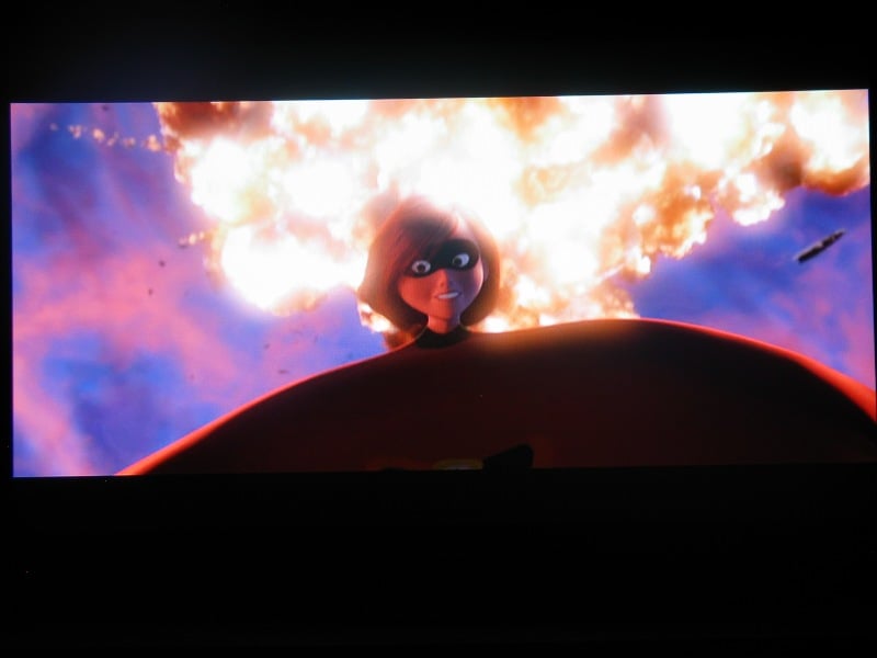

The Incredibles

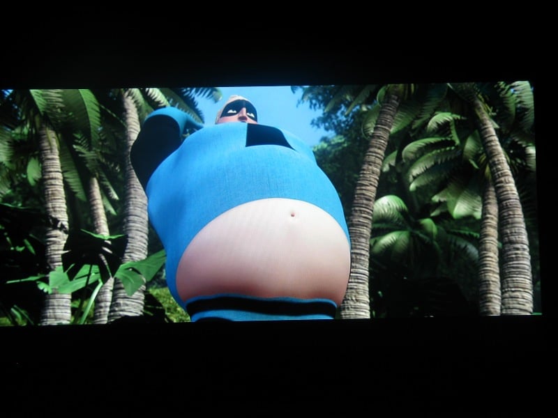

I freakin love this movie. In my opinion, it is by far Pixar's best work. Superheroes with a James Bondish plot?! Brilliant. I was noticing a ton of detail that I wasn't noticing before. The texture of the suits, the movement of the hair, a lot of little details that just weren't apparent on other displays. Colors were vibrant but not oversaturated. Blacks looked good as did the nuances of the textures on the uniforms. Motion was never blurred nor did I notice an abundance of macroblocking during the darker scenes or explosions.

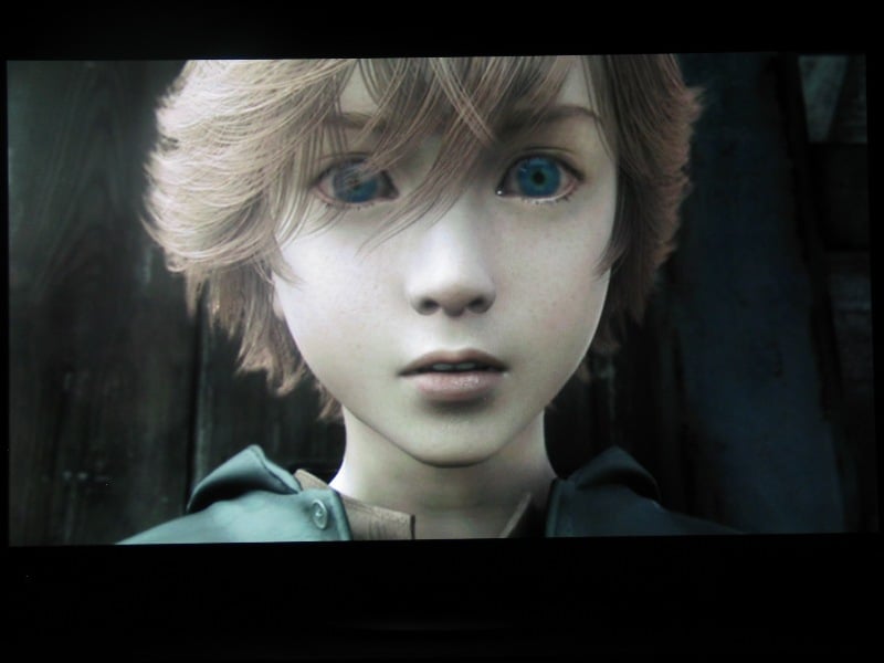

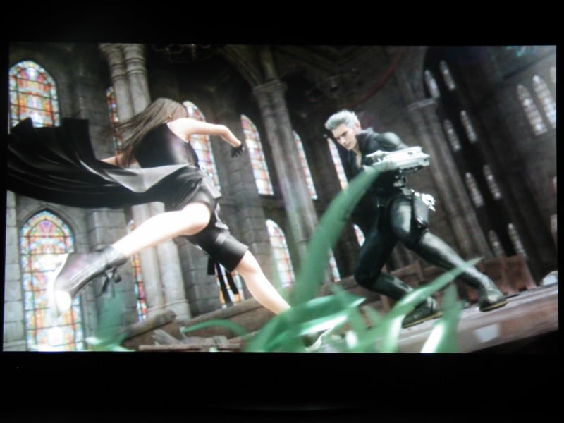

Final Fantasy VII: Advent Children

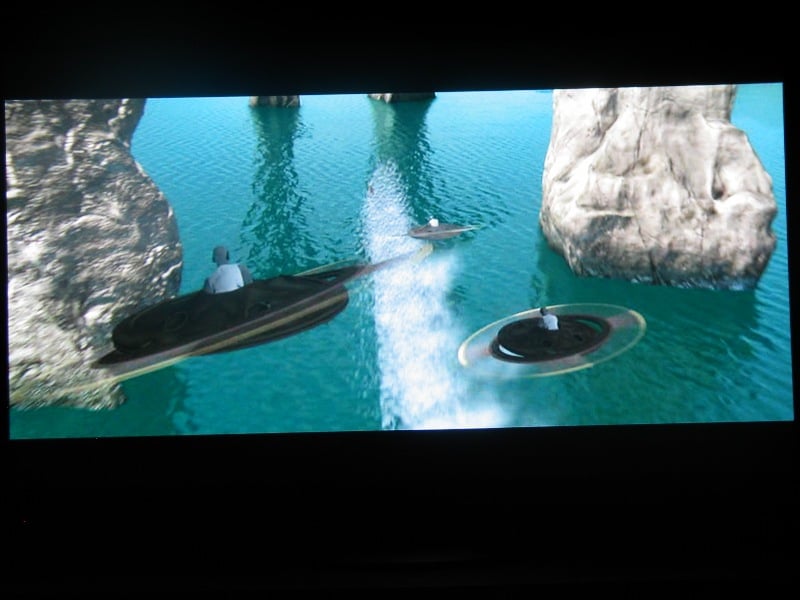

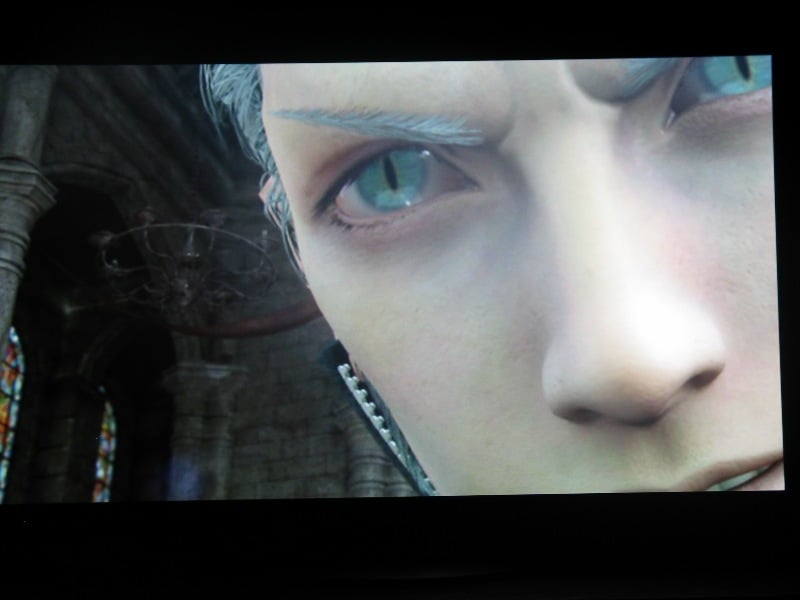

Now, for people that know and love the game, this movie might make sense to you. For everyone else, don't think this is Spirits Within part two... cause it ain't. I never was one for the epic RPGs that have such a rabid following so I wasn't familiar with the story. Fortunately, I have a friend (who brought the movie over for me to watch), so he translated... sort of. The prelude "movie" (really, just outtakes from the game) makes no sense even with a "translator" and I don't think I could sum up the plot of the main movie if I wanted to. "Disjointed"is a word, though "drug induced" might fit better. My comment after it was over, "Hey, man. Someone went to the bank and cashed a check after writing that story. They got paid for that! How do I sign up for that gig?" Anyways, it was a beautiful movie to look at if a bit smoky. It seemed as if there was a layer of haze over the entire movie. When it was clear, however, the textures were beautiful and the graphics intense. There were lots of action scenes that were intentionally blurred but those that weren't generally worked fairly well. There was some evidence of jaggies here and there and some graininess to the layer of fog but overall, it was fairly well done.

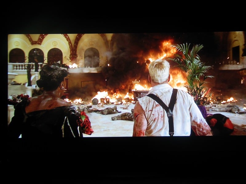

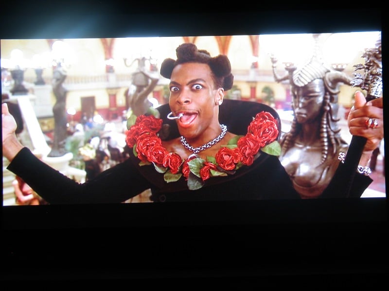

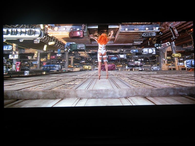

Ok, Ok, I know. Everyone uses The Fifth Element in display reviews. Frankly, I can give you 10 good reasons why and only the first five are Milla Jovavich in "bandages." Quirky story, epic storyline, fantastic acting, and a killer DTS track on the Superbit version - well, who wouldn't want to watch it over and over? The colors were as vibrant as I've ever seen and there was little evidence of banding in dark scenes. The sets provided plenty of opportunities to check out the detail capable by this unit. With a good progressive signal, the clarity and colors on this unit was nothing short of phenomenal. The detail on some of the costumes for the aliens (a refreshing change from some of the poorly done CGI we are subjected to) became even more apparent with the clarity of the display.
