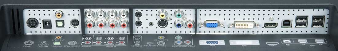

Connections
There are a plethora of inputs on the rear of the the XHD3000, however duplicates are not something Gateway considered critical. What this means is that while you have one each of HDMI, DVI-D, VGA/HD-15, component, etc – if you have two DVI-D outputs from two different PCs you're out of luck. I personally run a Mac Mini and a PC. To get both connected I simply utilized the VGA input for the Mac. I am completely satisfied with this arrangement (the Mini won't support 2560 x 1600 resolution regardless) but those users hoping to pipe two DVI-D outputs into this monitor will need to get a separate switcher.
The availability of separate audio inputs for each of the analogue and the DVI-D inputs means that this is a true multi-source display. I have seen many displays that “share” audio inputs, especially between composite and S-video. The dxp Speaker Bar (DXP stands for “Digital eXplosive Power” – just kidding I made that up) plugs into the rear of the display and requires both an audio and power connection which are provided.

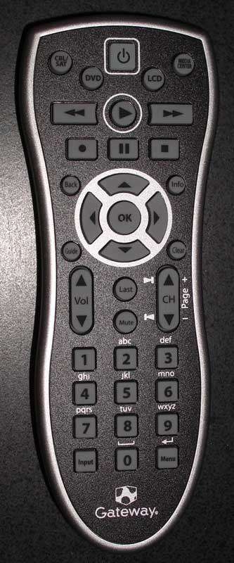

The
Gateway remote does it's job... barely. It has no discrete input
buttons and also lacks discrete power on/off buttons. It is not
backlit. It is a
programmable remote so you can, if you're a masochist, program other
device remotes into it. There is no learning possible with this
remote. I'd love to say more, but after using it for a little bit I
put it down and played some more with the cool blue buttons...

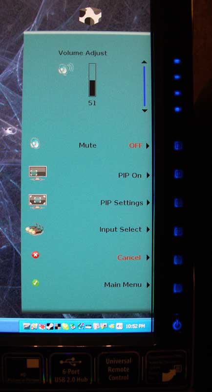

The Menu System
I
loved the contextual menu system. I think I really liked not having
any physical buttons to press. You have no idea how frustrating it is
to click-click-click forever to get where you need to be. On the
Gateway XHD3000, you simply slide your hand around or casually brush
a button area to select the option you need. And it's laid out in a
fairly intelligent manner. Once I got into the PIP functions, I found
that the first menu enabled me to activate or deactivate the function
– I didn't have to drill down 3 levels to turn it on or off. They
obviously did some human testing on this product to check ergonomics.

The first time you select the menu you'll be presented with the ability to adjust the volume, mute the system, control PIP functions, select a different input and also advance to the Main Menu. This method of giving you instant control over the most used-functions is a great, practical solution that ensures you're not wasting time clicking around menus to get the most basic tasks done.
Main Menu

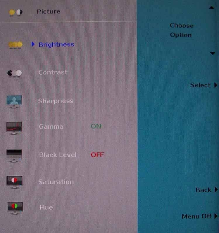

Here you can adjust picture settings (limited to Brightness with DVI-D input), PIP settings, Geometry, Audio settings and access Advanced menu controls.
Advanced Menu
Color adjustments can be made here (though not when using DVI-D) and it is here that you can set the front panel LED mode to Day or Night which makes sure those blue lights aren't blinding you at night. Some housecleaning functions are also located here, including the Resolution Reminder, IR Training, Input (auto)Search, Integrated Product Tour (turn this OFF quickly!), and Information (shows current input and frequency). You can also reset the display here and change the Language.
Brightness, Contrast, Sharpness, Gamma, Black Level, Hue and Saturation can all be adjusted here. With DVI-D you can only adjust Brightness, however.

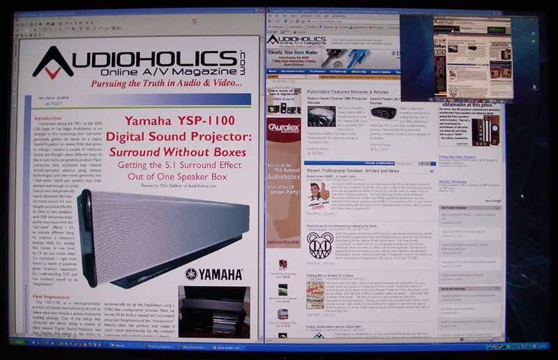

PIP Settings
The PIP Settings menu is where the magic happens. The PIP features of the Gateway XHD3000 are only available when 2560x1600 PC video over dual-link DVI-D is selected as the primary video source. Those options, however are very cool. Users can select the PIP source (ANY of the remaining inputs) to be overlaid over the DVI-D input, vary the position (Upper Left, Upper Right, Lower Right, Lower Left) and even vary the Size and Transparency of the PIP window. Varying the size and Transparency of the PIP utilizes the top touch control which operates in a slider mode, allowing you to quickly adjust the parameters smoothly and in real-time.
The
guy in The Matrix could have used this screen instead of the 9
scattered 15-inch monitors...

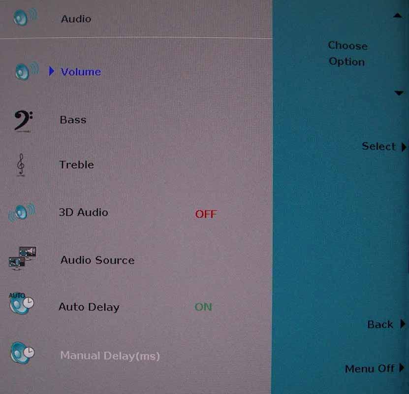

Under the Audio menu you can adjust Bass and Treble and also enable 3D Audio, a DSP-based pseudo-surround mode that gives depth to two-channel soundtracks. This type of phase-based DSP, while nifty in small doses, tends to give me a headache so I left it off. The audio menu also allows you to switch the Audio Source from the Main source to the PIP audio. This is beyond cool as it allows you to work while watching AND listening to the television... not that I'd ever do that while writing a review (Go Eagles!) The last two options in this menu involve audio and video sync. Auto Delay (on by default) adjusts the audio to be in sync with the video – compensating for advanced video processing which often introduces delays. Manual Delay allows you to manually delay the audio in ms.

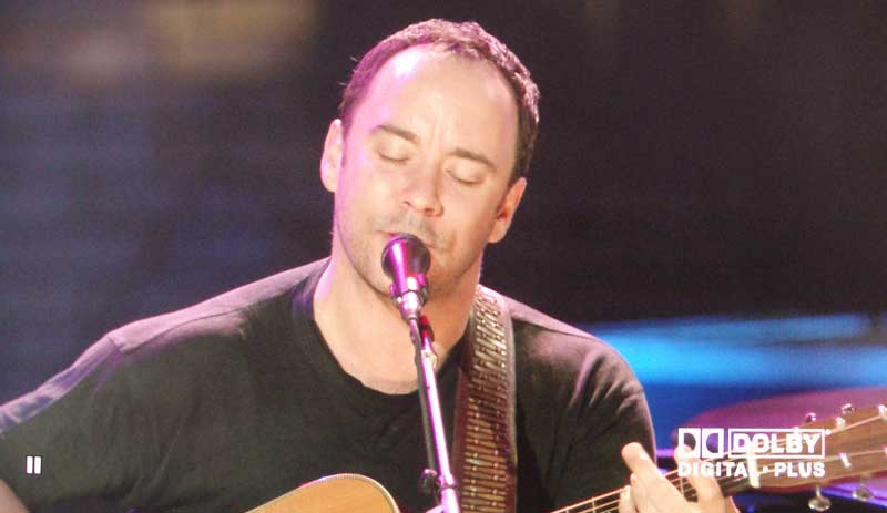

Blu-ray: Dave Matthew and Tim Reynolds Live at Radio City Music Hall
This was a selection I felt showed off some very nice live concert footage. The setting was intimate so you're looking mostly at face detail, guitars and the stage. Note the detail in the black shirt Dave is wearing. While the black levels are a bit high, detail is not a problem and I noticed no real-world crushing or banding.

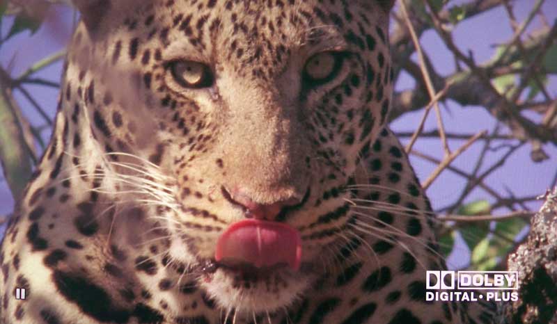

Blu-ray: Safari (BBC)
I'm a sucker for wildlife in HD. If I'm flipping channels and come across a nice lion attacking a herd of water buffalo – I'm going to be drolling in front of the screen in a stupor of wildlife-driven mindlessness for an entire hour... The DiscoveryHD channel is a place I need to avoid lest I misuse my time and end up trapped by the dozens of incredible looking shows they run 24/7. In this BBC show titled Safari, there was plenty to gawk at and I took several shots. Here are some of the nicer ones that exemplified the color, detail and noiselessness possible with this monitor:
He looks hungry... think I'll move along.
This guy reminds me of my cousin Wade for some reason.

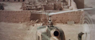

Blu-ray:
Sahara
I
really liked this movie, mostly because of the fact that Steve Zahn
takes the role of “sidekick” and turns it into something more
than just the tired “idiot who gets hero in trouble” routine. It
was a fun movie and there was plenty of opportunity for exemplary
display material.
