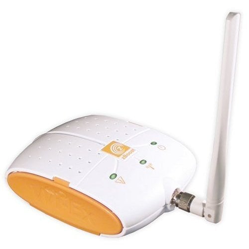

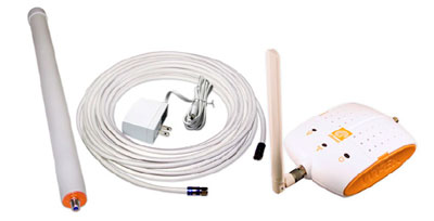

The device is very simple.  In the box you will find a 35 foot section of white RG-6 cable, a white antenna that looks like a piece of PVC pipe, and the base station, which looks like a wireless router or a cordless phone base station.  The base station has an included power adapter.
Not only is the device simple, but so is the concept.  Find a spot outside of your home such as your back porch, or an area near a window and mount the antenna.  Run the RG-6 into your home to the base station, and plug it all in.  Once you power up the base station, you should see an improvement in your signal.
