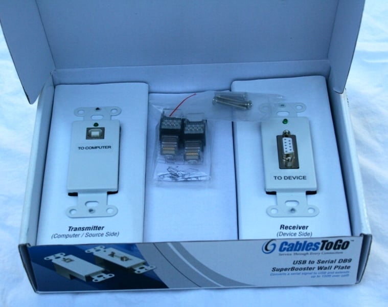

The packaging of the USB to Serial DB9 Wall Plate is very professional
looking and has all the protection you'll need. The wall plates I received were
white and it is unclear from the Cables to Go website that there are any other
colors available - but it's likely just a matter of time. Each is labeled with
a small sticker which can easily be removed. Labels are also on the back of the
units just in case. The front plate is metal while the back box is black
plastic. There is an Ethernet port on the back of each for your Cat5 run. You
can either use pre-terminated cable or Cables to Go provides tool-less IDC
RJ45 connectors for you DIYers. Everything feels and looks very sturdy and
professional. Honestly, this is a five second setup for most custom installers.
On top of that, there is no power required! It is bus powered (runs off the USB
connection) so as soon as you plug it into the computer it is active. Talk
about easy! It's so easy a… well, you know.

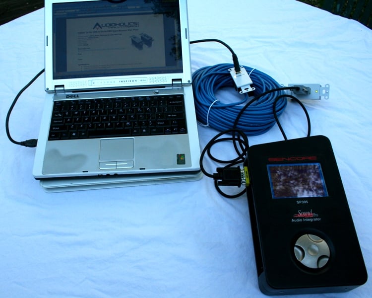

Now, I'm hard core
and all but I'm not so hard core that I'm going to run 150' of wire in my walls
just so I can test out a wall plate I don't need. Luckily, I didn't have to as
Cables to Go included a spool of 100' of Cat5 and both the wall plates. I just
needed a device that output RS-232 that needed to be connected to my laptop via
USB. Fortunately I had just acquired the Sencore SP395A FFT Audio Analyzer
which is used (among other things) to measure speakers. I am using a short
cable and standalone converter for this connection so it was easy enough to
take the Sencore, plug it into the Serial side, connect the computer to the USB
side, and use the 100' spool of Cat5 to connect the two. I didn't even have to
unwind the cable. If you are planning on installing this system in your home, I
highly suggest you do this first. Last thing you want is to run all that wire
just to find out there is a problem.
Luckily, I didn't run into
any such difficulties. The USB
to Serial DB9 SuperBooster Wall Plate worked exactly as expected, even over
100' of Cat5. According to some of my peers, the Sencore SP395A FFT
Audio Analyzer has a notorious habit of not being compatible with USB to Serial
converters, but the Cables to Go solution had no problems with it. If you're in
need of a solution like this, you can rest assured that USB to Serial DB9 SuperBooster Wall Plate will
work as advertised. With the ease of installation, this is a serious no-brainer
for any custom installer.
