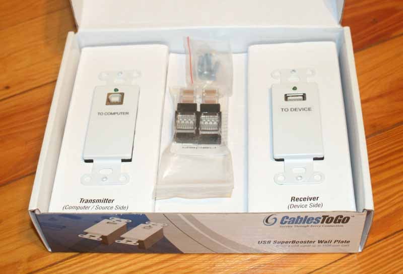

This is one of those products that is better shown than
talked about. The connections are simple. For the wall plate models you simply
set up the transmitter (USB B-type connector) so that it is near the source
(typically a desktop or home theater PC). The other end is a standard A-type
female connector that can receive any USB 1.1 device which plugs into that type
of connection. Since the system pulls its power form the USB connection on the
transmitter (Computer) side, you don't need to worry about external power
supplies. It literally just works. We tested our configuration with a 100 foot
run of Impact Acoustics Cat5e cable and were able to upload and download
information from our Universal MX-3000 reference remote control and MRC-400
system controller. Transmission was quick and the computer never once asked to
install any drivers for the new USB components. That's a definite plus since it
essentially means that the system just works transparently as far as your PC is
concerned.

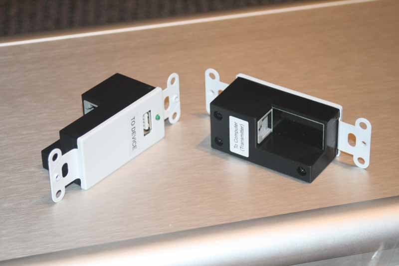

The physical characteristics of the wall-plate Superboosters include
Decora-style devices which have a recessed Cat5e port. Everything about these
products seems tailored to convenience and ease-of-use.
The USB Superbooster wall plates also come with a pair of tool-less IDC RJ45 connectors, so you can terminate your own bulk Caty5e/6 cable to any length you need. It's a nice little addition that gives is all that much more value to consumers who might purchase it (installers will presumably already have tons of connectors for Ethernet-type cabling).

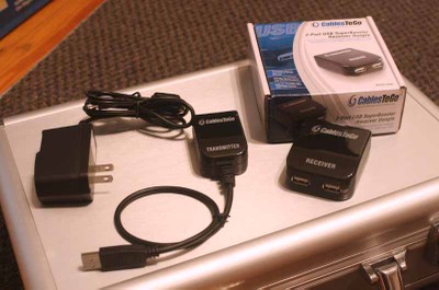

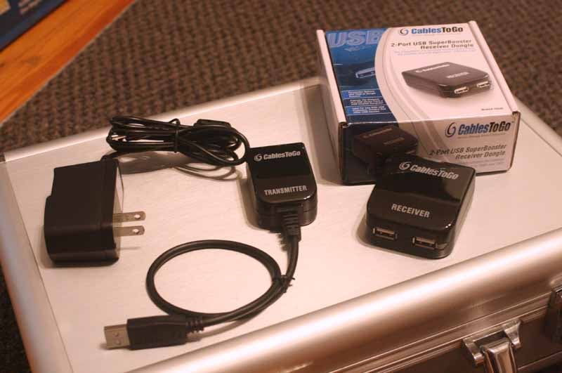

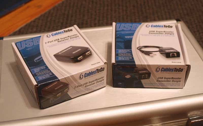

The extender kit is similar except that it doesn't
feature the styling of a wall-plate. This system would be more useful for
installations where an entirely dedicated wall plate would be overkill. In this
way the transmitter and receiver can simply exist in-line with the components
and jump directly to a wall plate containing an RJ45 port. Our kit came with a
2-port receiver, so it may be advised to use the included DV power adapter.
