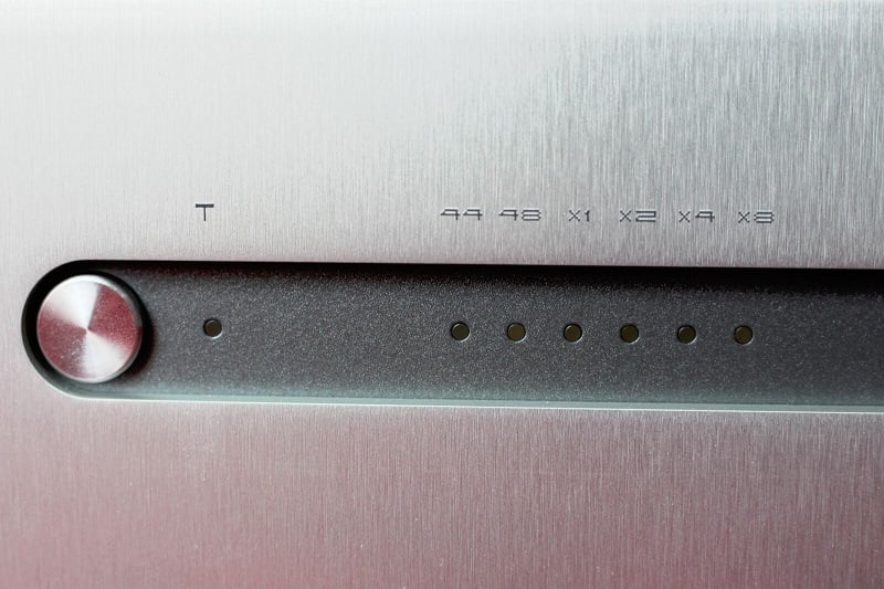

Front
On the far left of the front
panel is a phase invert button along with its own LED indicator; this is
helpful for recordings which do not maintain an absolute phase. Adjacent to
this are sample rate indicators which highlight what input is coming in. Right
now the Yggdrasil only accepts up to 24/192 files so the 8x multiple will never
be lit. However, since the product is upgradeable, the future may allow this to
happen. The input select button can be found at the center of the product which
allows users to cycle through various means of input including USB, AES/EBU,
BNC, Coax & Toslink. Finally, the VCO/VCXO indicator is situated on the far
right of the device. This LED is also known as the “buy better gear light”
which means exactly what it says on the tin. That is, if the source input in
the Yggdrasil doesn't have a good center frequency or if jitter levels are too
high for the VCXO to operate then Schiit recommends to buy a better source. The
good news is that this really only applies to very old devices and thus is
rarely illuminated.

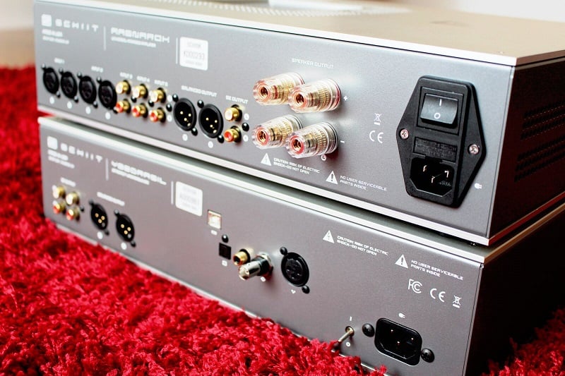

On the rear of the Yggdrasil,
there are 2 sets of single-ended outputs which are said to retain much of the
same prowess as the balanced portion of the DAC. Adjacent to this, are the
balanced outputs which can be connected to other sources with XLR cables. The
USB, AES/EBU, BNC & Toslink inputs together with the switch and power input
can be found on the right half of the DAC.

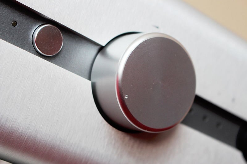

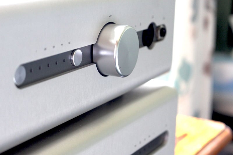

On the front of the Ragnarok
is a 5 input switch with LED indicator, gain switch (1, 5 & 20 settings),
potentiometer, single-ended and balanced headphone output. The potentiometer is
very tactile and smooth to the touch. It implements the aforementioned
relay-switched attenuator which results in normal clicking when the volume is
turned up. The process is surprisingly satisfying to use and is reminiscent of
a typewriter in action.
An important point Schiit have drawn attention to is that care must be taken when using the balanced headphones. This is because the Ragnarok is a powerful amp and can deliver its full output power when using such configurations.

The rear of the Ragnarok hosts
a wealth of options for the user. Examples of this include the 2 sets of
balanced inputs, singled-ended inputs, a single & balanced preamp output,
speaker outputs and a power switch.
