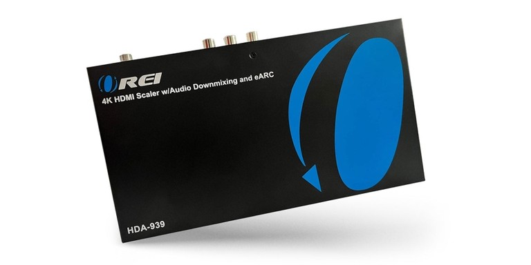

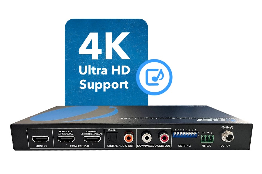

The OREI HDA-939 is a nifty little device that could be useful to the AV enthusiast in countless ways. The branding on its small chassis (1” high by 8.4” wide by 4.6” deep) informs us that this $199 gadget is a 4K HDMI Scaler with audio down-mixing and eARC. The manufacturer’s website describes the OREI HDA-939 as an eARC Audio Extractor. In reality, what it would do in your system depends upon what you need, because the OREI HDA-939 is surprisingly flexible and can pull off a number of useful tricks. The front panel, with its variety of indicator lights and a single button for selecting an audio input, gives away very little. The Dolby and DTS logos only hint at potentially useful codec support. But around back, the business end of the OREI HDA-939 makes things clearer. There’s a single HDMI input, two HDMI outputs, a coaxial digital output (RCA), an optical digital output (Toslink), and an analog stereo output (RCA). An RS-232 control port rounds out the connectivity, but there are also 8 DIP switches which can be used to control the various functions: video downscaling, audio down-mixing, ARC/eARC functionality, HDMI audio embedding, and EDID management. (EDID, or Extended Display Identification, is an industry standard for AV source and display devices which automatically communicates manufacturer specification and data between devices. This allows your AV source to send the best compatible signal data to your display, TV, or projector, to ensure the best possible results.) If all 8 DIP switches are in the “off” position, the whole system can be controlled by API commands.

The DIP switches on the back allow the user to customize the functionality of the HDA-939. For example, a 4K 60Hz 4:4:4 video signal from the unit’s HDMI input can bypass all processing and be sent to a downstream display unchanged, or it can be downscaled to 1080p for use with older display tech. A Dolby or DTS bitstream can be passed along via HDMI to an AV receiver or processor, or it can be decoded inside the HDA-939 and sent out as a stereo signal. The unit can output audio via HDMI, coax, Toslink, and analog RCAs all at the same time. OREI says that the device outputs “high-bandwidth and high-quality audio” for traditional AVRs, but the analog stereo output allows any device with an aux input to play back the audio from an HDMI source. LED indicators on the front panel indicate power, status, and audio formats. For example, an LED lights up when an eARC signal from a TV is detected. Output audio can be controlled through API commands, including commands to increase or decrease volume, and commands for mute and unmute. The HDA-939 complies with HDCP 2.2/1.4, and will automatically use the correct version to correspond with the selected HDMI output resolution. If sending out a 4K signal, HDR10, HLG, and Dolby Vision are supported.
