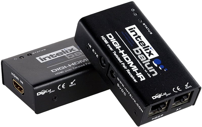

Intelix LLC showed off their DIGI-HDMI-IR, a professional-grade twisted pair extender which distributes HDMI and IR signals up to 150 feet.

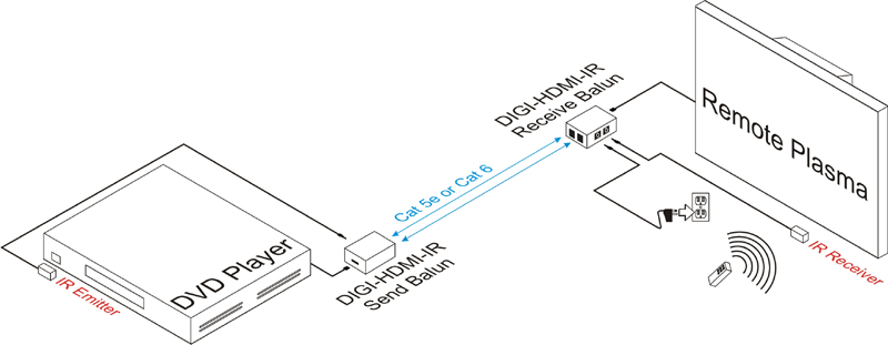

Let's just simplify this one. While not a cheap solution at $350, it is good up to 150 feet over Cat5e or Cat6 for 1080i (100 feet for 1080p - a working HDMI 1.3 cable at that length is probably going to cost more), is HDCP compliant, supports 1080p, and is protected against electrostatic distortion. The cool functions are numerous. First, you only have to power one side (the destignation). Second, it has diagnostic LEDs on both the send and receive units which will come in handy so that you'll know that your connection is working so you won't have to run all the way across the house. Lastly, the simultaneous IR transmission. If you don't think this is cool, check out the diagram below.
It took us a second but think about it. For $350 (plus the cost of the Cat cable) you get a 150 foot HDMI cable plus an IR emitter and blaster. This is a perfect solution for those that are have a component in one room and a display in another. Plus, while they show a DVD player, this could easily be a receiver or Blu-ray player/changer. While those with a dedicated universal remote system might not find it necessary, for those that need it, this is very elegant solution. Check out more about the DIGI-HDMI-IR at www.intelix.com.
