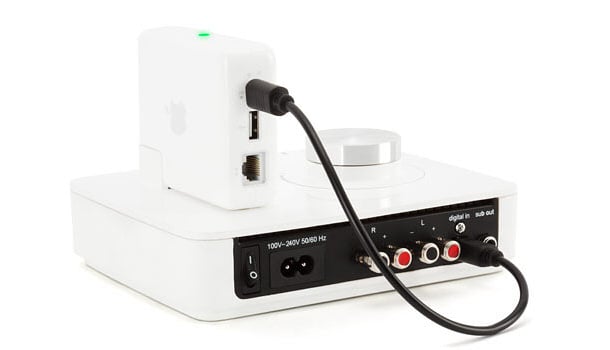

griffin 20 back
As you can see, the Airport Express plugs directly into the the top of the Griffin Twenty and is powered by the unit. Using the supplied cable, you connect the audio out to the digital audio input. To the right of the optical input is an RCA subwoofer output. Two pairs of spring loaded speaker wire connections are available for your existing speakers. Only bare wire (or maybe pins) will work with these types of speaker terminals. Lastly is a port for the power cord (we're betting the power supply is housed on the cord as with laptops), and a power switch. The top has a large, silver volume control and a few indicator lights.
Inside the diminutive box is a TI PurePath stereo class D amplifier sporting 20 watts per channel into 8 ohms @ 0.08% THD, both channels driven. The subwoofer output is set with a crossover of 80Hz which, if you have a set-in-stone crossover point, 80Hz is where we'd put it. The Griffin Twenty auto-senses the presence of a sub to enable the crossover. We're a little leery of this solution and wonder why Griffin didn't just go with a switch. It isn't like people often take subs in and out of systems. Once they are in, they tend to stay. Maybe they think Apple-ites don't really understand how subs work (and, they're probably right for the majority).
