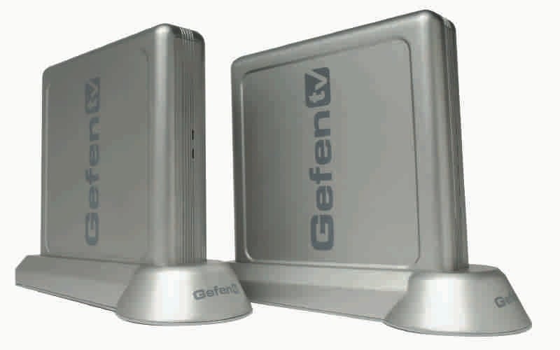

GefenTV Sender and receiverSo there I was, holding the lightweight and slightly larger than a paperback book-sized Sender in one hand and the Receiver in the other. At $900 for the set, it isn't cheap, but more important is whether it can actually do the job. And for that to happen, that meant no video freezing up or blanking out. Or any hiss stuttering or loss of audio either (although that's a lot easier to get right than video). Which brings me to one of the key issues that has been holding back other companies from bringing devices like this out: interference. The technology that's doing the heavy lifting has to not just perform, but perform consistently in an environment that's filled with EMI (electromagnetic interference). As in coming from wireless networks, cell phones, microwaves, cordless phones, you name it. And add on all this coming from neighbors as well for apartment dwellers.
GefenTV uses wireless 802.11n to do its thing and operates in the unlicensed 5 GHz band to transmit HDTV. The tech folks at Gefen say that this is a dependable technology, compared to all the hoopla of using lasers and so-called futuristic choices. And I'm also told that the technology is robust enough to deal with issues like EMI. We'll see.

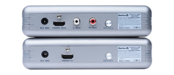

GefenTV backThe included manual is miniscule and better served by being downloaded as a PDF from Gefen's website. Basically everything you need to know becomes obvious as you put the various parts together. To begin, nothing on the units indicate which is which, but it's pretty obvious which is the Sender and which the Receiver once you look at the connections on back. The Sender has a HDMI output and a plug for power, while the Receiver has a HDMI input, plug for power as well as left/right analog audio outputs (note: this output is only active when the audio being carried along by the HDMI source is 2 channel LPCM).
The GefenTV is HDMI 1.2a compliant and supports multichannel 5.1 audio and PCM through HDMI. Both Sender and Receiver have a front Power light and runs off of a 5V power adapter (there is also a Link light, but more on that in a second). The AC plugs include multiple taps for use in various countries, and it's easy enough to seat the correct plug, just remember to remove the protective insert that's already in place first.  Also included is a pair of stands that the Sender/Receiver can be easily fit into. While this makes the units stand vertically, I don't have any problems with the small footprint created. And I agree with Gefen's suggestion that this placement lets the radios function at their best (my experience in the past with standard-def wireless transmitters having shown this to be true). Finally, a good quality HDMI cable is included for connecting to the Sender. By the way, the cable, power supplies and Sender/Receiver come in a compact and nicely designed box for storing the unit or, as is more likely, as a sensible way of transporting everything from one location to another.
Both the Sender and Receiver use a Mode button to toggle between Unicast (one Sender/one Receiver) and Multicast (one sender/up to 5 Receivers). A green power light indicates Unicast while red designates that Multicast has been selected. As I only have one Receiver anyway, I selected Unicast mode. My living room setup consists of a number of video and audio sources connected via HDMI to a Yamaha AV receiver. An HDMI cable then snakes from the Yamaha's HDMI output to a front projector about 20 feet away. I plugged the output from the receiver to the Sender's HDMI input and inserted the AC plug (both Sender/Receiver are always on as there's no on/off switch). I then went over to the front projector which sits on a small table and moved it farther back - making the distance from the Yamaha receiver now greater than 50 feet. I took the HDMI cable coming out of the GefenTV Receiver and plugged it into the projector's HDMI input (and of course plugged in the AC for power).  I then switched everything on in the order Gefen specified: first the Sender/Receiver (which are already on, as is the Yamaha), then the display (in this case the front projector) and finally the video source, the BD player. The Link LEDs on the front of the Sender and Receiver started blinking rapidly - meaning that they were searching for each other. This was an automatic process.
