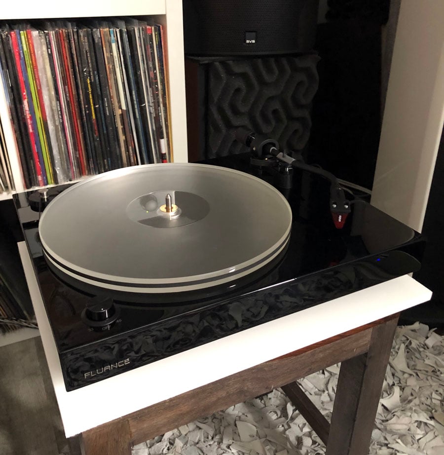

When Audioholics asked if I would do a full review of the new Fluance RT85 Turntable it was an opportunity I couldn't pass up. Fluance, now celebrating 20 years of service, is not normally in my world of beloved vinyl records and the related paraphernalia that I so truly obsess about daily. As far as the company goes, I was a bit  surprised looking at the specs of the new RT85. Fluance is normally regarded by vinyl aficionados as a mid to entry-level company. With the RT85 it is now jumping into new territories, the right way, by providing consumers with great value along with a product you can be proud of in every way by not braking the bank while exceeding in performance.

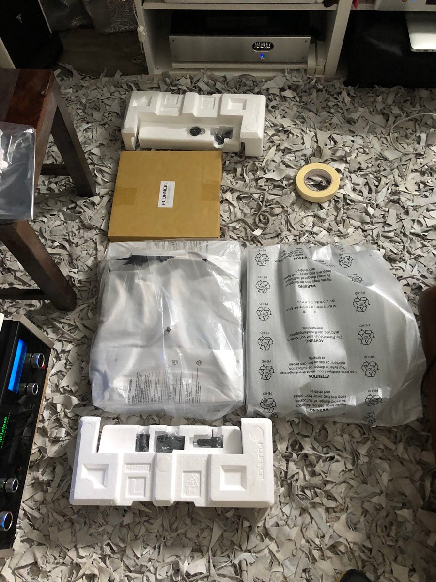

Fluance RT85 PackingThe RT85 arrived at my home and I was more than excited to review this new flagship platform from Fluance. Being familiar with some previous models like the RT81, this good-looking turntable had my expectation high for this new and attractive mid-level turntable.
The 85T was presented in a single box package with plenty of foam and protection for transport around plinth and several cardboard pieces to keep all components from damage. All parts are laid out quite nicely with the instruction manual right at the top of the box for fast easy access. The manual was very easy to understand and follow since the 85T is almost all preset from the factory. The ease of putting the entire turntable together is fast and user-friendly, especially for those that try to challenge themselves by not digging into the manuals unless they get stuck.
I mention this due to a hiccup with the dust cover for the motor (more about this below). I quickly unboxed the unit and all parts as I was excited to put together this great looking turntable for the first time. I was feeling like a kid at Christmas as I carefully put tougher part by part as indicated in the instructions.

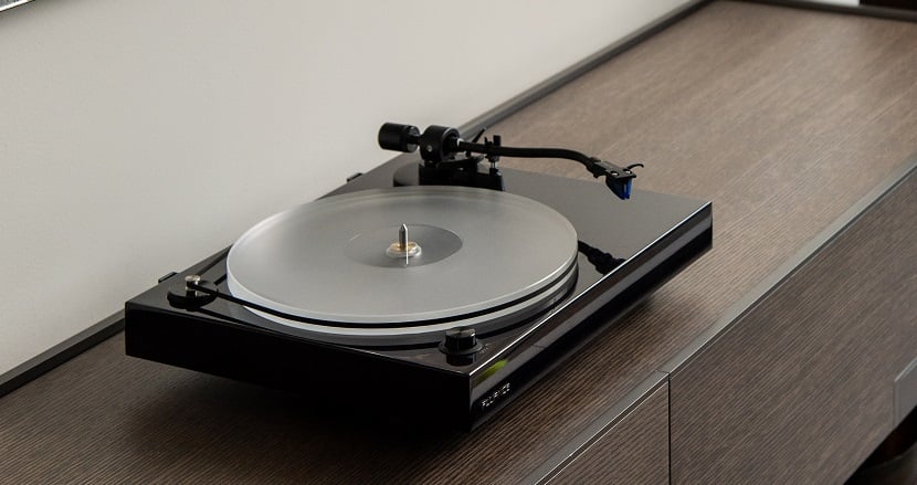

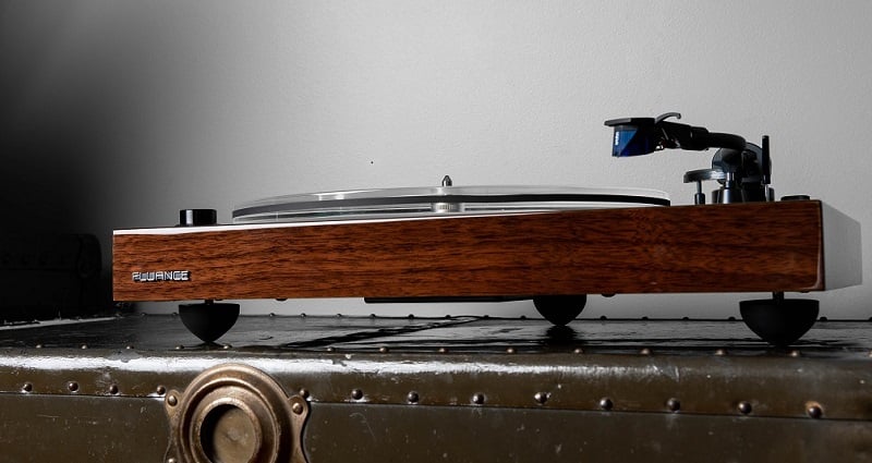

The Fluance RT85 Turntable comes in two finish options (black or mahogany pictured here)
The tone arm was already set up with a very well regarded Ortofon M2 Blue and the platter was sent in its own cardboard box inside a plastic non-static thin bag. I like the way Fluance put the installed cartridge on the headshell and adjusted it to almost perfection. It was a good call to protect the cartridge from damage when unboxing or during shipping. The cover is well constructed out of high-density acrylic but there is no platter mat included. This is not a big issue with me since I like to use my favorite brands of platter mats to my liking and I always recommend at least a cork and rubber mat to be added for protection of your beloved records for better isolation and performance. The setup does include accessories like the cover hinges, 45 disk adapter (plastic) and a few other additional items like RCA cables and two ground cables. It also includes an additional ground cable as a spare or to ground the amplifier to the phone state as I always do to help quite the floor-noise. Finishing of the set was an acrylic lightly smoked dust cover.
Everything is well laid out on and around the foam holders/protectors for the plinth. The belt for the RT85 is already fitted around the platter and can easily be installed around the motor with a simple pull and tuck behind the motor spindle.

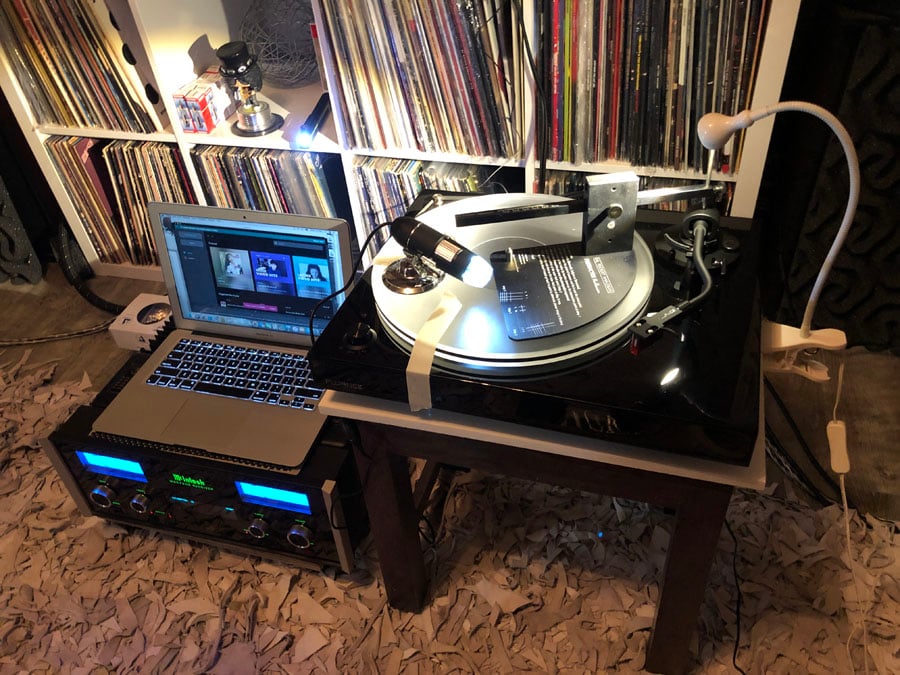

For testing turntables and related equipment such as phono stages preamps and step-ups, I try and keep it all as simple and moderately priced as possible. I also like to use as much tried and true and vintage equipment that has stood the test of time.
