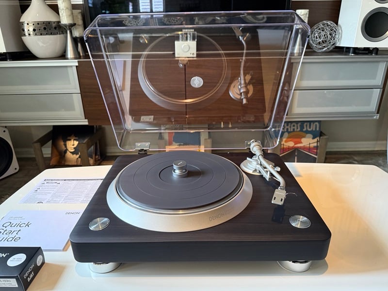

Denon DP-3000NE Turntable Introduction
The Denon DP-3000NE marks a triumphant return for Denon into the high-end turntable arena, reviving the legacy of its highly-respected, broadcast-grade predecessors like the original DP-3000 and my vintage, well-cherished DP-62L. The DP3000NE, with its improved tonearm design, motor, solid MDF plinth, and key upgrades, delivers performance that caters to seasoned audiophiles and vinyl purists alike. The new turntable from Denon has direct-drive precision, substantial damping control, and newly refined component architecture. According to Denon, the DP-3000NE is not just a nostalgia piece; it's a “meticulously executed analog playback instrument  .” In this review, we will look at key new features and redesigns, and look at the measurements given by the new design compared to a similar turntable from Denon (DP-62L) for comparison.
Denon DP-3000NE Turntable: Key improvements

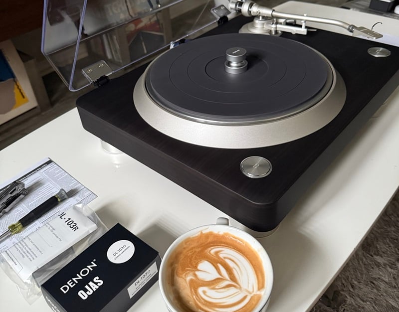

DP-3000NE  coffee
The Denon DP-3000NE is a statement piece with looks and rotational stability to satisfy the most demanding audiophiles seeking perfection in speed control and accuracy. The platform motor was largely targeting accuracy of playback with the newly redesigned system development. By choosing a new R&D (research and development) approach, Denon achieved a better mechanical target of 33.33 and 45 rpm. Targets to perfection.
Tonearm
The new “S” tonearm design is built from aluminum extrusion for most of its construction. An array of adjustment knobs and features is extremely easy to maneuver and is visibly well placed on the base of the gimbal. The anti-skate adjustment has numbers and hash marks printed on the turning knob. To adjust, simply rotate right or left to the desired number; next, push the knob inwards for engagement and pull outwards for disengagement. The new “horizontal” re-designed throw level for VTA (Vertical Tracking Angle) adjustment is smooth yet robust enough to hold all adjustment settings without being compromised by the weight of the tonearm or any external factors. Overall, a minimalist design involves fewer parts, better functionality, and smoother interaction when handling this beautiful new turntable platform.
Tonearm Enhancements

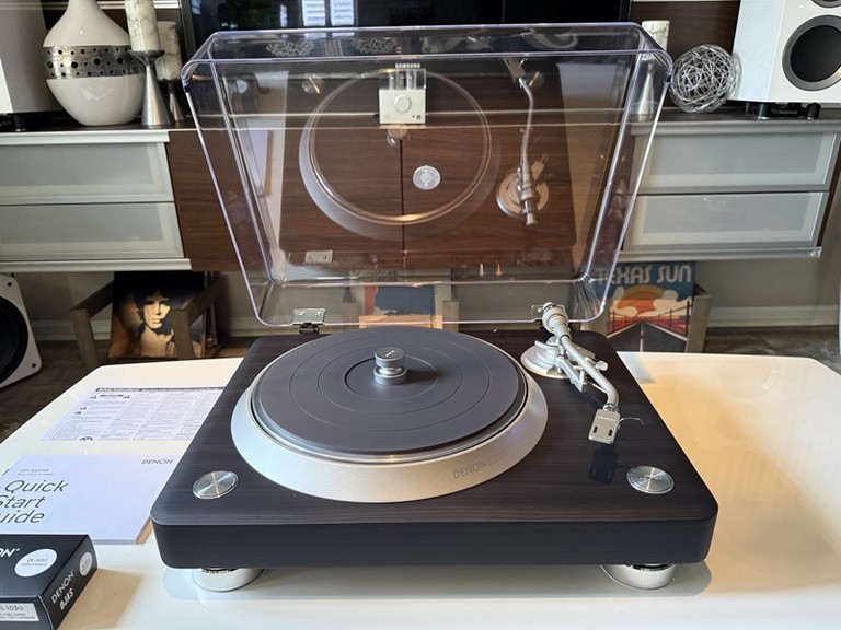

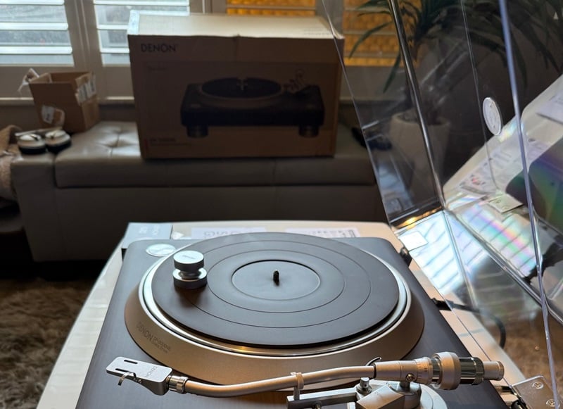

DP-3000NE  box
The DP-3000NE features a static-balanced S-shaped tonearm with a length of 244mm, offering both classic aesthetics and accurate tracking performance. Unlike earlier designs, such as the DP-62L, which required clever workarounds to accommodate heavier cartridges or resolve setup inconsistencies, this tonearm is robustly engineered to support a wider range of cartridge weights (4–26g with sub-weight) and provides a generous vertical height adjustment range of 9mm.
Tonearm Counterweight
With this new high-to-medium-mass tonearm design, you will get a wider and larger range of adjustability for most cartridge designs available on the market. The new counterweight design on the tonearm is outstanding on the Denon DP3000NE. The previous designs had a “three” separate counterweight feature of different weights to accommodate a range of cartridges of varied weights (light, medium, and heavy mass/compliance), but with this new single counterweight design, the counterweight slides back and forth on a longer shaft at a much greater distance. This new single-weight design accomplishes the same target and surpasses any previous tonearms made by Denon without the use of additional counterweights of varied weights. In my opinion, it also surpasses many other tonearm/counterweight designs. This improvement has been a welcome new feature lacking on previous Denon designs from the “DP” line of decks. The biggest accomplishment and best feature of this turntable.

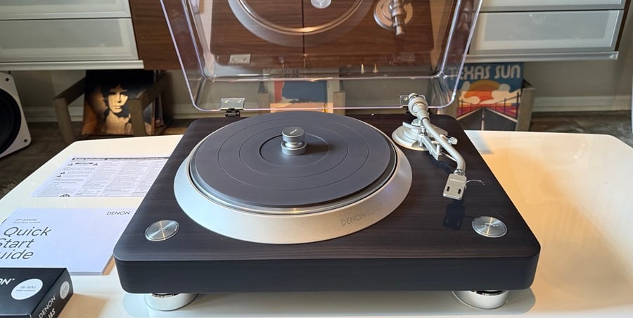

Platter
DP-3000NE
The new platter design has a new rubberized spray-on material applied to the underside of the platter to mitigate and control resonance. The new, thicker one-piece aluminum platter achieved this target and largely cut off most of the unwanted resonance transfer from the plinth to the stylus. The performance of the redesigned platter is a large leap compared to that of the Denon DP62L, a much older, thinner and “noisier” design. I used a measuring software test track for resonance (acceptable range of 8-12% resonance measurements) using my DP62L for comparisons.  The numbers produced by the new DP3000NE are much lower and more stable at a steady 9.22%. The Denon DP-62L measured 10.12%.
Power Supply/Motor Array
For the power supply, the motor features a combination space vector pulse modulation (rotational stability three-phase AC motor). This rock-solid, stable new design remains completely steady once it locks in the speed of 33.33rpm or 45rpm. The efficiency was tested by a resonance and speed-measuring computer software test on my turntable calibration equipment and test records, with tracks specifically tailored for speed and accuracy of turntable rotational motors. The DP3000NE delivered outstanding results, achieving perfect rotational speed stability in less than three seconds after the initial pressing of the start button — a very good indicator of fast rotational performance for greater accuracy of speed. Denon is no stranger to this, but with this new turntable design, it has now perfected and reached a new level of accuracy through the many improvements achieved by this new deck. This new design targets the demanding needs of the most accuracy-driven audiophiles looking for the most perfect turntable platforms. With the high standard allocation of 33.33rpm and 45rpm speed, the variations remained at “0” for “WOW” and “Flutter” on all my testing. Denon’s website literature also mentioned that the DP3000NE will remain at the constant speed of 33.33rpm or 45rpm even when temperature variations are a factor. This translates to very stable speed control, even if left running for over 24 hours continuously, with no consequences or compromises. This new overall design attained an innovative level of performance at a shorter time span and achieved a more accurate rotational speed with no variations at any temperature, nor any lack of performance in any demanding scenarios thrown at it even by the most seasoned DJ professionals relying on a balanced platform of speed and performance.

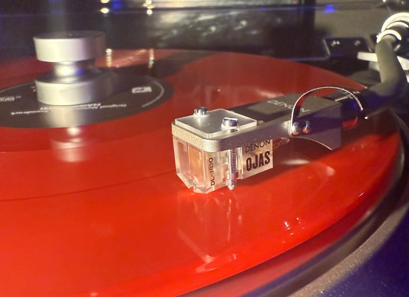

stylus
Along with a solid MDF plinth chassis, one of the most well-received enhancements is the mechanical smoothness and overall tactile accuracy during setup. Tracking force adjustments are now clean and consistent, while anti-skating and azimuth alignment operate with precision. A visible improvement is the use of an aluminum head-shell, not only for structural resonance control but also for aesthetic harmony.

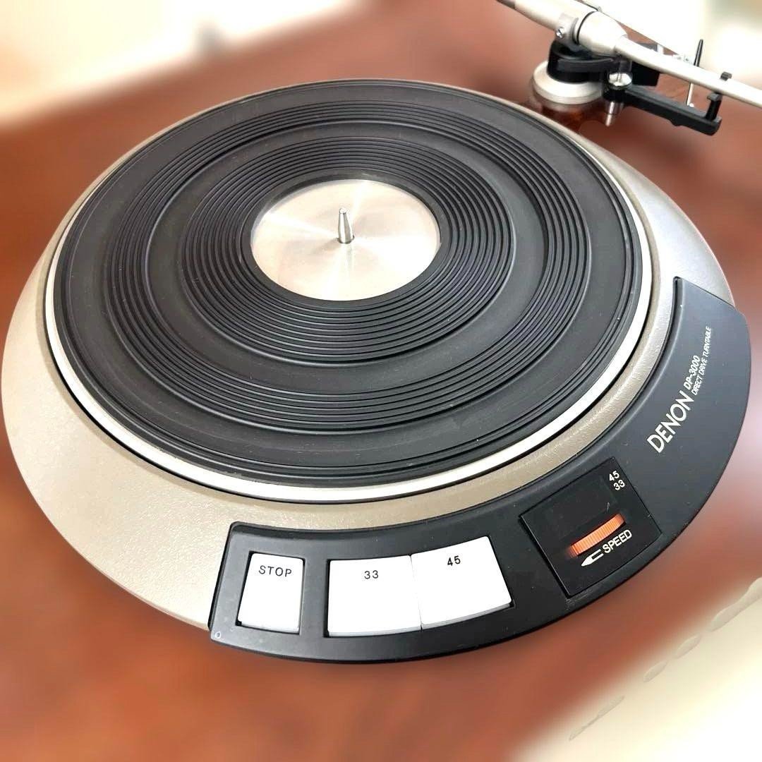

Denon DP-3000The original Denon DP-3000 was released in 1972 and became a cornerstone in the evolution of professional turntables. Introduced first as a motor unit intended for direct mounting in broadcast plinths or custom enclosures in broadcasting stations, it was later offered in more consumer-friendly formats: the DP-3500, which included a factory plinth and dust cover, and the DP-3700, a fully integrated system complete with tonearm. These platforms quickly earned Denon a place of honor in both professional broadcast environments and the homes of serious audio enthusiasts at the time in Japan. But Denon’s journey began much earlier. The company was founded in 1910 as part of Japan’s Nippon Columbia Company (Nippon Chikuonki Shoukai) by Frederick Whitney Horn, an American entrepreneur. Denon emerged as a leader in the development and manufacture of audio and recording technologies that would go on to shape Japanese broadcast standards for decades. Denon quickly became synonymous with precision, engineering discipline, and commitment to high-fidelity playback.
During the early 1970s, Denon was deeply involved in developing direct-drive motor platforms. At the same time, Technics — another major player in the Japanese HiFi world — introduced the SP-10, which evolved into the now-legendary SL-1200 series. While Technics gained dominance in DJ and club circles, Denon’s focus remained firmly on the studio, broadcast, and audiophile spaces, crafting tools for critical listening and reference-grade playback. Its broadcast decks were considered the standard by which others were measured.
The earlier release of the DP-3000 and DP line signaled Denon’s move from professional installations into the growing high-end consumer market, a space that would blossom during the 1980s, often regarded as the golden age of HiFi and vinyl. The retro synth-pop sound of that era, the birth of MTV, and a cultural fascination with analog sound created the “perfect storm” for Denon to rise to prominence, not only in Japan but worldwide.

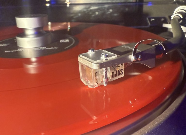

  • Denon 103r MC and Denon 103o OJAS MC (same sample units with different cartridge body color “black” and “clear” for the OJAS, newly released May 2025)

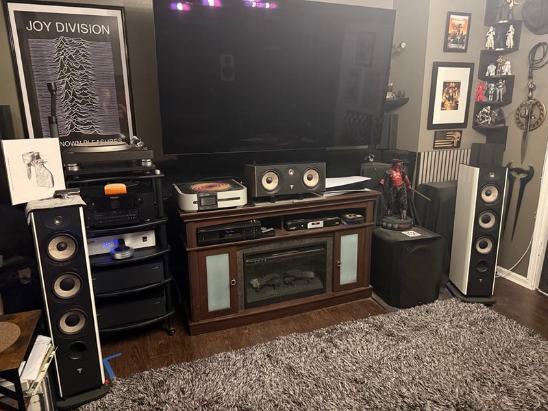

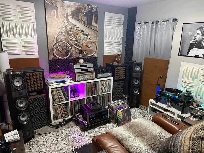

Room 1 – Theater Room (Acoustically Treated)
room1
Description: This acoustically treated theater room utilizes Focal Aria 226 tower speakers with support from three SVS PB-2000 subwoofers (one in the front and two placed behind the listening area side rear corners for balanced bass distribution. Source signal passes through a Pro-Ject Phono Box DS3 (up to three turntables can be connected at the same time for A/B testing) via a Denon DP-62L Vintage reference turntable used for A/B testing, to a Marantz AV7705 preamp, followed by a Classé CA-200 hybrid amplifier, with Kimber cabling ensuring signal integrity. The room features an anechoic design approach: 4” thick absorption panels line the front wall and side walls directly next to the speakers. Diffusion panels are placed at sidewall reflection points to preserve spatial cues and a wide soundstage. The ceiling includes a combination of diffraction and diffusion panels to address vertical reflections. Behind the listener, a matrix of absorption and diffusion panels—also extending to the rear corners—controls late reflections and eliminates echo buildup.
  • Size: 15’ L x 13’ W x 8’ H
  • Space Type: Dedicated theater room
  • Room Treatment: Extensive absorption and diffusion in all critical areas: front wall, side reflection zones, rear wall, and ceiling. Anechoic-style control.
  • Distance from Back Wall: 45”
  • Distance from Side Walls: 2’5”
  • Height from Floor to Tweeter: 40”
  • Listening Position: 5’ from the rear wall behind the listening position
Room 2 – Dedicated Stereo Room (2-Channel Bedroom)
room2
Description: This fully dedicated two-channel stereo room utilizes Focal Electra 1028 tower speakers with support from one rear REL S/2 subwoofer behind the listening seat (only one dedicated listening positional seat is present in this room) and two SVS SB3000 Subwoofers calibrated using SVS QE adjustments on the SVS app. The source signal passes through a Pro-Ject Phono Box DS3 when doing A/B testing with my VPI Prime 21 reference turntable. The phono pre-amp is connected to a Feliks Audio Echo Mk 2 OTL tube headphone/pre-amp, then to a McIntosh MAC 7200 as a preamp connected to a Primaluna Prologue Premium Integrated tube Amplifier, with Kimber cabling ensuring signal integrity.  All testing is done with tested matching tubes that measure at the top numbers for accurate representation and sonic fidelity. The Room has been carefully treated and acoustically calibrated using REW software. The room displays an anechoic character due to the comprehensive use of acoustic materials. Absorption panels are installed on the front and rear walls, with additional panels positioned directly beside each speaker. Diffusion panels are placed at the side reflection points toward the listening position, preserving imaging and dimensionality. To combat a persistent standing wave, the front wall side edges are treated with high-frequency diffusion and absorption. Above the listening area, a combination of diffraction and diffusion elements mitigates ceiling reflection buildup. Further ceiling diffusion ensures smooth vertical decay across the mid and high frequencies.
  • Size: 13’ L x 11’ W x 8’ H
  • Space Type: Dedicated two-channel stereo bedroom (fully calibrated)
  • Room Treatment: Anechoic with a tailored combination of absorption, diffusion, and diffraction throughout all reflective planes.
  • Distance from Back Wall: 41”
  • Distance from Side Walls: 20” with absorption near the speaker walls
  • Height from Floor to Tweeter: 35” to Beryllium tweeter
  • Listening Position: 45” from rear 4” absorption panel with additional side diffusion near corners
