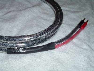

When I initially peered at the specifications of this cable on their website, the inductance to capacitance ratio didn't seem quite right. Not surprising, when I actually measured the cables I found the inductance to be about 14 times higher than their spec (a measurement which was still incredibly low) and the capacitance to be about 3 times higher than their specification. I was glad to see them update their website with the correct specifications based on my measurements. It is not atypical for cable vendors cable specifications to be inaccurate for the reasons previously mentioned. In fact I have found a great bulk of the cable vendors in this review to be a bit off on their cables, but most of the cables still measured extremely well and this was only mentioned for academic purposes.
Features & Style
In any event , the AViC cable is certainly an interesting one. Its shiny silver wrapping reminds me of a disco-tech style look from 舠 Saturday Night Fever 舡 or the evil Cylons from Battlestar Galactica. They were cool looking and could certainly dress up any high end system quite nicely. Their banana connectors fit snugly and they appeared to have no problems making a nice solid connection with several brands of speakers that I tried them out on. The only potential downside was that the AViC cable banana tends to stick out a tad too far when connected to equipment.

We start with four of our ChonoSync conductors, each protected by AViC Involution shielding. The conductors are helically wound end to end, resulting in a cable that has incredibly low inductance, resistance and capacitance. To put it in other words, the cable is "invisible", as if the signal travels directly from the amplifier to the speaker. You will hear everything you should, and nothing you shouldn't.
We certainly cannot argue with these statements since I did not rip apart the cables to examine the shielding, but based on my measurements, they truly were a low inductance cable as they claimed while the capacitance was also equally low and impressive. Usually, low inductance cables tend to be high in capacitance based on the conductor spacing ratios. This cable reminds me of a Star Quad configuration which is popularized by many DIY gurus. It is certainly a valid method for producing a cable with reasonably low inductance and capacitance and reduced RF immunity ( not typically a real world problem for most environments).

Overall, we found the AViC cables to be attractive, fairly well measured and not too caught up in snake oil hype. As for improvements, perhaps AVIC would consider offering a compression banana plug in their future cables for a minimal cost addition. This cable is certainly worthy of a top notch termination.
