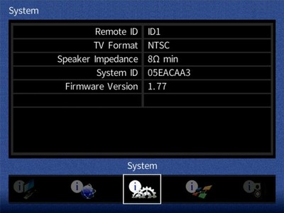

Immediately after reading Yamaha's firmware update instructions, I knew something was different. Typically updates are done from the setup/information/system menu, but Yamaha requires that this update be performed from the advanced setup/firmware update menu (shown above in Figure 1). I believe the reason for this strict procedure has to do with the HDMI 2.0a firmware update that is applied to the HDMI chip set; the advanced setup mode is the only way to ensure that none of the unit's input/output ports are active, which in turn guarantees the HDMI ports are not powered while the new firmware is applied (which ultimately means you only have the front panel display to navigate). Once the update is completed, you can then go into the setup/information/system menu (Figure 2) to verify the correct firmware version (1.77).
Figure 2. Latest Firmware
