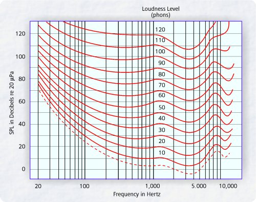

loudness curvesOn a more practical level, we often wonder how amplifier power output in watts relates to changes in the acoustical output (loudness), of loudspeakers. Now for the really amazing part: although it seems that doubling the amplifier power in watts would also double the loudness, disappointingly it only increases loudness by 3 dB, a change in volume most of us perceive as “slightly louder.” That’s why going from an amplifier of 75 watts output to one of 150 watts output only increases the actual acoustic output a bit—again by 3 dB. To make sounds subjectively “twice as loud”—an increase of 10 dB—requires ten times as much power from the amplifier. So if your speakers are using 5 to 10 watts (a fairly typical value) to produce reasonably loud sound in your average-size room, and you want to make your music twice as loud, you’ll need ten times as much power, or about 50 to 100 watts. That’s why it’s important to have plenty of reserve power in your amplifier/receiver to handle the peaks in loudness that may be at least 10 dB louder than average levels. In fact, I have a classical CD recording where the loudest portions of the music are almost 30 dB louder than the quietest passages. Think about how much amplifier power that requires cleanly reproducing the 98-dB peaks in my 2,200 cu. ft. living room. Bring on the Axiom A1400-8!
Most of us have seen the charts that document the relative loudness of various common sounds—rustling leaves, 10 dB; a very quiet library, 30 dB; average conversation, 60 dB; street traffic, 85 dB, a full orchestra, 98 dB, and so on (see decibel charts). But it’s fun to actually measure the relative loudness of various types of music heard live; moreover, it’s amazing how accurate even an inexpensive sound pressure meter is, and how closely the values relate to our subjective perception of “quiet” and “quite loud” music and to universally measured sound pressure levels.
