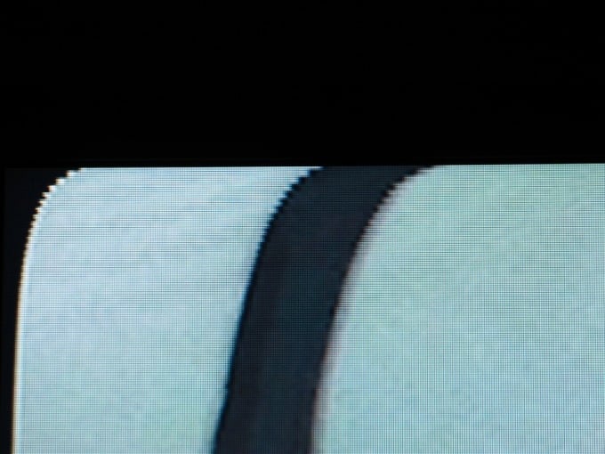

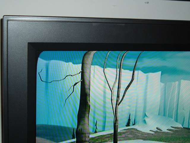

Back in October we reviewed the Syntax Olevia 542i LCD. While overall we gave the display a positive review, we noticed that with certain DVDs, the top of the picture would “tear” or be skewed to the right. Over Black Friday (the day after Thanksgiving) in some markets there were heavy discounts on this and other Olevia displays. Soon after we started receiving report after report of customers having the same problem. We have contacted Olevia about this multiple times but have still received no response. A fellow audioholic, Ken Phipps, sent us a detailed report. It seems that not only did he buy the set, but so did his brother. Between the two of them, they tested a number of different movies, DVD players, and input configurations. We are reprinting part of his report with his permission:

I've seen this happening with a fairly wide range of DVDs (movies and TV shows). I have attached an image of the screen from the "Ice Age 2" DVD that shows the 'curve' problem. I've also seen this on the 'Ghost Hunters,' 'Curb Your Enthusiam' and 'South Park' DVDs.
This seems to be the consensus from the reports we have received. The tear exists. Depending on which player you have and what type of input you use the problem may or may not be fixed by switching the player to “progressive”. our tests we noticed that there were many more films that were experiencing the problem but that, since they were letterboxed (black bars on the top and bottom), the “problem” was hidden in the black bars. The tear issue seems to be confined to the component inputs as all reports have stated that switching to s-video or composite fixes the problem. We’ve also had reports of the same issue on the 537h so it doesn’t seem to be confined to the just the 542i model. While we suspect that Olevia’s unresponsiveness to this issue is due to the fact that it is sporadic in nature and only affects a small subset of owners. We have subsequently pulled our recommendation of this display and hope that future models will have this problem addressed.
