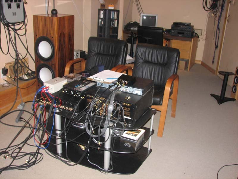

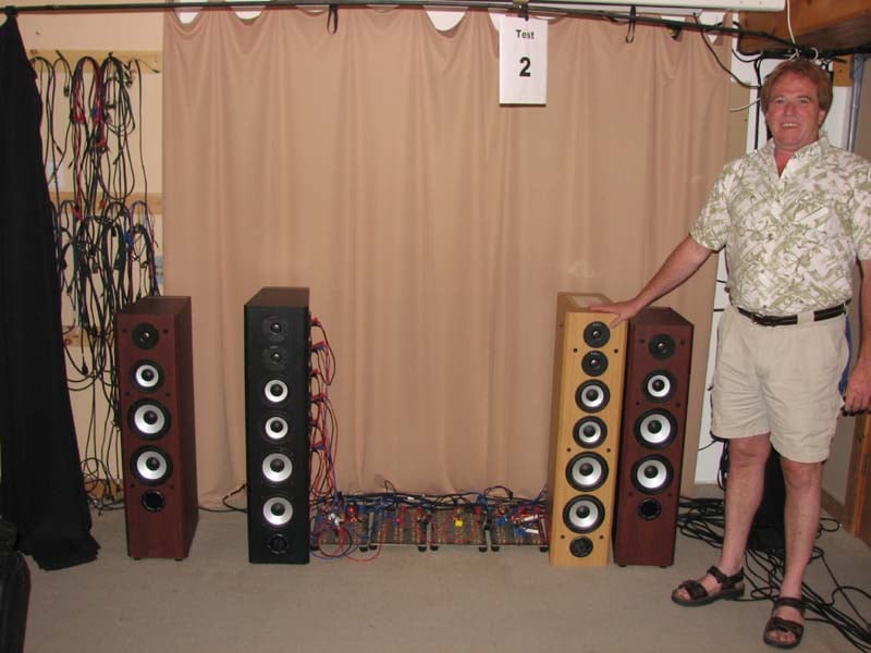

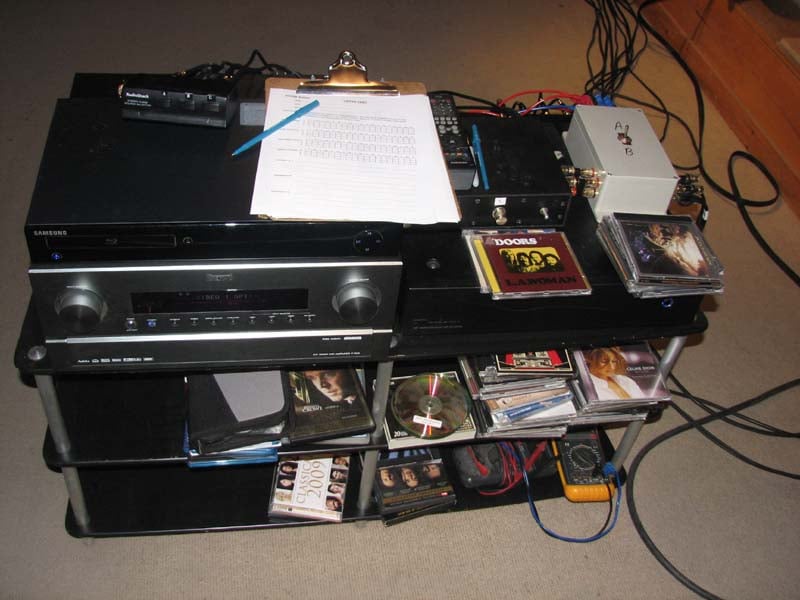

This years’ visit to Axiom brought about their announcement of their new V3 series of loudspeakers and running me through their blind listening test.I was seated in a smallish rectangular room (20' x 15') with low ceilings (8ft) and walls constructed of cedar.  There were no passive treatments in the room other than furniture, but the room didn't really need any.  It had a very lively, but not over echoey, sound characteristic which in my opinion provided a great environment to discern spaciousness while still having a very warm and cozy feeling to it.  There were two listening seats available and I chose to sit in the middle seat which was dead center to the front wall where the speakers were hidden by a loosely draped black grille cloth. In front of me was a Sherwood Newcastle Pre/Pro, Axiom A1400-8 amplifier, a Panasonic Blu-ray player and an Axiom made switch box.  The switch box had a series of potentiometers for level matching and an A/B/C selector switch to compare up to three pairs of speakers at a time.  Ian instructed me that they alternate the left/right speaker pairs (similar to how we do it) to ensure proper placement and distance to the listening area as follows:
Left Speakers                                       Right Speakers
AB                                                           AB

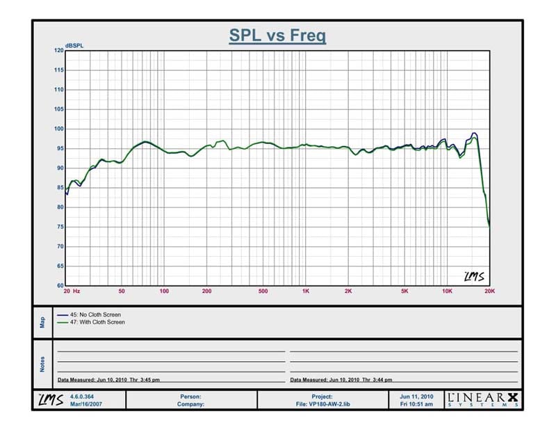

Axiom Frequency Sweep
Blue- no grille cloth; Green - with grille cloth
I asked Ian about the losses I experienced (-2dB) using speaker grille cloth at our last floorstanding speaker face off and he informed me that they went through great lengths in designing less lossy grille cloth which they've measured a net loss from 20Hz to 20kHz of 0.7dB (0.5dB at bass frequencies, 1.2dB at high frequencies).  As you can see in the measurement above, their grille cloth (even loosely draped) is very transparent.

axiomroom2.jpgI was pleased with this setup, especially since I was the only one sitting in the room and had as much time as I needed to do the listening comparison.  I was encouraged to bring in my own source material so I compiled a selection of high quality recorded music I am most familiar with and burned it onto a CD.
I loved the fact that Axiom provided the listener the ability to flip between speaker pairs under test at will while also being able to adjust master volume keeping both pairs under test level matched at all times. Basically the entire listening session is under user control which helped greatly to reduce testing biases.

The Axiom Scorecard
I must admit upon first glance of the Axiom scorecard (see attached) I thought it was rather too simplistic only evaluating bass, mids, treble and overall sound quality.  But then things clicked.  This did make a lot of sense.  Axiom was following the KISS (Keep It Simple Stupid) principle to not overwhelm or confuse its listeners.  For those wanting to rate the soundstage/imaging characteristics, this could be lumped into the "overall" rating row.  I liked that they used a 20 point scale as we've found a 5 point scale doesn’t have enough resolution since its really a 3 point scale as people rarely use the endpoint #s when rating product performance.  Ian told me that the scorecard is certainly an important metric but he focuses more on the listeners’ comments than he does on absolute ratings.  This makes a lot of sense, especially when trying to correlate the ratings with the comments.  Going forward we will also adopt a similar scale and  format to what Axiom is using.

axiomroom.jpgSo there I sat listening to two unknown pairs of speakers in a cozy and acoustically pleasant listening room with my own music.  I felt liberated being able to switch and adjust listening levels at my command.  I took notes on what I was hearing and only entered results into the scorecard after extensive listening and comparing between the two pairs of speakers under test.  In the end I found this listening comparison to be quite enjoyable.  I found strengths and weaknesses in both pairs of speakers I was listening to and it was nice to know I wasn’t being biased by visual or brand preferences when making my assessments.
After about 15-20 minutes of testing, I turned in my scorecard thinking I was done for the day.  I was wrong.  Ian had another test lined up for me.  This time I had to flip a different switch box for the comparison.  I proceeded once again with my trusty reference CD. Within minutes, it was apparent to me that I was listening to the same speaker.  Thus I didn’t fill out the scorecard but noted that both speakers were one in the same.  Ian pointed out I was correct for the most part but there was a difference.  The speakers under test were a pair of their own M80s.  This listening session focused on if I could detect audible differences of their stock crossover utilizing steel laminate cores vs an upgraded crossover utilizing air core inductors.  At times I thought I could hear a difference but I couldn’t identify my preference with any high level of confidence.  Thus I asked Ian if we could remove the grille cloth just incase its losses were masking the audible differences.  He obliged but didn’t tell me which setting on the speaker switch box corresponded to the upgraded crossover.  My experience with the cloth down didn’t change much.  I was still unable to hear a difference.  Ian and I have had on going debates over the years on the merits of using higher quality crossover parts.  This test basically proved I was unable to hear sonic differences of higher end crossover components utilized on Axiom speakers in that particular listening environment.  This however doesn’t discredit using the best quality parts possible as much as it pays tribute to Axiom for executing good crossover design using less expensive parts.  Kudos to Axiom!
