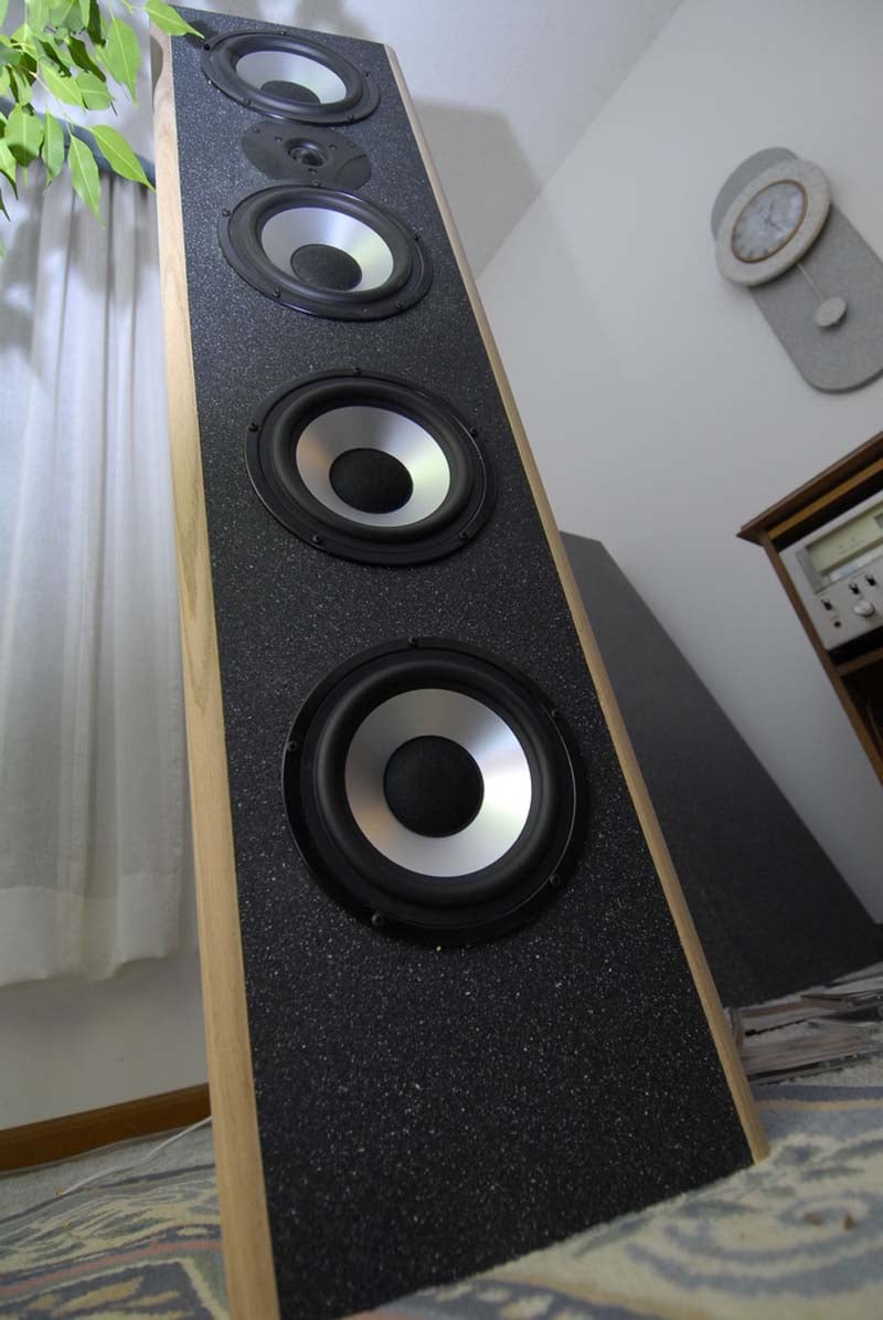

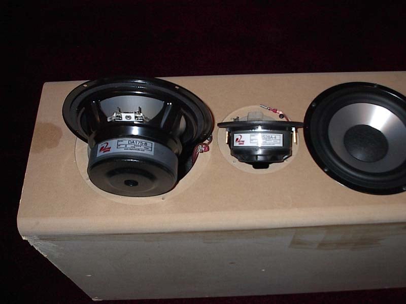

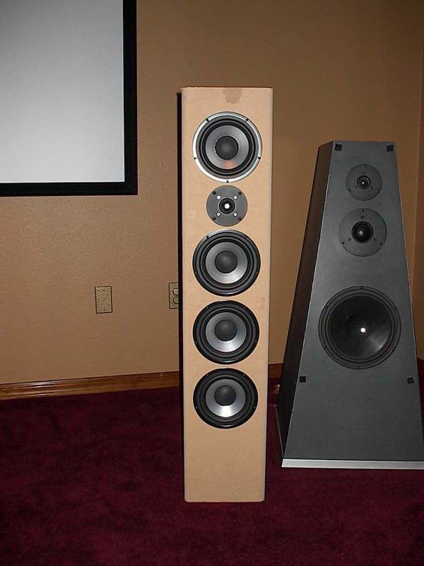

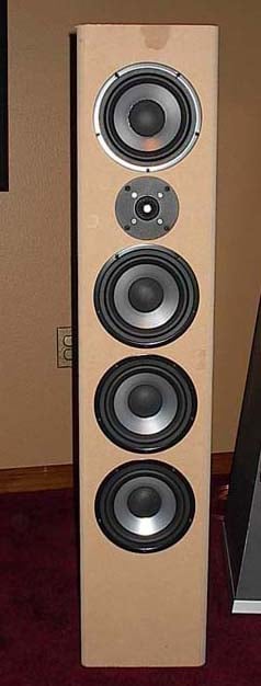

Picture 005.jpgThe Schumakubins are a floor standing speaker with a WTWWW (woofer-tweeter-woofer-woofer-woofer) configuration. The four 7 inch woofers and the 1” dome tweeter are aluminum from Dayton which is a Parts Express only brand. They are all fairly low cost drivers and in the past I personally would not have considered them but once I saw the distortion plots for these drivers I was very impressed. The tweeter is from the Dayton Reference Series but the woofer is not. In fact the woofer is only made from a stamped frame meaning it is not as rigid as more expensive cast aluminum frame drivers. This system is a 2.5 way design where the lower two woofers are the .5 way. They are cut off at a lower frequency than the upper two and are used to compensate for baffle step loss (when the wave front goes from half space to full space). This techno-babble translates to a smoother overall bass response. The crossovers were designed using free software that was written in an Excel spreadsheet. I have personally started experimenting with this software and it seems fairly robust. To use it you need a pretty good understanding of each crossover section. Pete has used it for several of his own designs and other DIYers via the forums. I have comparisons with the modeled plots and the actual measurements which you can see at the end of this article.
im0005834.jpgThe design is very versatile. If they are built completely from scratch the drivers can be configured a few different ways. The cabinets can be ported or sealed depending on the desired bass response. The pair that Pete sent to me was sealed. I also told Pete not to put an aesthetic finish on them because I was more interested in their performance and the finish is completely up to the builder (no kit options as of this writing offers any aesthetic finish). It does make sense to mention their profile though. They are narrow and tall and there is no flexibility for the builder on the baffle width because it is part of the crossover design. To change the width would change the sound. Any speaker builder knows that the hardest part of building a speaker is cutting a perfect hole with a recess. One of the coolest options for purchasing this kit is that just the front baffle in the kit can be purchased with precut holes. The builder is only left to build a rectangular box, put it together and then put a finish on it. The front baffle if purchased is 1 inch thick and the recesses and holes are perfect expspeaker.jpgbecause they are cut on a CNC machine. When I installed the drivers they fit in their respective holes with ease. If you are new to speaker building do not under estimate the value in purchasing the precut front baffle. I have built many speakers with recessed holes and I usually spend a full day just cutting holes. By the way, the recess is a must in any decent quality speaker because without it there will be ripple diffraction. You only have one chance of getting the recess right and you need a plunge router and a good circle jig to do it. Once the main hole is cut after the recess I don’t know of any way to fix the recess if it is wrong; if you do please let me know. Two sizes of the baffle are available, one for a sealed box and one for a ported box. If all pieces for the full kit are purchased it is important to know that they are also cut from the CNC machine and that the joints are rabbeted. This means that all the pieces fit together well to make assembly easy. I was not concerned about the aesthetics but I did take a good look at the cabinet’s construction. Pete built this pair himself but he built it just like the complete cabinet that is available as an option. It had sufficient bracing and it included fiberglass plus some foam on the walls which eliminated internal reflections.

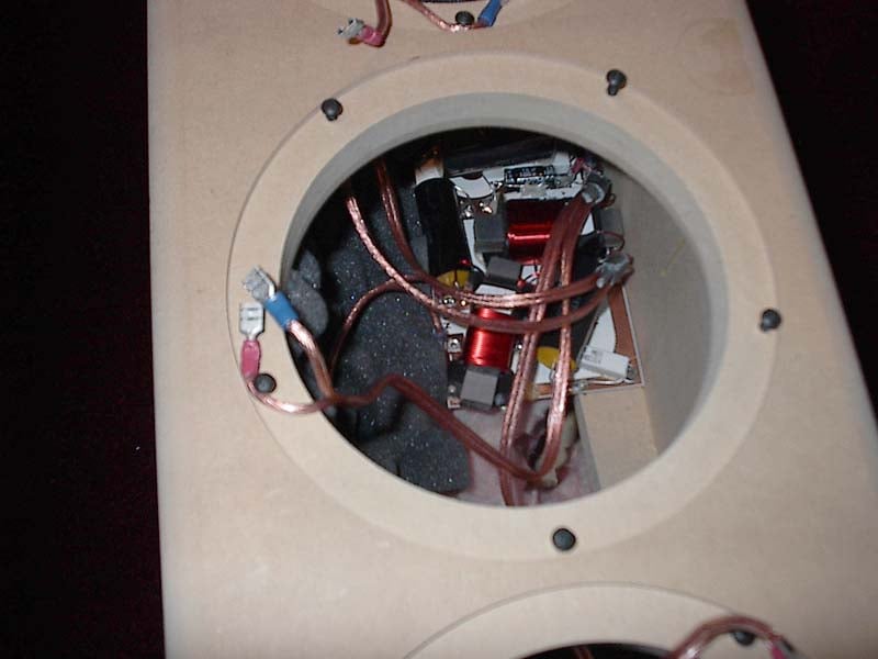

Picture 008.jpgThe crossovers were not much to look at because Pete threw them together for the review. He had not yet arranged who would be building them for the kit. Of course the design of the crossover is a different story. As was mentioned before they were designed around the front baffle shape and size and these particular crossovers were designed for this baffle/driver layout. So although different driver layouts can be done, a slightly different crossover design would be needed which I’m sure Pete would make available. I was a bit surprised to see iron core inductors in these crossovers; higher end speakers use air core inductors with heavier gage wire to keep the dc resistance low. The iron core inductors have a hysteresis which gives a non-linearity and might explain some of the missing detail I talk about later. If the crossover is built instead of bought then the inductors can surely be upgraded.

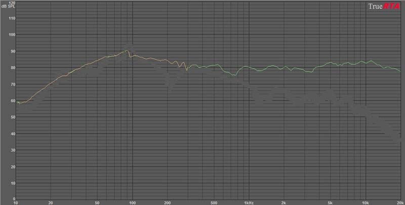

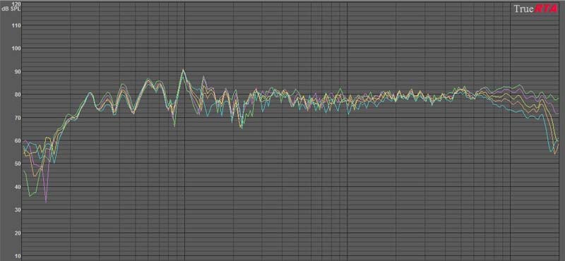

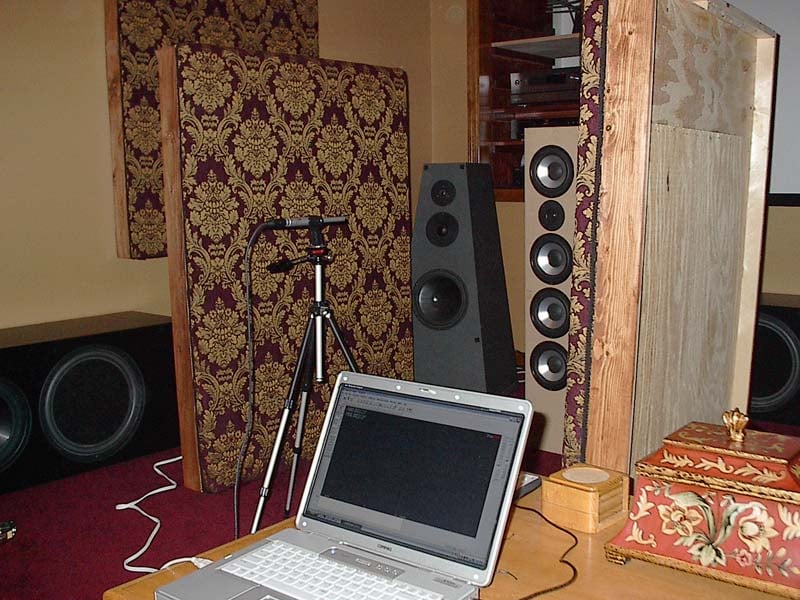

IM000585.jpg After gathering proper equipment over time to build my test system and using a semi-broken microphone for a year (it finally died after the measurements became more and more inconsistent) I was finally able to make some good speaker measurements using TrueRTA on my laptop. I took my sound panels down and placed them near the speaker under test to eliminate any reflections from the mid frequencies and up. The bass response still interacts with the room for the measurements. My pyramid speaker was actually behind the testing area.

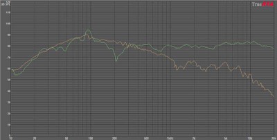

This first plot was taken using the Quick Sweep in TrueRTA with 1 watt at 1 meter. Keep in mind that the room’s effects are present below 300Hz. Smoothing was applied to all the plots to aid in visualization.
In-room Frequency Response (1 meter)

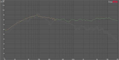

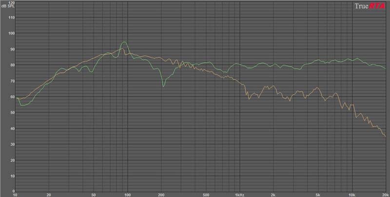

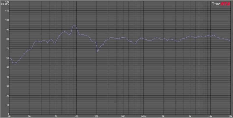

In the next plot the near field measurement was added (orange curve) to eliminate the room’s effects. The green curve is the same as the sweep above. You should look at the near field measurement (orange curve) up to 300 Hz and then follow the green curve from 300 Hz and up which gives a fairly accurate response of the Schumakubins.
Nearfield Frequency Response
The best I could do to truncate and merge these curves to give a better picture was to airbrush the curves out in Paint. It is a bit crude but I think it helps in seeing the plot better. You can now see the shallow roll off as a result of the sealed box design. As mentioned before a ported version could be substituted.
Combined Nearfield Frequency Response

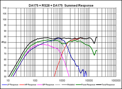

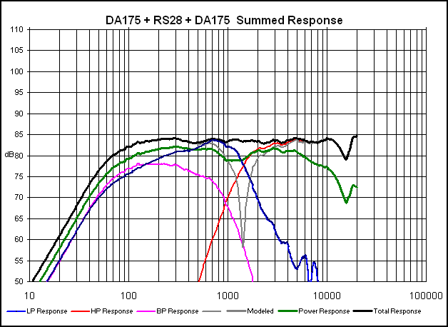

Here are the plots generated from the crossover design program for comparison.

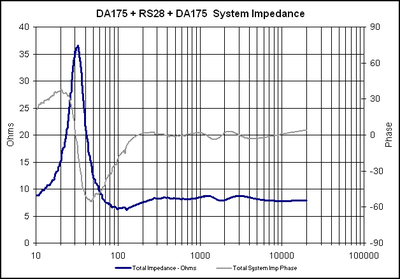

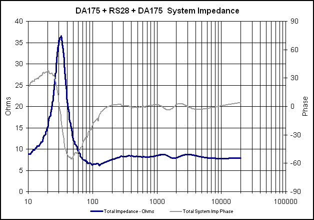

Here is an impedance plot of the drivers from the crossover program.
