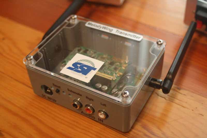

MelodyWing-transmitter1.jpgTo give you an idea of just how much of a preview this was, the wireless transmitter and receivers came in a case with clear acrylic tops so that manufacturers could examine the component utilized within. Personally, I'd consider rounding off some edges and calling it a finished product... almost. It's at least a cool idea and I haven't seen too many "peek under the hood" products except for tube amps with half of their parts hanging out for show. One advantage to the acrylic tops was that I was able to note they utilized quality components and the power supplies were fairly robust compared to the scant amplifiers I've seen in past attempts at wireless systems. The onboard digital amplifiers are rated to 24wpc in stereo, or 48wpc mono. The amps automatically sense the attached load and will bridge the output for a mono signal to each speaker (which is how we utilized the system in our demo.)

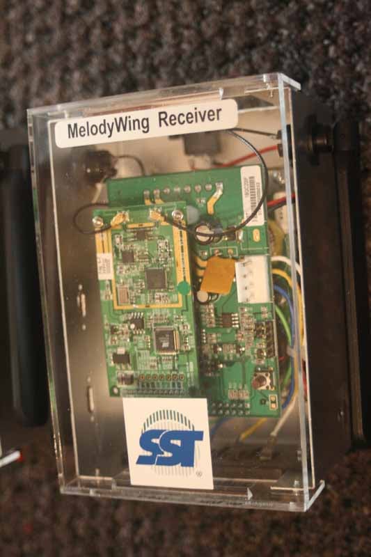

MelodyWing-receiver3.jpgThe package came with one SST18SC03 transmitter with line inputs and two radio receiver modules with speaker-level outputs and built-in Class-D amplification. All modules require DC power (12VDC for the transmitter and 24VDC for each receiver). The antennas are omni-directional and custom made for the Melody system, but even they can be customized by a  manufacturer if desired. Provided you don't have the antenna's touching metal and you're not trying to transmit from inside of a refrigerator they have an exceptionally good range. SST claims up to 50m, less if you are utilizing the systems in separate rooms with walls.

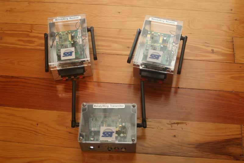

Setting up the system was very easy. The transmitter connected to my source - in this case a Marantz PM-11S1 integrated amplifier's preamp outputs - via a stereo RCA cable. I located the receivers in another room and connected each to an RBH sound Signature 61-SE/R loudspeaker. These speakers have a sensitivity of 87dB @ 1W/m and, while not terribly inefficient, are not the easiest speakers to drive. There was a drywall-over-plaster wall in between the rooms and the doors were closed during the listening/transmitting sessions. With this configuration, each speaker was receiving 48wpc Class-D amplification.

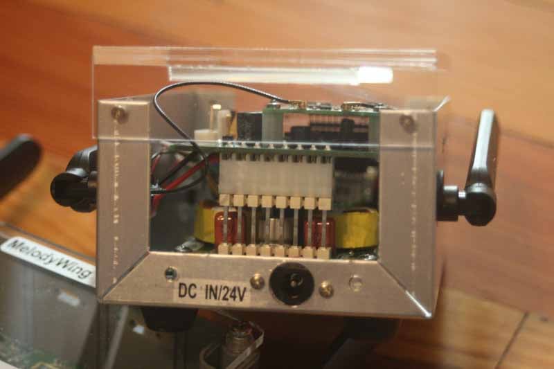

MelodyWing-amplifier.jpgAs we mentioned, the system is somewhat flexible, with 19 channels and dual-band support that can jump between 2.4GHz and ~5GHz without skipping a beat - literally. Line level outputs can be substituted for speaker level outputs by the manufacturer and a third receiver module can be utilized to create a system that also handles a wireless subwoofer. The MelodyWing wireless system is also capable of transmitting digital (S/PDIF, for example) signals which its digital amps can then decode, performing digital-to-analogue conversion after the wireless transmission. A unique handshake mode between transmitter and receiver also means that the system can be used with other systems for a greater level of interoperability not seen in many wireless products of this nature. Manufacturers will take these capabilities and determine a final shipping product.
