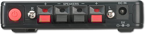

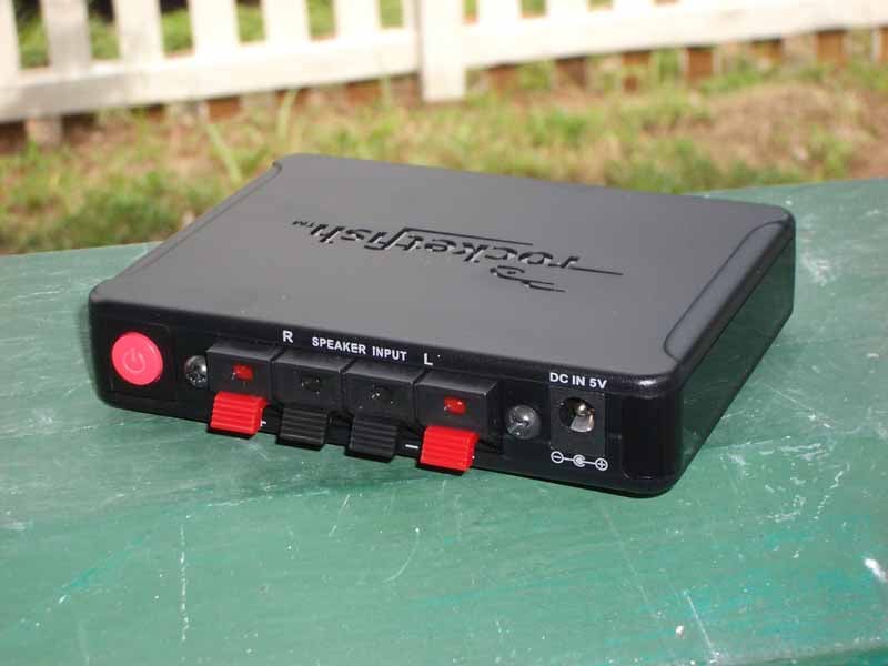

to complain. The transmitter unit is about the size of a couple deck
of cards laid side-by-side. It's powered by a 5VDC adapter (included)
and weights almost nothing. You feed the speaker-level inputs to the
plastic spring clips of this unit via the included pair of 24-inch
~20-gauge speaker cables. The box feels cheap, but so do most

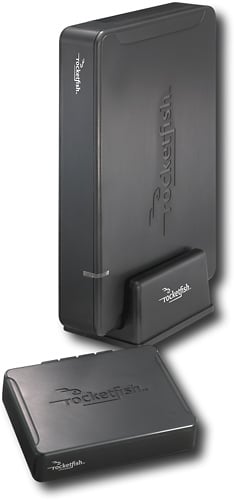

The receiver unit is where the “magic” happens. This box is larger, about the size of medium-sized hardback book and features the same spring clips (this time for speaker-level outputs) along with a volume dial and integrated power cord. Both units have red power buttons and the receiver has a large LED on the front that shows when it is powered on. While the transmitter is meant to be set on top of a table or your AV gear, the receiver can be oriented horizontally, vertically (using an included stand) or even wall mounted.

were included. I also quickly realized that no terminated speaker
cables were going to stay in the cheesy plastic spring clips for
long. Bare wire is your best bet. As long as you match your right and
left you should be fine during this step.

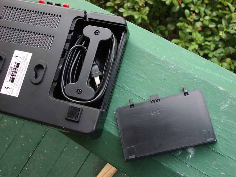

the speakers are connected, plug the unit into the wall (the cable is
cleverly storable within the unit itself and you don't have to remove
all of it if you're only going a short distance), power it up and
