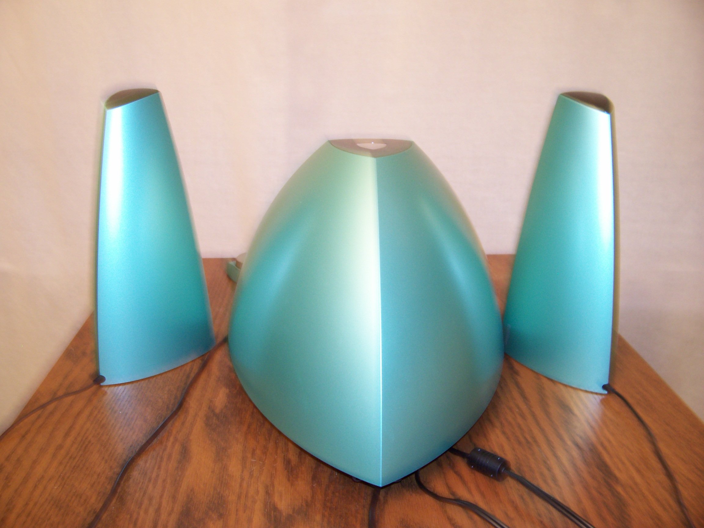

Edifier's lifestyle E3350 is definitely a nice looking set of speakers. Visually unique and available in seven colors (black, blue, gold, green, pink, purple and silver), this system would fit into to any post-modern décor. Opening the box you are greeted by seven plastic-wrapped items. Simply opening and plugging in is all that you need to do. However, for those who are completely technologically impaired, directions are included on one of the flaps of the box. Opening, assembling, and turning on takes a mere five minutes; ten if you are distracted.

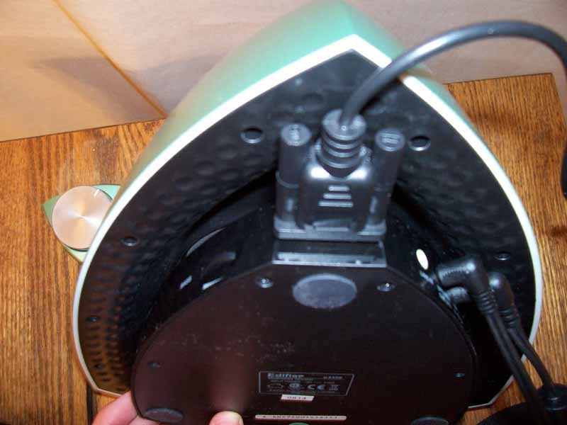

Included in the E3350 system are your standard 2.1 speakers; two satellite towers (each handles up to 9W) and one sub (RMS power rated at 32W) are encased in a uniquely shaped, pyramidal type enclosure. The audio out/input jacks, wired remote, and power cord all plug into the back of the sub. The subwoofer, a down-firing, 5 1/2" driver, is the centerpiece of this system.
Though simple to assemble, for those whose fingers are larger than others, you may find it somewhat of an annoyance tightening the screws of the wired remote to the back of the subwoofer. No tools are required for assembling this system; however, a small flathead screwdriver makes things a little easier.
The dull finish on the subwoofer is a very nice look when fresh out of the box; however, after setting up the system, you will find a slew of finger prints. The prints will fade with time, but will not return to the original shine, unless you do some light buffing and dusting after setup. I would suggest wearing gloves when setting up this system.
Once all of the cords are connected, just plug in the included 3.5 mm jack into your audio source. Press power (on top of the subwoofer) and enjoy.

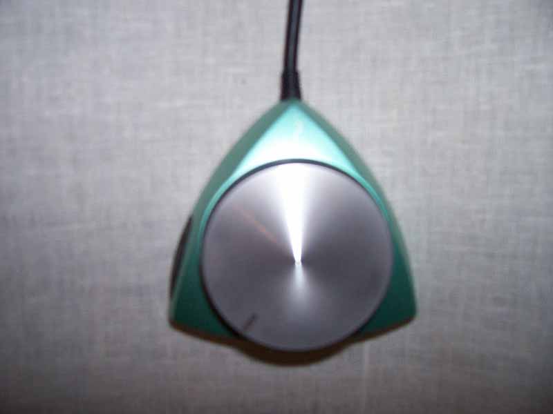

Volume is adjusted by a wired remote which features a metal dial with one little notch to indicate volume. When the system is powered on, a red light illuminates around the edge. The smooth metallic knob, unfortunately, smudges very easily. On the top of the dial are little circular grooves, so dusting only helps marginally. On the base of the remote and all speakers is a felt-like non-slip pad, which appeared to work well on all surfaces we tried. The remote also contains a headphone out and auxiliary input.

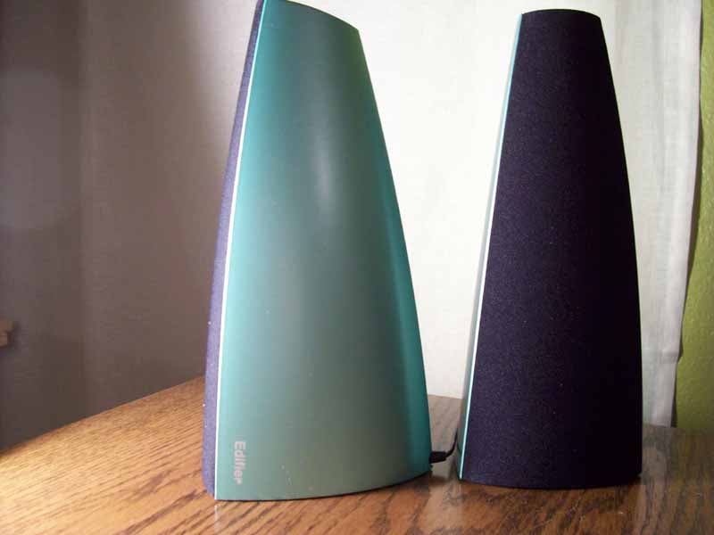

The two satellite speakers are average speakers with decent mid and high ranges. The two-way satellites, each with a 2.75-inch oval-shaped driver and 0.75-inch soft silk tweeter dome, are magnetically shielded. (This hardly matters in today's electronic market, unless you are using an old CRT monitor.) Looking at the speakers straight on, there is really nothing visually unique. However, if looking from the sides or from above, the speakers have a crisp shiny finish and look very nice.
The unique looking down firing sub is nothing short of disastrous. Though the sub enclosure is very nice looking, bass distortion and rattling begins at a mere 25% volume capacity. To the benefit of the speaker system, there is a manual bass control, but if you turn it down just a little, you really can't hear much bass. There is a very fine, extremely frustrating line of adjusting your bass to sound good without distortion. However, little bass can be heard if you turn the dial down even a little. So you basically have two options: bass that distorts the music or no bass at all.
Listening Session
Just for kicks, I turned on some old Dr. Dre, put the volume at 50%, and even with sticky, felt-like pads on the bottom, the subwoofer started to vibrate and move around on both tile and hardwood flooring. By the time a song was over, it moved about an inch. The sub did not move around on carpet, but the same sound distortion was there. If you wanted to use this system for your computer, do not have this on your desk. The sub will cause everything to shake. Now, for a big bass fan like me this sounds cool, but with this system, it is not.
I also listened to some softer music, including tracks by James Taylor, Enya, as well as several softer artists. This style of music came across much better with the subwoofer and the E3350 actually sounded like a good system. However, anything after 25% did distort any bass that may have been on the different tracks.
