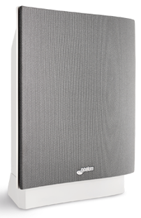

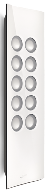

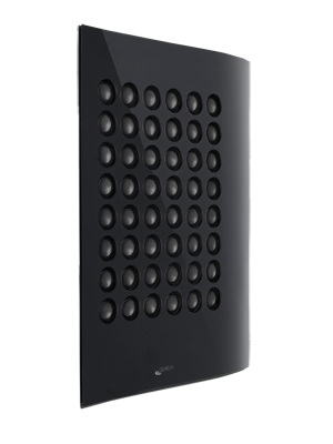

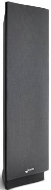

Currently they have four different speaker offerings on their website, the "flagship" being the Flow .4810 (pictured above). As near as we can tell, the "10" at the end is a model number with the preceding number indicating the number of drivers in each speaker. So, the .4810 has 48 drivers (in this case, 1" in a point-source array). They also have a Flow .1010 (2" drivers in point-source, pic below left), Stream .310 (two 4" woofers and a 1" silk-dome tweeter in a D'Appolito array, pic center), and the Stream .210 (5" woofer and 1" silk-dome tweeter, pic right). The speakers will all wall mount, but the Stream speakers also come with a removable "foot" for shelf-top placement.

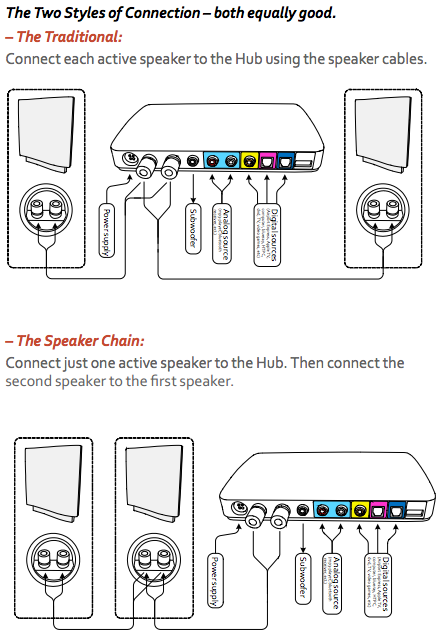

And here is where things get confusing. Check out this diagram:
We did a double-take. Yes, you can wire these speakers in parallel or in series. What confuses us is how the speakers know what to play. At first we thought the speakers received their data wirelessly and power only through the speaker cable, but that doesn't seem to be the case. From Opalum:
Furthermore, there is a bit-perfect digital signal superimposed on the same simple cable. This is far cheaper and much more robust than any wireless technology. There is no buffering delay, making it perfect for movies, TV-games and any other media requiring a live audio feed without delay.

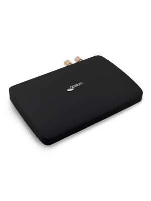

That can only mean that there is a switch somewhere on the back of the speaker that lets it know what content to play. It is either that or it is a mono system which we can't believe is the case. The Control Hub (which is due for an upgrade this year) can connect to your wireless network to stream content though it can only receive stereo. Opalum recommends downmixing all multichannel inputs to stereo.
There are four physical inputs on the back of the Control Hub - two optical, one coaxial, and one analogue. Opalum recommends using the digital inputs before the analogue. There is a subwoofer output which Opalum eschews saying, "In most cases the system won't require a subwoofer..." The output is locked into 80Hz with a 24 dB/octave crossover setting. As the entire line of speakers is rated down to 44Hz or lower (which we'll believe when we hear it), this crossover should be more than adequate.

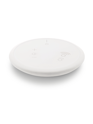

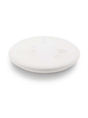

The Opalum remote control is as unique as the reset of the speakers. In the shape of a small saucer, it has a 4" diameter and 0.7" thick. It connects to the Control Hub via RF so walls and other barriers won't be a problem. It also will be a pain to integrate into a whole home system, though we understand that a new Control Hub is on the way that will accept IR, RF, RS-232, and Bluetooth for increased integration and connectivity.
