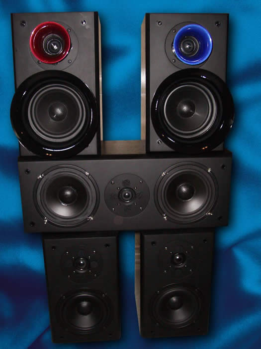

Installing the Mi-Horn devices requires a Phillips head screw driver and a few minutes of twisting action to get all of the horns installed via fastening them to the drivers with screws. Mi-Horn offers Velcro adhesive alternatives for speaker systems incompatible with this installation option. In fact, these speakers came with the Velcro hook-ups for the tweeter sections. After getting the Mi-Horns installed, I couldn't help but reminisce of the days where scratch collars were a must for my pet poodle who always suffered from ear infections. The Mi-Horns aren't quite big enough for a dog or cat, but hamsters and gerbils rejoice, for there is salvation to your itchy ears at last ;-)

clip_image009 The theory behind Mi-Horn technology is to minimize reflected sound caused by the room so that the first arrival sound is more clearly identified by the listener. This is nothing new. Companies have been using horn loaded driver technology since the dawn of loudspeakers. The big names such as JBL and Klipsch have popularized these designs, especially in concert and movie venues. The advantages of horns are two fold, increased efficiency, controlled dispersion. These are all attributes that in my opinion best suite outdoor concert venues or large arenas, though some audiophiles prefer horns in their hifi systems. I for one am not a horn lover. I prefer the less compressed, more open and spacious sound of conventional cone and dome driver designs, at least for home audio and theater. But that's neither here or there since the focus of this review is on a horn technology meant to enhance budget speaker systems.

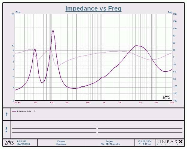

Impedance / Phase of the DAC1.5
The impedance profile is a bit erratic but doesn't dip below 4 ohms within its usable bandwidth. Given its high efficiency, and benign electrical phase, I don't see being a problem for any moderately price receiver to drive without incident. The systems low end response appears to be tuned at around 65Hz.
