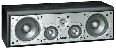

Atlantic2Nested MTM Configuration (Figure 1.b)
As the demands for better performance were placed on the center channel speaker, manufacturers began looking at ways to improve upon the very popular MTM configuration.  The goal was to reduce the spacing between the horizontally mounted woofers to minimize lobing errors and improve off-axis response.  Of course doing this involved different cutouts in the cabinet design. This meant that manufacturers would have to produce a specific cabinet for center channel duties vs the traditional cutouts used for the classic vertical mounted MTM.  Hence the nested configuration was born.  The end result is a slight improvement of off-axis response over classic MTM's.
More elaborate designs can employ an additional pair of midranges in an M(MTM)M configuration for broader coverage and greater output capability.  Some manufacturers even offer a 3-way variant W(MTM)W where dedicated bass woofers are located on each side of the nested MTM arrangement.  This helps extend the bass response and power handling of the center channel.
Infinity center2
W(MTM)W Center Channel Courtesy of Infinity
