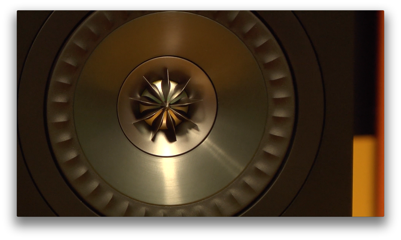

I've been listening to and reviewing speakers like these KEF X300A's for quite some time. In fact, a lot of bookshelf speakers as well as many powered monitors come across my desk—literally. Well, not literally. They're more or less next to my desk. On stands. The point is—I've listened to a lot of these speakers and I know what I like. I love solid bass, but it doesn't have to sound like a subwoofer is in the room. It just has to be punchy, you know? Where it hits you right in the chest. If your speakers do that, you've got bass pretty much covered. As for highs, what you're listening for is clarity without that brittleness that can come from a tweeter that not integrated well or receiving signal through a poorly thought-out crossover. The KEF X300A's have none of that either. The high frequencies have tons of detail. That just leaves the mids—you know, all the stuff in the middle that most speakers just presume will come from somewhere. No, mids are important and I loved the way the Uni-Q driver array pulled this off. I'll get specific in my listening tests, but let me jump into why I'm impressed with how these speakers are made.
For one, the X300A powered monitors use two class AB amplifiers in each speaker. A 50 watt amp drives the woofer and handles the low and mid frequencies, and a 20 watt amp powers the 1" vented aluminum dome tweeter. It's brilliant and really effective. Each speaker actually has a high-end toroidal transformer and the other really unusual thing is that each speaker houses its own 2-way or twin amplifiers. You can tell they mean business, too, as each has a large heat sink right on the back. The speakers are 11-inches tall and nearly as deep. They also weigh over 16 pounds each. There's no speaker cable connecting the two, either, it's actually a USB cable. So...these speakers each get fed digitally and the onboard DACs, which are capable of 96kHz, 24-bit decoding, take care of the conversion right at the point of output. And there's no noise. They're completely quiet when they're not on. Dead silent. They also are designed to go into standby mode after a few minutes, but connected via USB, the small front LED, which is normally green, never did turn amber until my Macbook Pro went into sleep mode.

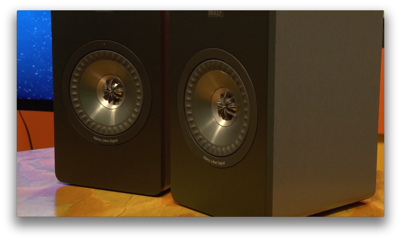

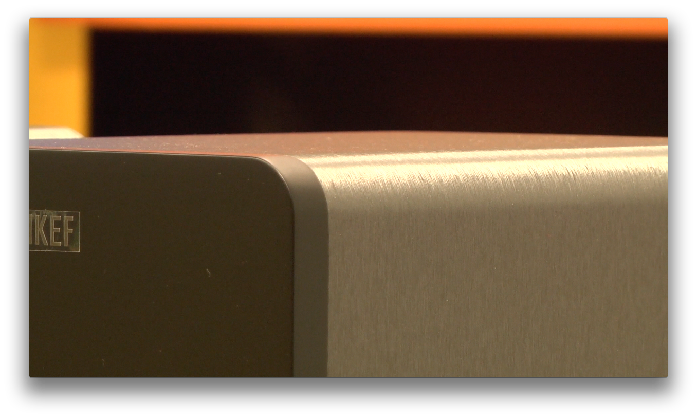

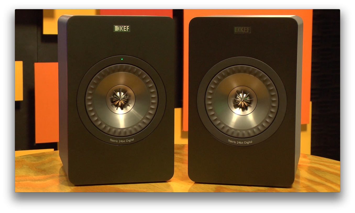

The KEF X300A speakers are very attractive. They have a black baffle with the attractive Uni-Q driver array mounted flush to the face. There is no grill for these speakers—and there shouldn't be. They look awesome as-is. The veneer of the cabinet has this brushed aluminum look to it and the edges are nicely rounded in a continuous wrap. The rear-facing port is flared and the hefty speaker seems very well-made.

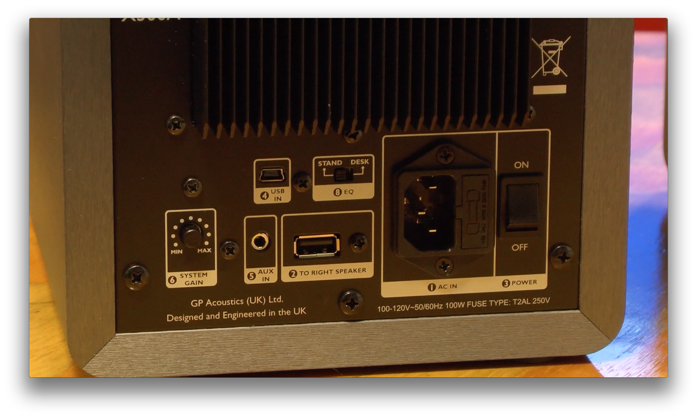

Now you can connect these speakers to an analogue audio input—there's an 1/8" stereo jack on the back of the primary left speaker. But what you really want to do, unless you're using a high end DAC already, is feed these from the USB output of your computer. Then you're really getting the benefit of the onboard DAC, which by my standards does an incredible job for something built into a speaker. Also on the left speaker is a balance switch that goes between Stand or Desk mode. It essentially rolls off the low end just a bit for when you place the speaker on your desk as opposed to on stands. You can also use the included foam bung plugs (I swear that's what they call them—just insert your own joke there) to tighten up the bass a bit in the event your speakers are close to a wall.
