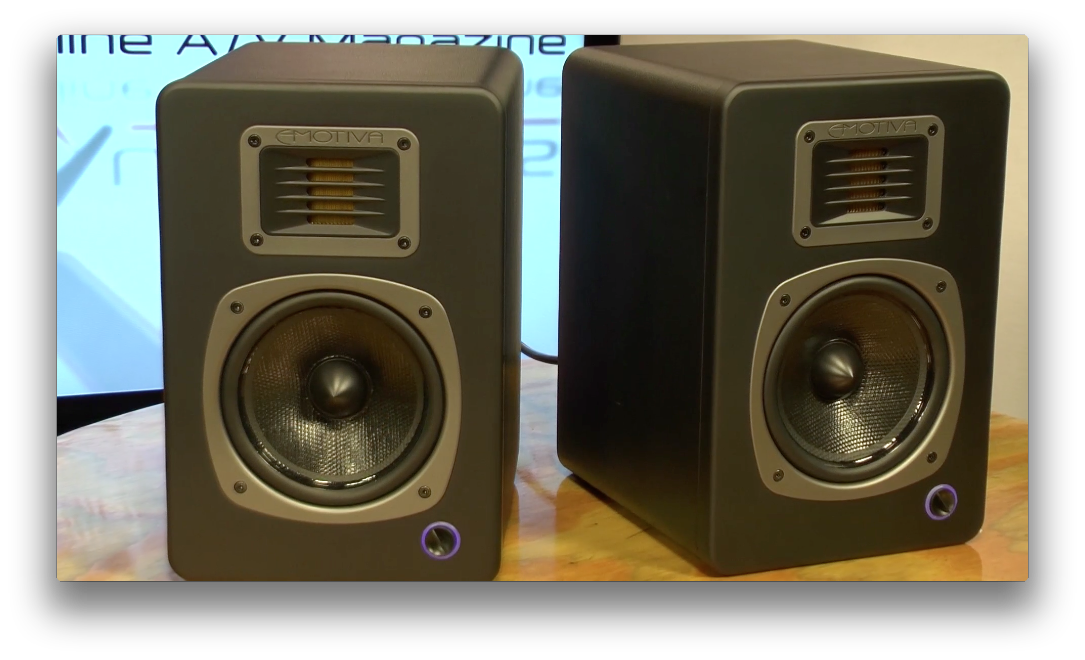

I recently had a small speaker shootout that involved many of the products I had in for review. This included bookshelf speakers, active studio monitors, passive monitors and some towers. That's an eclectic mix, but within that smorgasbord of boxes were the Airmotiv 5's. These are Powered Studio Monitors and they're new from Emotiva Professional.

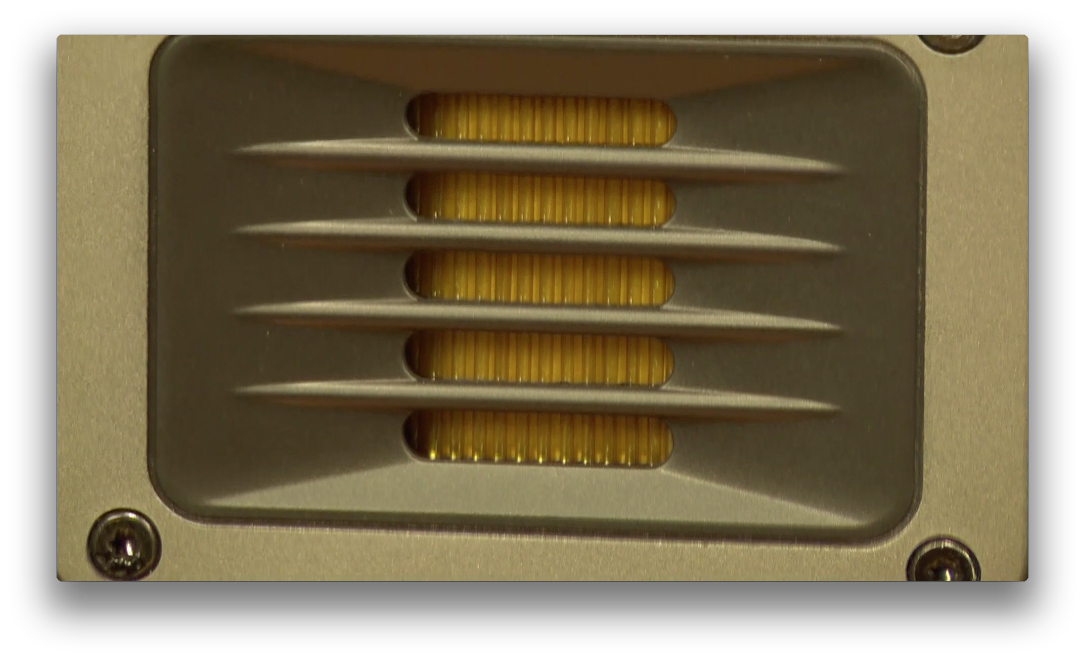

The Airmotiv 5's are two-way powered speakers that can each receive either an RCA line level input, or a balanced XLR. There are three speakers in the Airmotiv studio monitor series, the 4, 5, and 6. We chose the middle of the pack, which has a single 5-1/4" polypropolene composite cone woofer and a 1" x 1-1/4" high-frequency folded-ribbon transducer. It's the ribbon tweeter that gives the speaker it's unique look and which also gives it it's signature sound. More on that later.
Each speaker is powered by a 50 watt RMS amplifier and, unlike many powered speakers, the left and right are completely identical, each with its own amp. To our disappointment, there was no line level output on the speaker, so you'll need to use a preamp or a Y-cable in order to hook up a sub to fill in the ultra low frequencies.

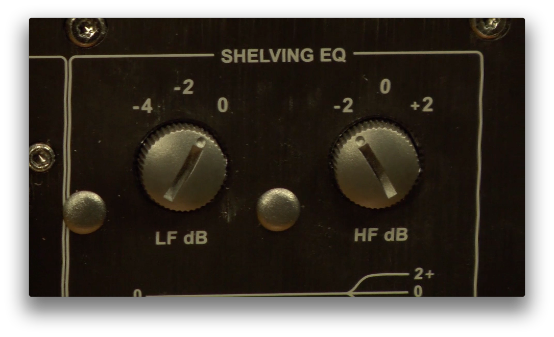

Speaking of frequencies, you can tweak the Airmotiv 5 by utilizing the included High frequency "tilt" control and the Low frequency shelving control. Basically it's a pair of shelf EQs that can raise or lower frequencies by 2dB above 4kHz and drop them 2 or 4 dB below 150Hz - handy when placing them on a table or desk. Each speaker is capable of playing down to 52Hz, which is pretty respectable, given that each cabinet only measures roughly 11 x 7 x 8 inches. That's big sound for a pretty small speaker.
So let's talk about the sound. At first, we didn't think it was all that. The highs were very clear, but the bass was anemic... Until we started adjusting placement. And really, that's the key with these. They're near field studio monitors, so treat them as such. We had them in a big room and then moved them to a desk. You'll want to toe them in slightly and make sure the ribbon tweeters are at ear level. You also want to use the shelving EQs to adjust for any wall or desk placement or to dial down the high frequencies if you feel it's needed. But once everything was configured, we really liked the Airmotiv 5's. They had a lot more finesse than the Audioengine 5+ speakers we were comparing them to, but possibly at the expense of some midrange detail. Bass was a toss-up. Sometimes, we felt the Audioengine speakers won out, other times, the Emotiva's sounded better. Obviously program material made a big difference, and it was more about how the bass interacted with the mids and highs on these speakers.
