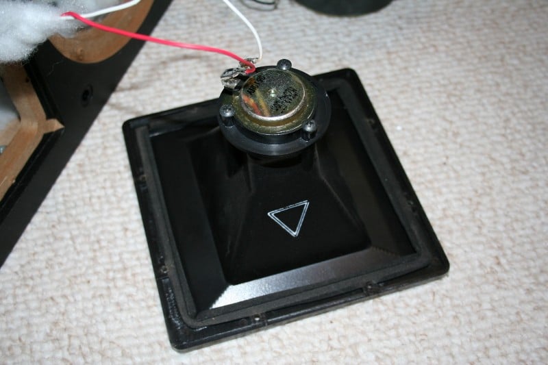

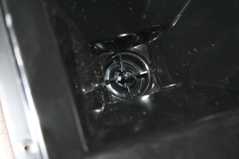

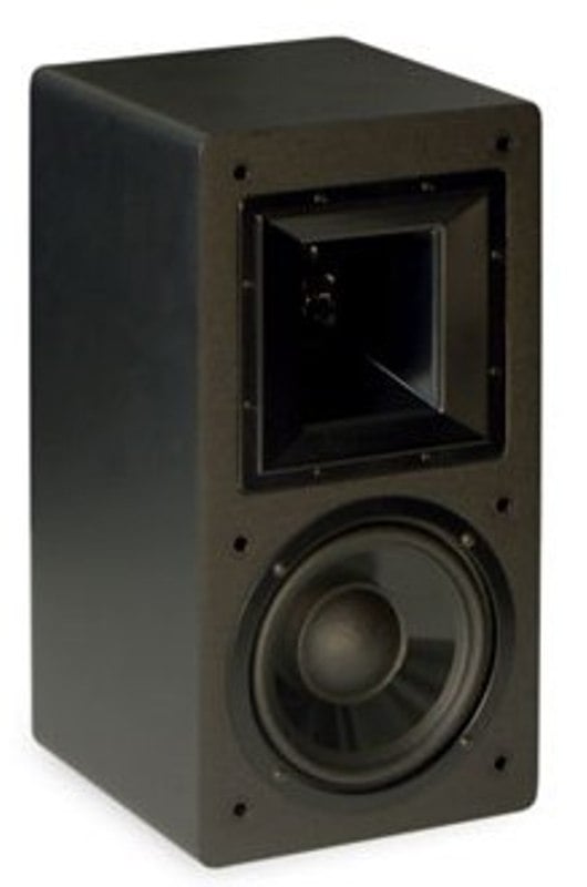

Each HB-1 arrived in its own box, perfect if you are putting together a 6.1 system (no silly “they only come in pairs” rules). The speakers are quite a bit larger than I expected, almost as tall as my old Axiom m22’s but a bit wider. The horn loaded tweeter takes up nearly half the real estate on the front baffle and looks even bigger than the 6.5” woofer. The corners are rounded and the entire speaker is wrapped in black vinyl. There are no feet or provisions for feet on the bottom of the speaker. HSU Research didn’t even provide any sticky rubber or felt pads assuming that you’d already have them on your stands. The back of each speaker has a pair of binding posts and three threaded inserts for wall mounts. In the middle of the back of the speaker there is a flared port.

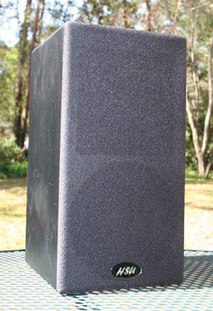

The HSU logo is prominently displayed on the grill. The grill also matches the color of the vinyl wrapping that, in the right light, is hard to distinguish between the two. Honestly, there were times that I had to look for the logo to know where the front of the speaker was. However, when there was a lot of direct front light, the shiny finish on the horn would reflect and show through. The grills are very sturdy and well connected. The posts on the grill are plastic and have enough resistance so that you have to work a bit to get them off. The plastic posts make me a little nervous that they will someday bend or break with frequent removal of the grill. I’d feel better if the post was metal but that worry is probably unfounded.
Aesthetically, with the grills on, the HB-1 resembles the SVS SBS-01 offerings except for the size. Because the speakers are so much larger, I find them to be a bit less attractive (note – I didn’t find the SBS’s all that attractive to begin with). On top of that, their appearance earns less points in the WAF department with the grill off (something I rarely say) so there is little you can do to improve the aesthetics less building them into an entertainment center which may compromise performance. With the grills on, as flat black speakers are wont to do, they blend into a darkened room very well.

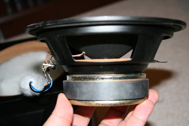

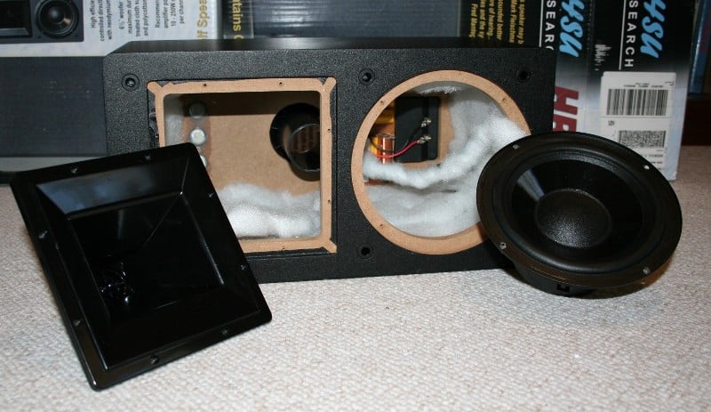

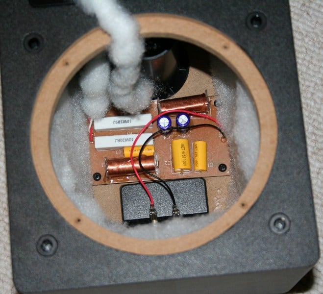

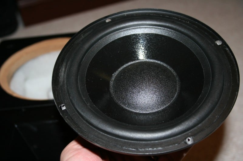

Cracking open the speakers, it was (for once) easy to see all the component parts. The crossover was mounted on the back wall just below the port and above the binding posts. The 6.5” woofer was secured by a plastic vanity ring over the metal surround which helps reduce the transfer of driver to cabinet resonance. The woofer basket is stamped which is to be expected at this price point. I was particularly impressed with the rigidity of the woofer material – it was much harder than other treated paper woofers I’ve experienced in the past. I confirmed that the unit was constructed out of ¾” MDF and it was lined with a thin layer of polyfill. There was no additional internal cross bracing. The port was flared on the outside but not inside which helps to reduce port turbulence noise. The drivers are NOT shielded so you best keep these speakers away from a CRT display or magnetic media storage device.

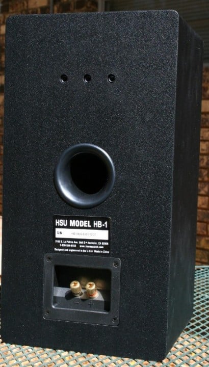

After busting out my slide rule… I went ahead and just placed them where I normally place speakers. In my world, speaker placement doesn’t take a degree in mathematics. The manual goes on to dissuade someone from wall mounting these speakers because of the port - basically, it suggests that you should use a “swivel” type mount to increase the distance between the rear of the speaker and the wall. This is generally a good idea in that it gives the port some room to “breathe” and it reduces boundary reinforcement which could bloat the bass response. These creates some confusion for me in that they have obviously included threaded inserts on the back of the speaker for wall mounting but then designed the unit with a rear port and imply that wall mounting isn’t the best idea. Better, I think, that they relocate/remove the port or remove the mounting hardware. This won’t stop people from wall mounting them but it will show the user that wall mounting isn’t the optimal placement. Sure, removing the port may decrease the bass output but then you wouldn’t have as many placement concerns.
