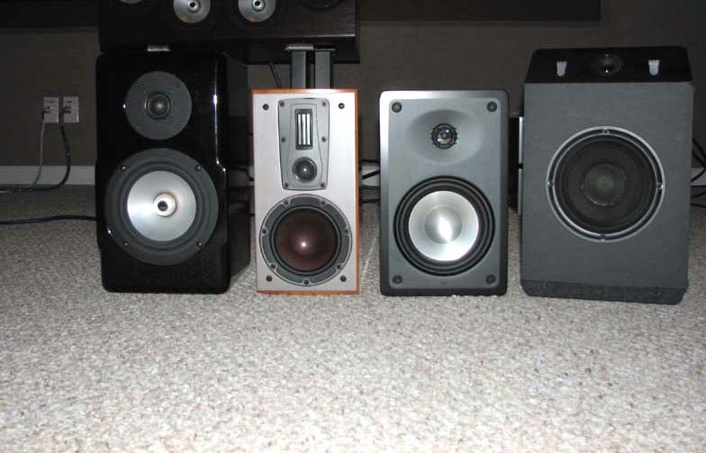

It was a refreshing surprise to get a hold of a bookshelf speaker that
occupies a small footprint. As you can
see in the image, these speakers are the smallest of the pairs I had at my
disposal – about 2/3rds the size of the Bose 201’s. Now all I had to do was determine if they

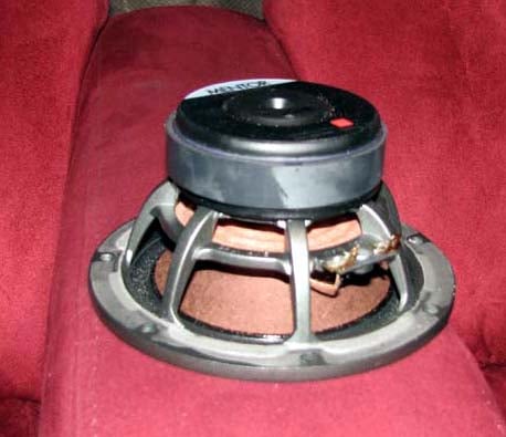

The Woofer![IMG_0050001.jpg](IMG_0050001.jpg/image_mini)
According to DALI, the ultra lightweight, stiff wood fiber paper cone is responsible for its very fast & agile response. The motor structure utilizes a die-cast rigid aluminium chassis (no wimpy stamped baskets) to minimize resonance. The rear side of the spider assembly is open (6mm air gap) to reduce air compression around the (17mm) voice coil. Upon inspection it was clear to me this was a quality driver. The cone was stiff as it should be and had a very linear response when moving within the limits of its excursion capability. The driver is not magnetically shielded so keep this speaker clear of computer hard drives or CRT displays. The woofer was well secured to the cabinet with seven (7) screws making it clear to me that DALI understands the importance of reducing mechanical vibrations by ensuring the drivers are firmly planted into the front baffle.

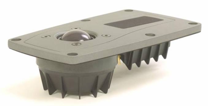

Tweeter(s)![tweet.jpg](tweet.jpg/image_mini)
The Mentor 1’s employ a hybrid tweeter module consisting of a dome and ribbon driver topology. DALI claims the dome tweeter is specifically designed to have a natural acoustical roll off response to blend seamlessly with the ribbon tweeter without the need of a passive low pass filter network. According to DALI, the tweeter array sports a floating waveguide behind the dome for optimum support of the dome shape and resonance damping without blocking the free airflow. I was particularly impressed with the large acoustical rear chambers on the dome and ribbon drivers. Their primary functions are to lower compression and the resonance frequency, taking some of the pressure off the woofer to produce the upper midrange.

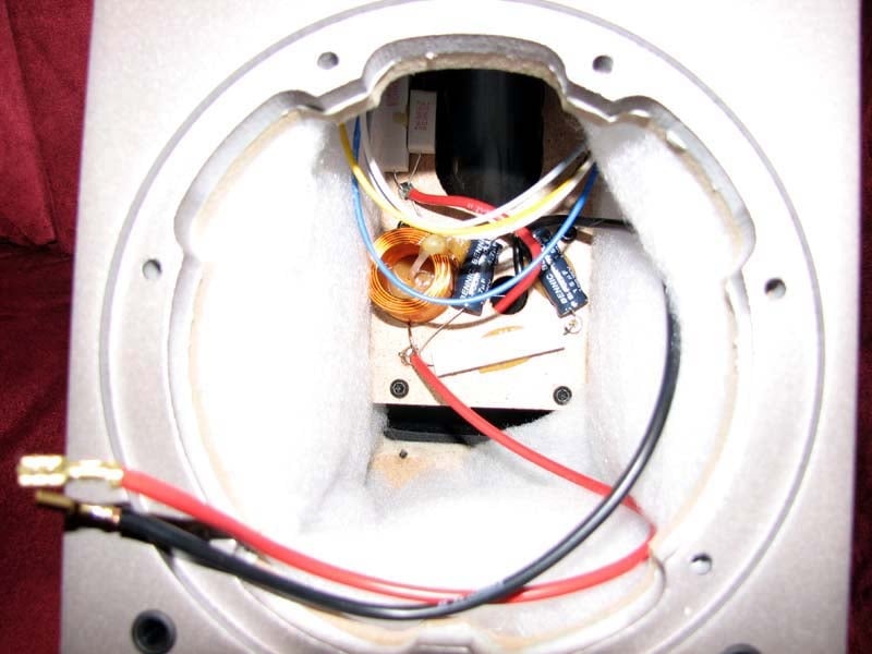

Crossover![IMG_0052001.jpg](IMG_0052001.jpg/image_mini)
The brains of the speaker – DALI employed all air core inductors for greater precision and lower losses due to core saturation. Tight tolerance ceramic resistors were utilized in the crossover design but to my surprise DALI used what appeared to be electrolytic capacitors instead of polypropylene. Poly caps tend to be more linear at high frequencies at the expense of increased cost factor and footprint. I’d be curious if DALI offers an upgrade path to these crossover parts for future designs.
The network was carefully designed to help make the speaker system behave more like a resistive load allowing for a more consistent sound when playing on a variety of amplifiers. You’d be surprised how many manufacturers overlook this important engineering design principal in their designs.
The crossover was firmly secured down to the back of the cabinet via screws and the internal cabinet was generously damped with Dacron insulation on the side walls and bottom though curiously missing insulation at the top of the cabinet.

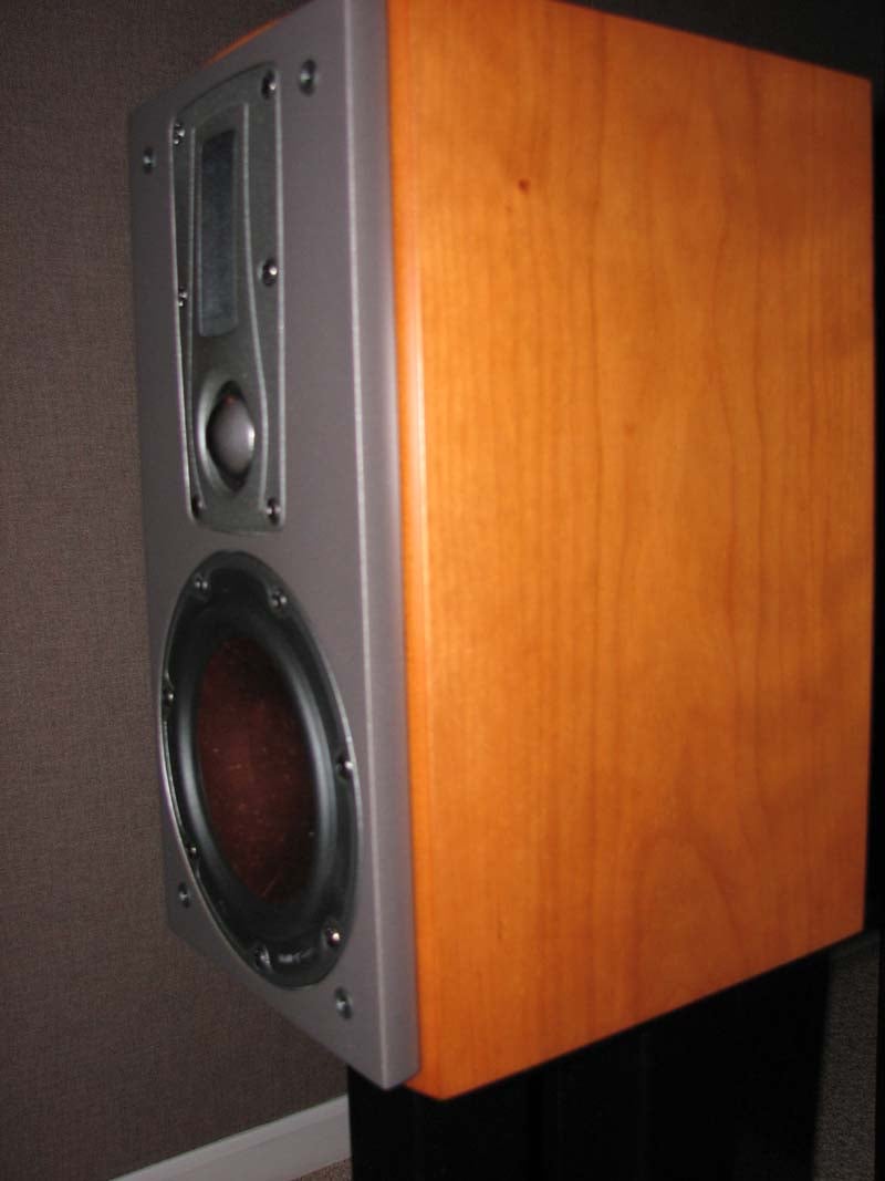

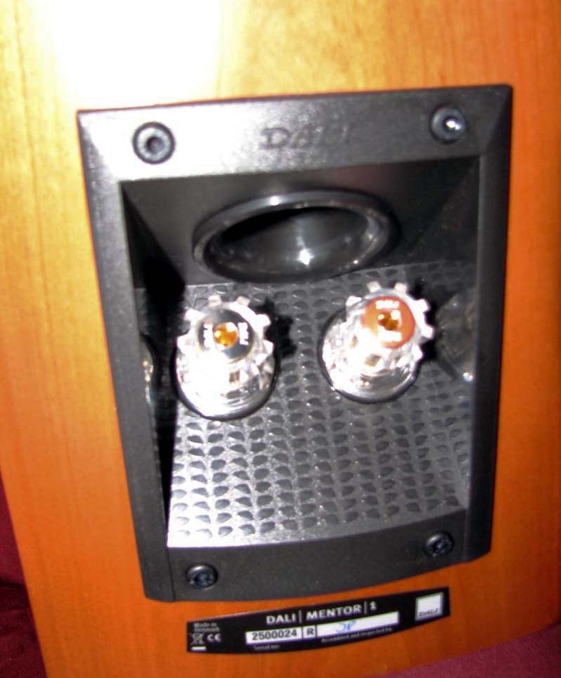

The Backside![IMG_0038001.jpg](IMG_0038001.jpg/image_mini)
The DALI Mentor 1’s have a really nice rear end. From the contoured shaped back panel (which serves for aesthetics reasons and reduction of standing waves in the cabinet), the heavy duty WBT binding posts, to the neatly tucked away inclined port, these speakers demonstrate efficiency in design and function. In fact, the clever inclined port was likely implemented as a space saving method of extending port length in a small cabinet to lower the tuning frequency and increase bass extension. My only minor concern is for people using garden hose thick speaker cables which could potentially block the port. I suggest using some common sense here. If you think you need to use wire gauge any heavier than 10AWG on these speakers, perhaps some therapy is in order.

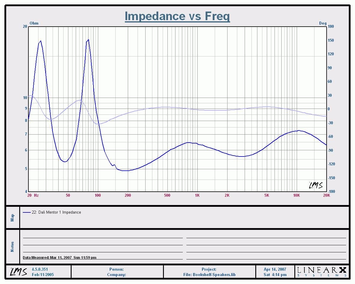

Impedance / Phase Measurements of the Mentor 1
DALI lived true to their claim that their loudspeakers are a “Amplifier Friendly” loudspeaker system – in my book this earns them big brownie points. System tuning appears to be around 45Hz as indicated by the impedance minima between the two saddle points. The impedance never dips below 5 ohms and most importantly, their phase response is very uniform maintaining –30 to 0 deg from 100Hz up to 20kHz. Any decent home theater receiver should be able to drive these speakers without incident and from my testing they do sound very uniform whether I tested them on an inexpensive receiver or the very impressive and inexpensive Reference Series separates system from Emotiva.

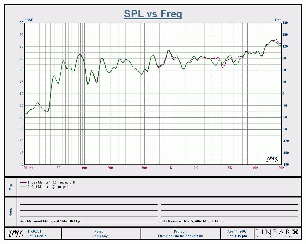

In Room 1 Meter Frequency Response Grills On/Off of the Mentor 1
I couldn’t measure any appreciable frequency response variation with the grill on versus being off other than the -2dB notch between 3-4kHz with the grill on which may partly explain why I subjectively felt that the Mentor 1’s sounded best with their grills off just as all very revealing speakers tend to.

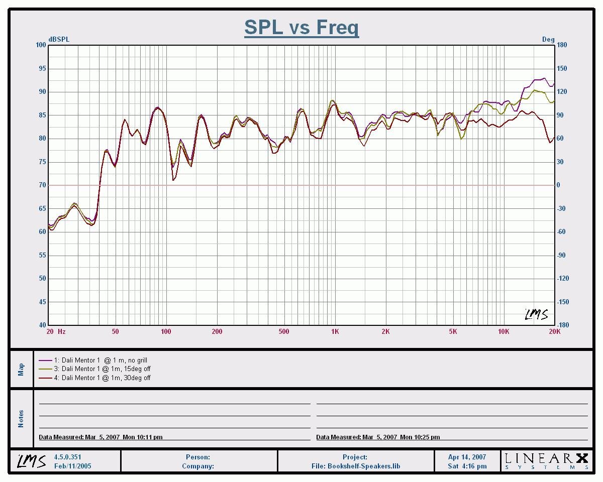

In Room 1 Meter Frequency Response On / Off Axis of Mentor 1
This graph perhaps reveals why I found the Mentor 1’s to be a bit hot in the top end. Overall the graph looks quite linear up until around 12kHz where we see a bump of 5dB out to 20kHz. Incidentally this is where the tweeter rolls off and the ribbon cuts in. It would have been nice if DALI offered a POT adjustment to tone the ribbon tweeter down for those whom prefer a warmer, less aggressive sound. The response of these speakers look best 30 degrees off axis, hence why I recommend little to no toe-in.

The excessive high frequency energy that Gene observed in the Mentor 1’s is an intentional design attribute and part of DALI's "flat off-axis" design. DALI speakers are designed to be linear 20 to 30 degrees off-axis. If they are toed-in (should never be done), they will sound "Hot".
The curvature of the DALI wood-pulp cone, combined with a specific crossover design, results in off-axis linearity. For these reasons, DALI speakers must always be set-up "flat" with respect to the listener, so that the signal received is off-axis.
