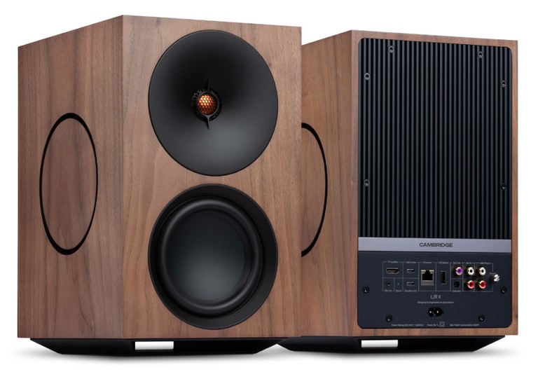

Cambridge Audio L/R X
Cambridge_Speakers_LRX Walnut front and back

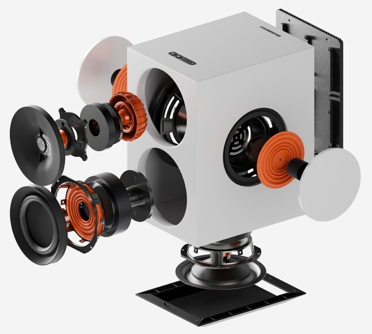

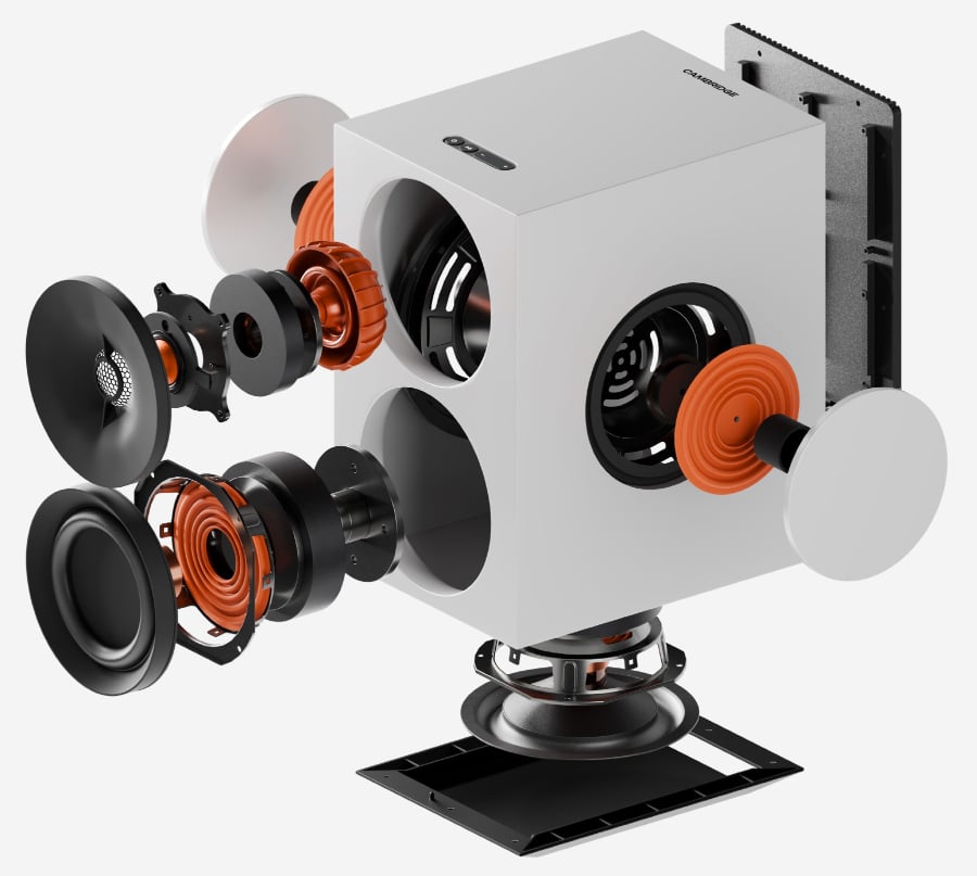

The flagship L/R X is nothing short of a direct challenge to the KEF LS50 Wireless II, which has remained a dominant force in the world of active streaming loudspeakers since its launch 5 years ago. The new Cambridge contender has a 2.5-way acoustic design in its corner, featuring a proprietary torus-chambered tweeter, a front-facing 5-inch woofer, a second 5-inch woofer integrated into the base of the speaker, and a pair of 6-inch force-cancelling passive radiators, one on each side of the rather handsome cabinet.
LRX_Exploded
The color-matched passive radiators are tuned to 38Hz, extending the speakers’ bass performance down to the mid-30Hz range, according to Cambridge. Each speaker is powered by 400 watts of Class D amplification, resulting in “deep, physical low-end energy that remains tight, controlled and musical, even at higher volumes,” and delivering “scale, depth, and impact without the need for a separate subwoofer,” according to the company. A new 64-bit audio pipeline reportedly preserves the finest musical details. I would assume that the crossover is handled in the digital domain, though Cambridge has not said as much. But we do know that the L/R X integrates Cambridge’s DynamEQ technology, which subtly adjusts bass and treble through the volume curve in order to keep music sounding “perfectly balanced, even at lower volumes.”

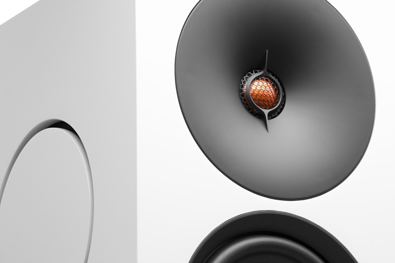

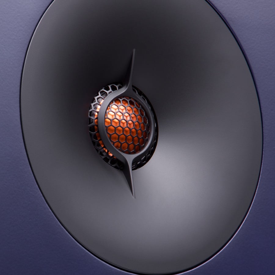

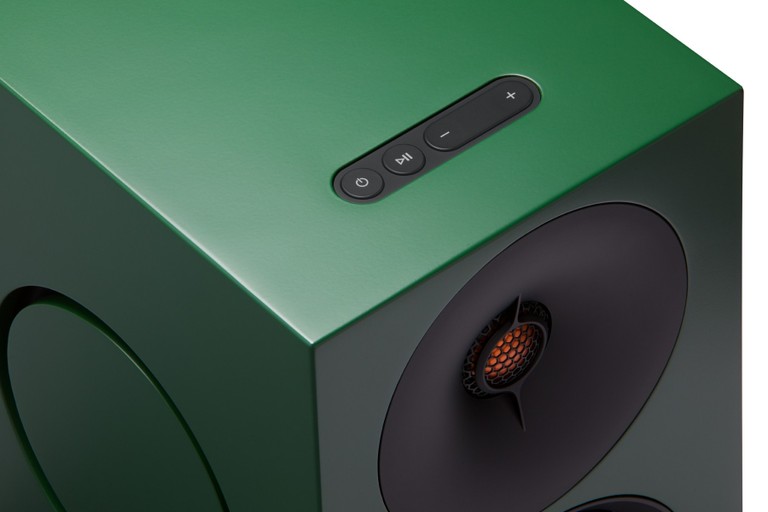

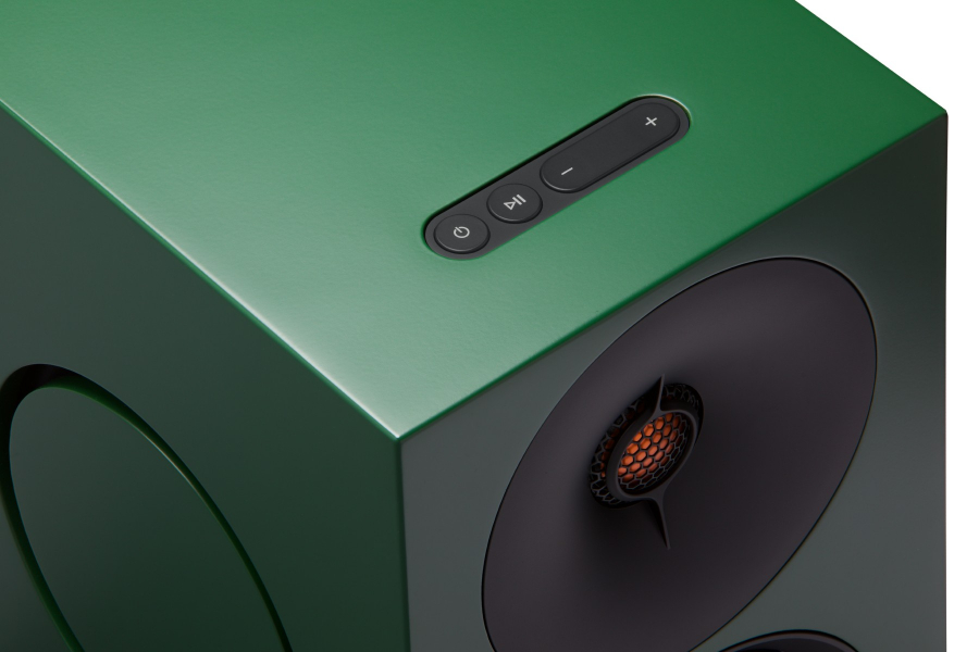

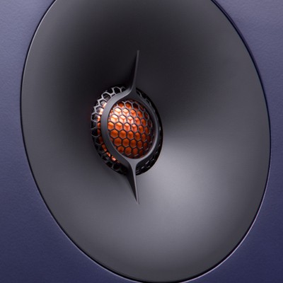

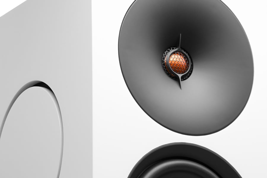

Cambridge Audio’s New 28mm Torus-Chambered Tweeter
Tweeter close-upBoth the L/R X and the L/R M use Cambridge’s newly-designed 28mm torus-chambered tweeter, which the company credits for the speakers’ expansive, ultra-wide soundstaging and holographic imaging. The tweeter’s distinctive torus-shaped rear chamber resembles a doughnut, forming a tapered internal horn that reportedly absorbs rear energy, preventing reflections and dramatically reducing harmonic distortion. Although the design is unique, this aim of preventing reflections from the tweeter’s backwave will sound familiar to fans of the Metamaterial Absorption Technology used in KEF’s aforementioned LS50 Wireless II speakers, among others in the KEF catalog. Cambridge says that the torus-chambered tweeter “represents a new approach to high-frequency reproduction, delivering exceptional clarity, improved sensitivity, and hyper-realistic imaging at any volume.” The 28mm dual-radius aluminum dome offers 25% more surface area than a traditional 25mm design, according to Cambridge, displacing more air with greater control. A custom waveguide and phase cap ensure consistent on-axis and off-axis performance, resulting in treble that “feels open, precise, and effortlessly detailed, even if you’re not sat directly in the sweet spot,” according to the company.

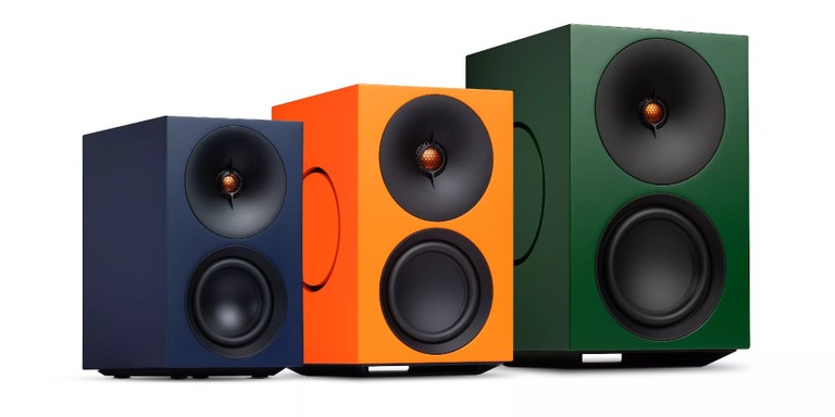

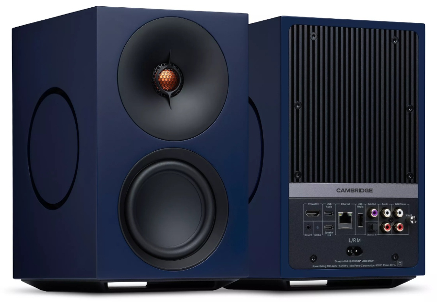

Cambridge Audio L/R M
L-R M front and back
The L/R M inherits all of the engineering ambition of the flagship L/R X, but stuffs it into a more compact form. It has the same streaming capabilities, the same physical connectivity, and the same 2.5-way configuration, using the same 28mm torus-chambered tweeter.
Cambridge_Speakers_LRM_Green_Detail1
The speaker’s core acoustic principles are the same, just scaled down a bit. While the larger L/R X uses 5-inch woofers and 6-inch passive radiators, the L/R M uses 4-inch woofers and 4.75-inch passive radiators. The smaller model still provides what Cambridge describes as “the weight and impact of a much larger system.” Each speaker has 150 watts of Class D amplification onboard. Real walnut veneer costs $100/pair extra on the L/R M.

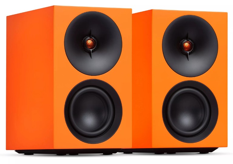

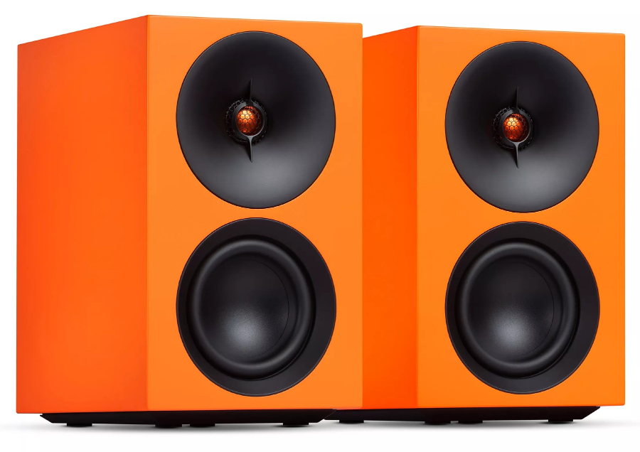

Cambridge Audio L/R S
L-R S orange
Designed for spaces like desks, bedrooms, and kitchen counters, the L/R S is a “bijou powerhouse that brings premium acoustics and confident design into everyday living,” according to Cambridge Audio. The L/R S is a simpler design with no built-in streaming — just aptX HD Bluetooth. Each speaker has 50 watts of Class D power, evenly split between the 21mm aluminum tweeter and the high-excursion 3-inch woofer. Instead of passive radiators, the L/R S features a rear bass-reflex slot port to enhance low-frequency performance while maintaining a compact cabinet size. The L/R S does still incorporate Cambridge’s DynamEQ technology, and its physical connectivity includes an analog input, a TOSLINK optical input, and USB Audio for connection to a PC or Mac. It lacks the HDMI eARC found on the larger models, however. A placement-optimization control on the rear panel allows listeners to adjust for boundary reinforcement, while a subwoofer output allows for upgraded bass. On this smaller speaker, the real walnut finish costs $50/pair extra.
