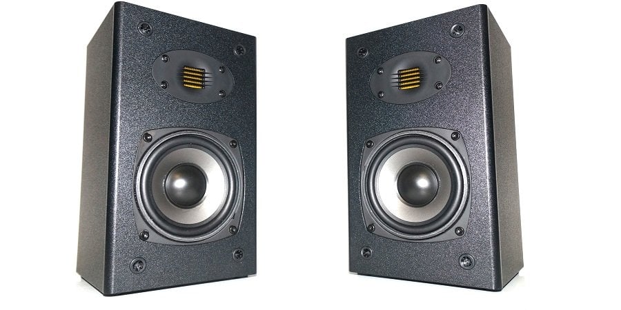

The Dayton Audio B452-AIR bookshelf speaker and C452-AIR center
speaker are an expansion of the Dayton Audio B562-AIR, which itself was an offshoot
of Dayton Audio’s classic original B562. What has made these series of speakers
notable is the extremely low pricing for full-sized bookshelf speakers. At the time of
this writing, a pair of B452-AIR speakers can be had for one penny short of $45, which makes them
the least expensive speakers ever reviewed at Audioholics (Monoprice MP-65RT on sale still cost $0.11 more/pair). Inexpensive doesn’t
necessarily mean bad though, and if we thought the B452-AIR bookshelf speakers
and C452-AIR center were going to be poor-sounding products, we wouldn’t have
requested a set for review. When we looked at the outward design and
specifications, we thought there could be potential here for a reasonably good
sounding speakers as we mentioned in our preview for the AIR speakers, although there were certainly going to be limitations necessitated by
such a humble price point.

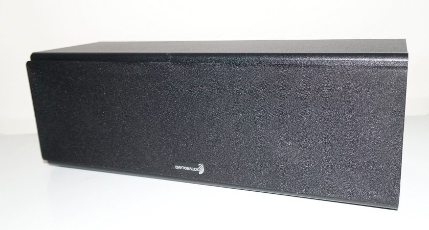

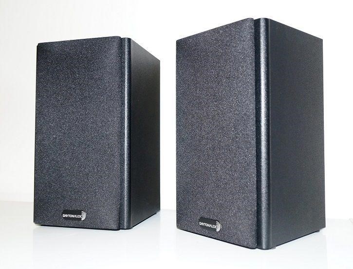

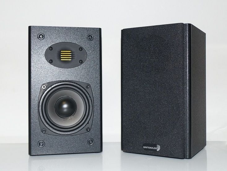

Packing and Appearance

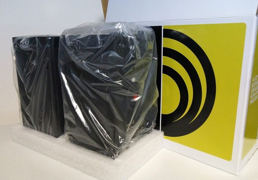

Since the B452-AIR and C452-AIR speakers are only available through Parts Express (that also sells through Amazon.com), buyers will very likely have to receive them through parcel delivery.
The AIR speakers were well-packed and arrived in a box with two large foam pieces sandwiching them and wrapped in plastic bags. Since they are light speakers, they will not be as susceptible to damage from shock as heavier designs. Unpacking them reveals some rather neutral black speakers that are not especially distinctive from an aesthetic perspective. That is not to say they look bad; they just do not look very flashy. With grilles on, they are conservatively-styled, vinyl-wrapped black boxes, although the rounded edges certainly help to soften their looks.
Removing the grille gives them a busier appearance but more personality. The mellow grey cone of the woofer and its glossy dustcap sit well with the textured vinyl veneer. The copper yellow of the AMT tweeter and its oval plate give the AIR speakers a touch of distinction. Overall, with grilles on, the AIR speakers are innocuous but a bit flat, and without grilles they are less elegant but a bit more distinguished.

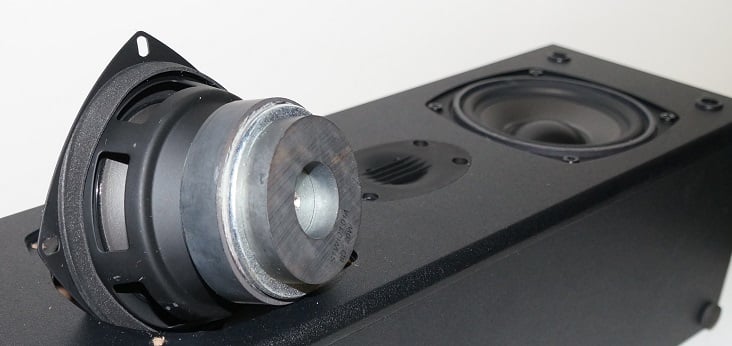

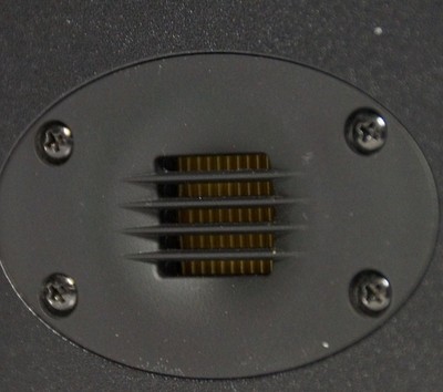

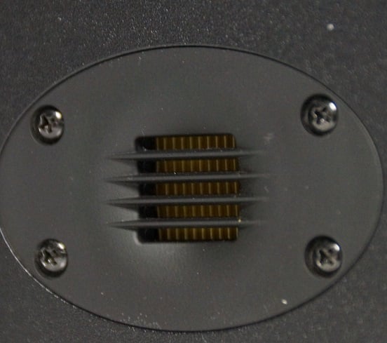

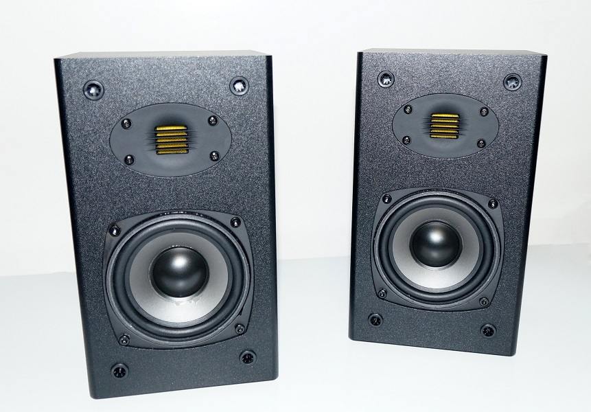

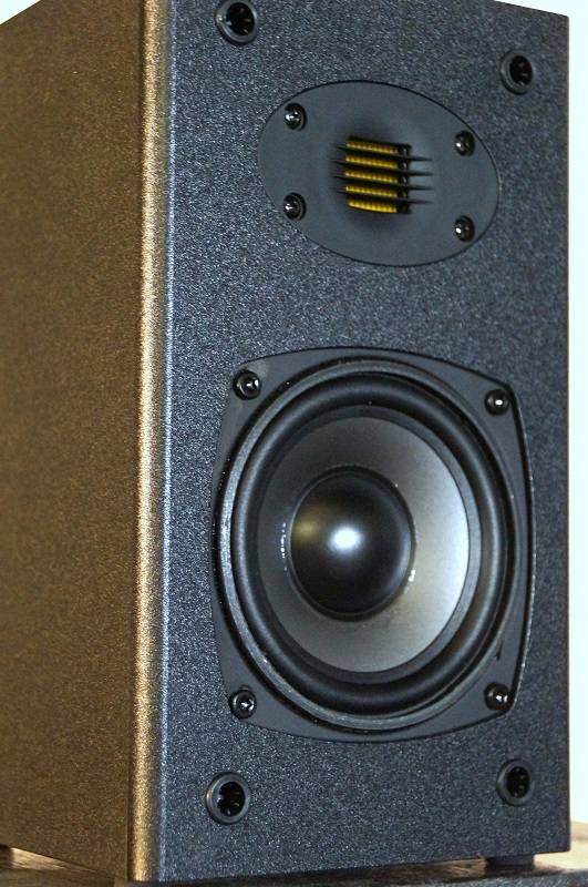

The standout feature of these Dayton Audio AIR speakers is the implementation of an AMT tweeter. AMT Tweeters are not typically used in speakers in this price range. AMT tweeters are a folded-ribbon design that has become a popular tweeter type in recent years. AMT stands for “Air Motion Transformer”. As opposed to conventional dome tweeters that oscillates pistonically, AMT tweeters contract and expand the folds of a pleated membrane to produce sound. To explain using an example, imagine the folded surface of a half-closed curtain- then line the interior folds of the curtain with conductive rods on adjacent sides of the folds, and set two powerful magnets on the sides of the curtain. Run some alternating current through the conducting rods and their newfound electromagnetic field will rapidly collapse and expand the folds of the curtain, and, in doing so, squeeze air in and out of the folds thereby creating pressure waves that we experience as sound.
A major advantage in this design is that since the folds of the diaphragm are much deeper than they are wide, air is ejected out at a much faster speed than the vibration of the diaphragm itself- as much as five times faster. Another advantage is the very light mass of the diaphragm that makes it very easy to move and to change direction since it does not have the momentum of the weight of typical dome tweeters. These elements give AMT tweeters an extended response well into ultrasonic frequency ranges. Also, since AMT tweeters can have a relatively large surface coupled with the air, they can have a very wide dynamic range. The AMT tweeters used in the Dayton Audio AIR speakers are on the smaller side, but they still may well have a major advantage over the dome tweeters used in their sister speaker line at Dayton Audio that uses dome tweeters. Given that the AIR series are considerably more expensive than the dome versions, one would certainly hope that the AMT tweeters are a lot higher performing.

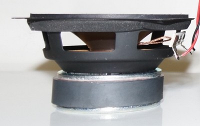

The 4.5” woofers use a polypropylene cone and a 4-layer coil. They have a good-sized 6.5cm diameter by 2cm thick magnet in the motor section. Curiously, the woofers between the C452-AIR and B452-AIR have a difference; the C452-AIR woofers have bucking magnets on their backplate. Bucking magnets are used to shield the magnetic field of the permanent magnet of the motor so the field won’t interfere with much beyond the speaker enclosure. They were mostly used to prevent the magnetic field from distorting CRT video displays, which would have been a sensible feature, once upon a time ago, for a center speaker. Since CRT displays are very seldom used anymore, Dayton Audio could omit this feature with little consequence.

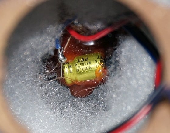

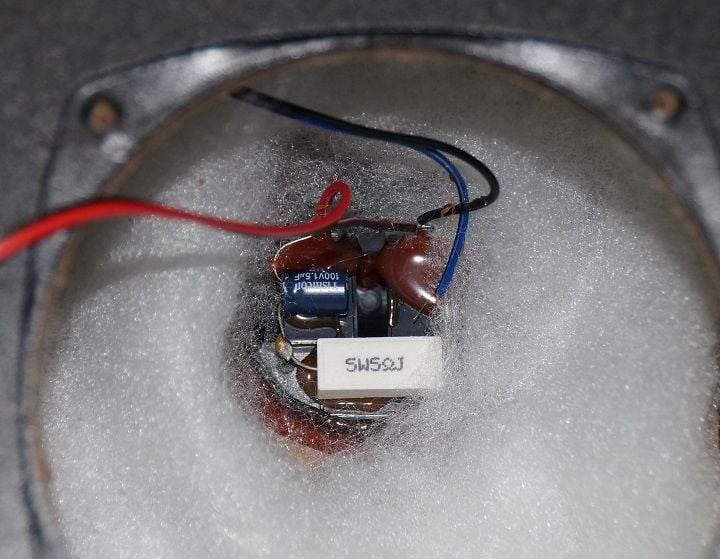

B452-AIR crossover (left) and C452-AIR crossover (right)
There isn’t much
of of crossover circuit on these speakers, not that such a feature would be
expected at this price point. The C452-AIR center speaker only has a small
capacitor, while the B452-AIR bookshelf speaker uses a capacitor and resistor,
and all connections are soldered. The capacitor is used to protect the tweeter from being fed frequencies deeper than is safe for them, and the resistor is
being used to pad the tweeter down on the B452-AIR so that it isn’t playing at
levels way above the woofer. This all means, of course, that the woofers are
running full range on these speakers. While that isn’t ideal, it is probably a
concession that Dayton Audio has to make to achieve their target pricing. It
does not have to be a severe flaw so long as the woofer is engineered to have
relatively benign breakup modes, which is very likely the case here. In other
words, the woofer can be designed to keep its upper-frequency misbehavior from
being heavily intrusive in the speaker’s sound.

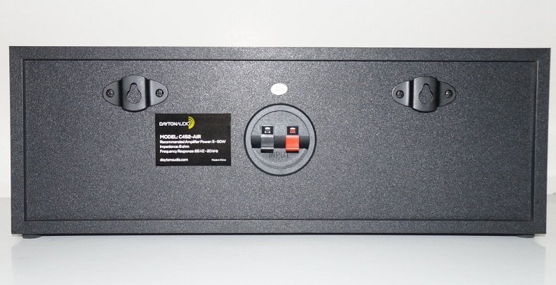

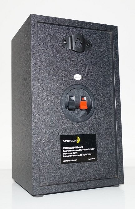

The cabinet is pretty minimal but it should get the job done. Cabinet resonance may not be a serious concern when the panels are this small. The AIR speakers are built with 1 cm thick wood-composite panels all around with some wedge bracing around the interior of the front baffle. There is a healthy amount of stuffing in the cabinet with should assist in damping. The AIR speakers are sealed, so there are no ports to help bass output, and this means they are exchanging more powerful bass sound for a gentler low-frequency rolloff. Such a design choice can be beneficial, as a flat response to low frequencies that ported designs can have can end up becoming too boosted when placed near surfaces or other boundaries. The sealed design of the AIR speakers may yield a more natural bass sound when placed near boundaries, which is made all the more likely by keyhole mounts on the back of the speakers.
The AIR speakers use spring-loaded clips for the speaker wire connection. The B452-AIR speakers do come with speaker wire: two 10 foot long wires that look to be about 20 AWG thickness. For runs longer than 10 feet, owners are advised to use larger thicknesses than 20 AWG. I would use thicker wire even for a 10-foot run, personally. The feet are just some small adhesive rubber pads. The removable grille is held in by some thick plastic pegs and is constructed out of a ¼” thick sheet of MDF with shaped cutouts for the drivers and is overlaid by a black acoustically-transparent fabric. The raised edges of the grille cutout around the tweeter is likely to cause some diffraction, so for the best sound, leave the grille off.

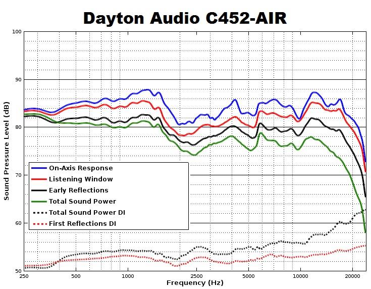

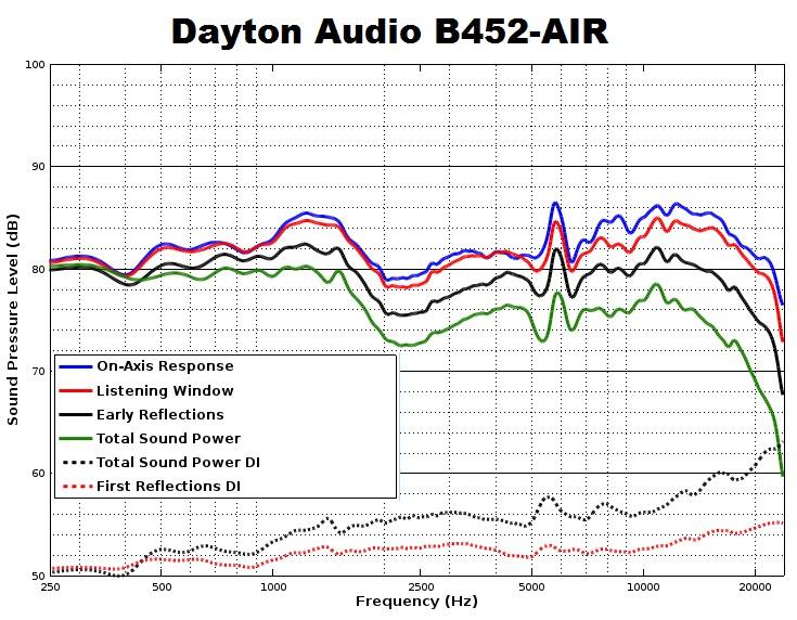

Dayton Audio B452-AIR Bookshelf and C452-AIR Center Speaker Measurements

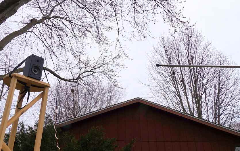

The Dayton Audio B452-AIR and C452-AIR speakers were measured in free-air at a height of 7.5 feet at a 1-meter distance from the microphone, and the measurements were gated at a 8.5 millisecond delay. In this time window, some resolution is lost below 250 Hz and accuracy is completely lost below 110 Hz. All curves have been smoothed to a 1/24 octave resolution.
Dayton Audio B452-AIR (left) and C452-AIR (right) response curves
The first thing that is apparent is that the upper mids/lower treble is a bit recessed compared to the rest of the frequency range, especially with respect to the bass since it abruptly descends in amplitude from 1.5 kHz down to 2 kHz. I am guessing the reason for this behavior is that the woofer has been damped somehow to reduce lower treble playback in order to lower cone breakup effects. Cone breakup is when the frequency of movement is too fast for the cone to retain a uniform shape, and it starts to flex and bend at higher frequencies more than the stiffness of the cone material can cope with. This effect can be manifest in a very ragged high-frequency response. Breakup effects are still present in these measurements (that sharp spike around 6 kHz in the B452-AIR graph is definitely a cone breakup artifact), but clearly some measures were taken to control their effects.
The treble is quite elevated with respect to the upper midrange, and I am sure this was the cause of the sibilance. Sibilance is usually caused by heightened treble above 5 kHz or so. While these measurements do not show perfection, these speakers did not sound as flawed as these curves would indicate. The sink in the response at around 2 kHz is likely going to be most significant flaw, and the audibility of that may vary depending on the individual listening. Since the first reflection and listening window curves follow the direct response curve, that means much of these problems can be alleviated by equalization. Equalization would not be able to solve these problems if they were caused by diffraction.

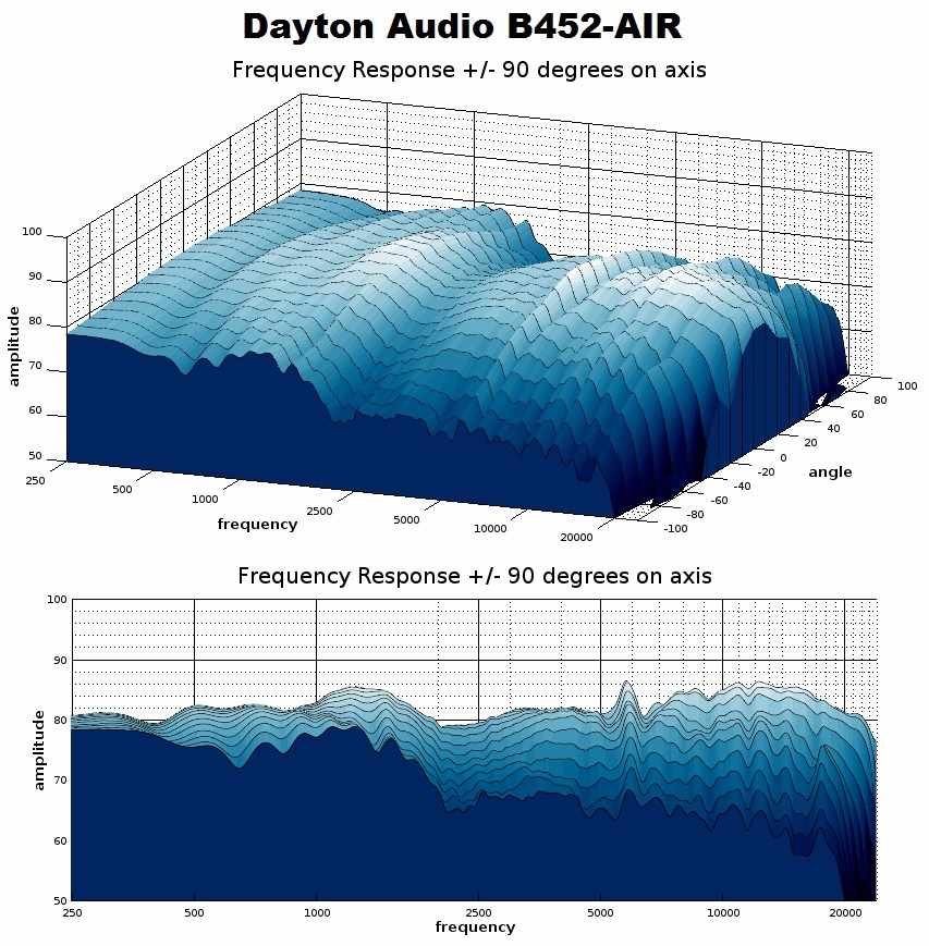

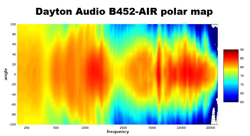

Dayton Audio B452-AIR (left) and C452-AIR (right) Horizontal Responses +/- 100 degrees
The above graphs depict the Dayton Audio Air speaker’s lateral responses out to 100 degrees in ten-degree increments. The graph of the B452-AIR pretty much tells the same story as was seen in the above graph; that is, the shape of the response stays largely the same wherever you are on its horizontal plane. However, the lateral responses of the C452-AIR change dramatically depending on the angle. The reason for this is that the two woofers of the C452-AIR are cancelling each other’s output at different angles and different frequencies. This cancellation pattern is called lobing, and Audioholics has published multiple articles about this effect in center speakers such as Pros and Cons of Various Center Channel Designs, Vertical vs Horizontal Center Speaker Designs, and Center Channel Speaker Design Additional Considerations. All speakers that use drivers on a horizontal plane that are separated by a distance will produce this effect. It’s not a desirable trait for a center speaker, but all MTM center speaker designs (horizontally oriented) will have this kind of dispersion pattern, so don’t think that this is a particularly bad measurement. The bottom line here is, as it is with all center speakers that nest a tweeter between two woofers on a horizontal line, try to listen to the C452-AIR direct ahead of it for the best sound. The woofers start to fight each other at all other angles thereby making for an erratic response anywhere else.

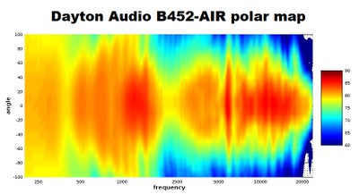

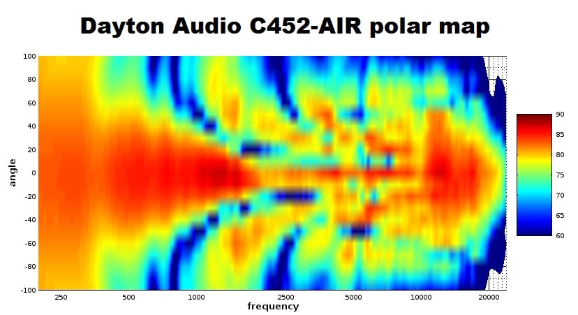

Dayton Audio B452-AIR (left) and C452-AIR (right) Horizontal Responses +/- 100 degrees: Polar Map
The above graphs show the same information that the preceding graphs do but depict it in a way that offers new insight regarding these speakers’ behavior. Instead of using individual raised lines to illustrate amplitude, these polar maps use color to portray amplitude and this allows the use of a purely angle/frequency axis perspective. The advantage of these graphs is they can let us see broader trends of the speaker’s behavior more easily. In the B452-AIR graph, we get a better sense of how the dip at 2 kHz projects itself outward at different angles. Since the response is so uniform across frequencies, it is something that can be addressed with equalization. The C452-AIR is a completely different response though, and equalization will not be able to address the off-axis problems evident there, since the response at each angle is so unlike the response at adjacent angles, and none of them resemble the response of the direct axis.

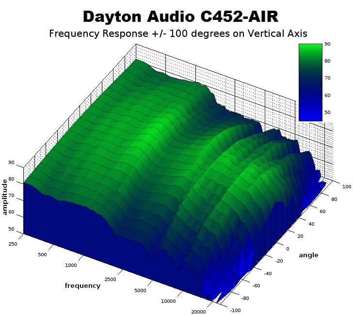

So the bad news about the C452-AIR is that equalization cannot fix that dispersion pattern- but the good news is that this type of lobing pattern can look a lot worse in quasi-anechoic measurements such as this than it will perform in-room. The reason is that the nulls or lines of cancellation in the response actually change in frequency depending on distance, so that if this measurement had been taken at a different distance, these lines of cancellation would shift up or down in frequency. The advantage of that kind of behavior is that, in-room, with dozens of different acoustic reflections from the speaker reaching the ear, many of these lines of cancellation can ‘even out,’ or randomize to a response that can shore up the nulls. Of course, many factors will affect this, such as the ratio of reflected sound to direct sound for a particular room’s acoustics, listening position with respect to the speaker, etc., but it still may be possible to get a reasonable response without any severe dips even when not seated on direct axis for this speaker.

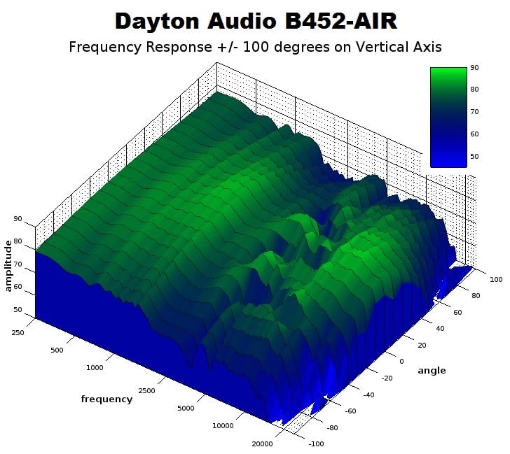

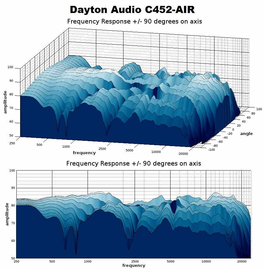

Dayton Audio B452-AIR (left) and C452-AIR (right) Vertical Responses +/- 100 degrees: 3D view
The above graphs depict the B452-AIR and C452-AIR’s frequency response behavior on their vertical axis, where zero degrees is directly in front of the tweeter, negative degree values are below the tweeter, and positive degree values are above the tweeter. The B452-AIR’s response pretty much falls apart in upper midrange frequencies and treble when not listened to on a height roughly level with the tweeter. This is not unusual for a speaker of this design, and it is a lobing pattern that occurs where the tweeter and woofer share the same frequencies range; they will cancel each other out in that range where they are not in phase. On the B452-AIR it is a bit more severe than normal, since the woofer is running full range and creeping well into the tweeter’s territory. Luckily, the vertical response isn’t nearly as critical as the horizontal response since human hearing isn’t as sensitive to reflections coming in from the floor and ceiling as it is to lateral reflections from side-walls. Furthermore, most people tend to listen at around the same height, unlike horizontal angles in which listening positions can be spread over a wide area.
The C452-AIR’s vertical response is a heck of a lot better than its horizontal response, since the woofers are at an equal distance from the microphone at all angles and are always in phase with each other. This speaker would be much better used on its side (vertical orientation) than its intended orientation that places its woofers in a horizontal line. Of course, not many people have room for a tall center speaker. One thing to note is that the vertical dispersion graph of the C452-AIR greatly resembles the horizontal dispersion graph of the B452-AIR. These speakers would be timbre-matched if the C452-AIR was used on its side, but, in its intended orientation, it will inevitably have a different character than the B452-AIR speakers. The same is true for any speaker series that offers a MTM center speaker with their corresponding bookshelf speakers; they can never be timbre-matched unless you listen on direct axis of the center in a room that has little or no acoustic reflections (an anechoic chamber).

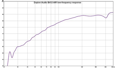

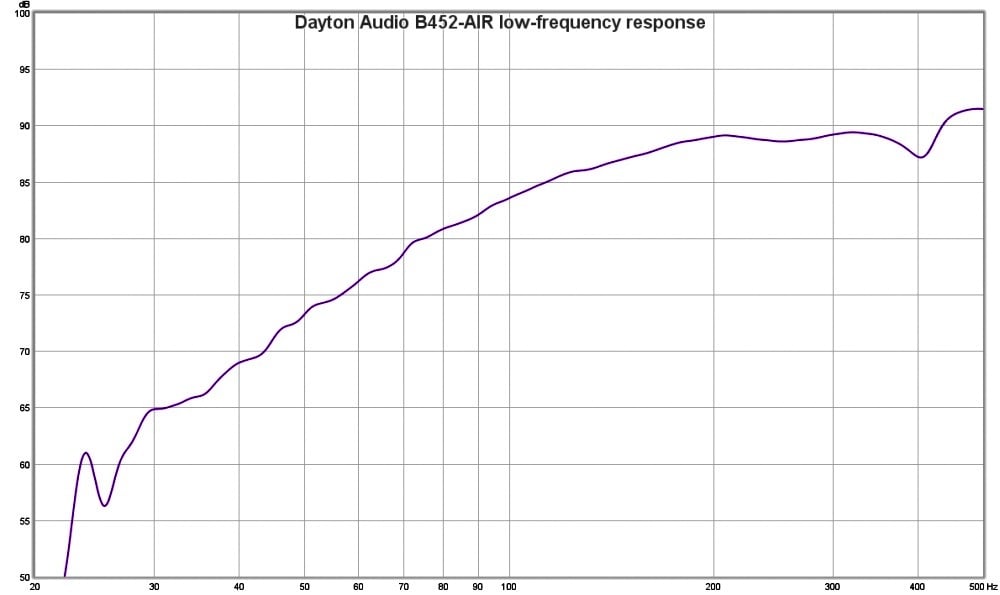

Dayton Audio B452-AIR groundplane bass response
The above graph shows the B452-AIR’s low-frequency response that I captured using groundplane measurements (where the speaker and microphone are on the ground in a wide open area). While the B452-AIR starts rolling off at relatively high 200 Hz, it does so at a very gradual slope and is only down 6 dB by 100 Hz. At that point it starts a more traditional rolloff for sealed designs with 12dB/octave slope downward. The C452-AIR will have a similar low-frequency response. These speakers have bass output, but it is just not very powerful. This sort of curve is good for getting a boost out of boundary gain for a flatter bass response, unlike ported speakers which can end up getting an over-boosted bass response from being placed too close to a nearby surface. However, even a healthy amount of boundary gain is not going to make these speakers the king of bass mountain, and I would want a subwoofer to assist them no matter what. Their bass output is there, but it is slight, and this 4” woofer simply does not have a lot of displacement ability. For this reason, I recommend a high crossover frequency to subwoofers with the Dayton Audio AIR speakers. The higher that these speakers can be crossed over, the louder these speakers can be run without fear of harming them.

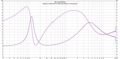

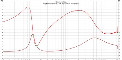

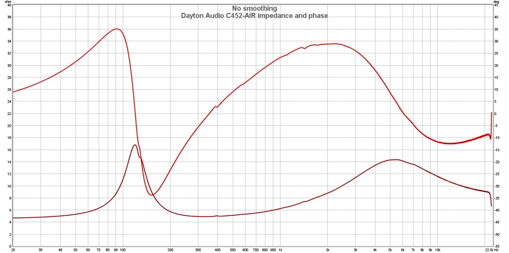

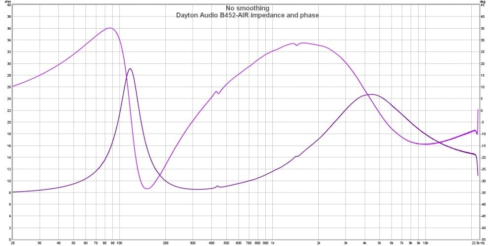

Dayton Audio B452-AIR (left) and C452-AIR (right) Impedance and Phase Response
The above graphs show the electrical behavior of the B452-AIR and C452-AIR speakers. The B452-AIR is specified by Dayton Audio to be a 6-ohm speaker, but the truth is it is it has quite a bit more impedance than that. At worst, this is an 8-ohm speaker, and Dayton Audio could even spec it at 10-ohms nominal, and no one could reasonably argue with that. The phase response doesn’t add any stress to the impedance either. This is probably the most benign load I have ever measured, and pretty much any amplifier in the world could handle this speaker easily. The C452-AIR impedance shape is much like the B452-AIR but the impedance is halved, so it’s clear that the woofers are wired in a parallel circuit. Dayton Audio spec’s the C452-AIR as a 6-ohm speaker, and I would say that is mostly correct. The C452-AIR is not a bad load but it is not as easy on amplifiers as the B452-AIR. It is essentially twice as difficult to drive for the same input voltage, but since the B452-AIR is such an easy load, that still isn’t bad. Any AVR can drive a set of these speakers with no problem.
I measured the sensitivity of the B452-AIR at 81.4 dB at 1 meter for 2.83v. That is low but not surprising for this design. The C452-AIR sensitivity measures at 86.8 dB at 1 meter for 2.83v which is almost exactly what would be expected given the impedance and design differences between it and the B452-AIR. While the C452-AIR is a more difficult electrical profile for amplifiers, it is four times more sensitive than the B452-AIR, and that means that it’s actually be easier to drive, since it can still achieve the same loudness level for half the wattage.
