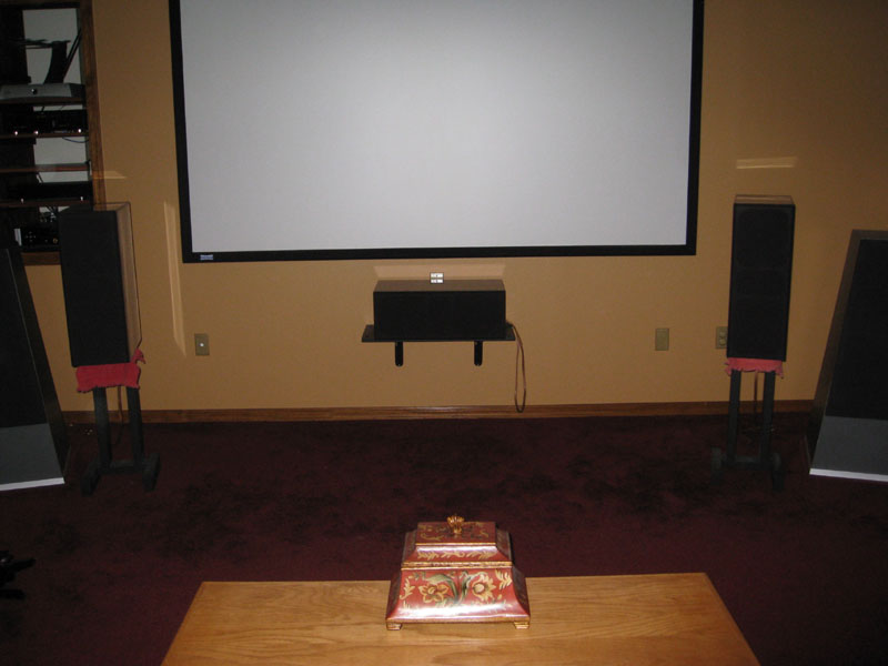

L-C-R Speaker Setup

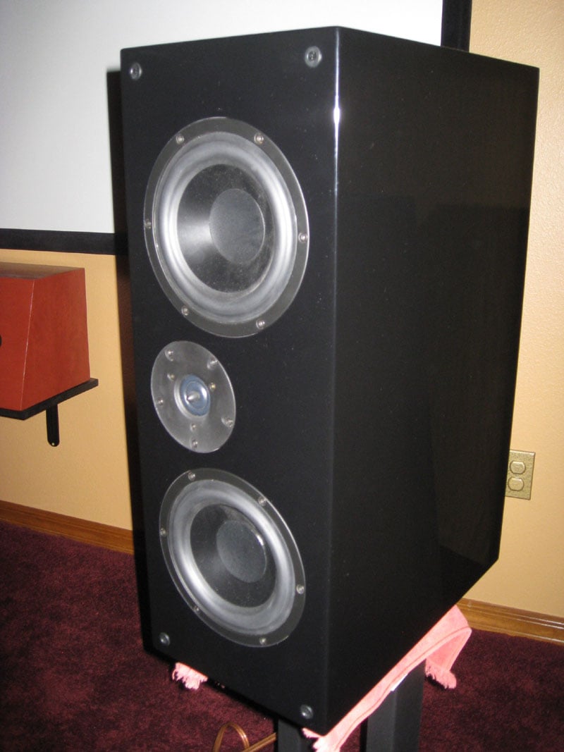

Going back, one of the first thing I noticed with these speakers was the first-rate piano black finish. It was smooth and glossy with no imperfections. Now moving more toward the functionality of the build I noticed that this MTM (midrange-tweeter-midrange) design had the tweeter offset from the center which makes this a mirrored pair of speakers. While this is great for the having non-symmetrical diffraction it clearly is not a D’Appolito design which has its own advantages by having vertical alignment of the drivers and a properly designed crossover. Next, I noticed that they were rear-ported speakers; other than losing 1 or 2 Hz in the low end there is no disadvantage to placing the port in the rear and I’ve used them in my own design. The main advantage is that the front baffle area can be minimized reducing diffraction effects and another is it aesthetically looks better. Speakers should look good; they are a piece of furniture and most manufacturers put great efforts into aesthetics.  The connectors are 5-way binding posts that accept banana plugs but the spacing doesn’t allow dual banana plug connectors.

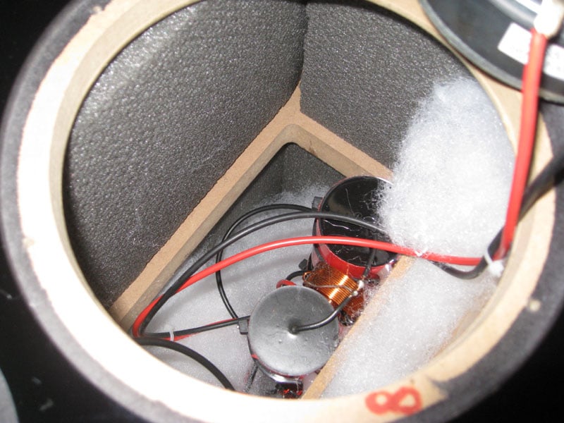

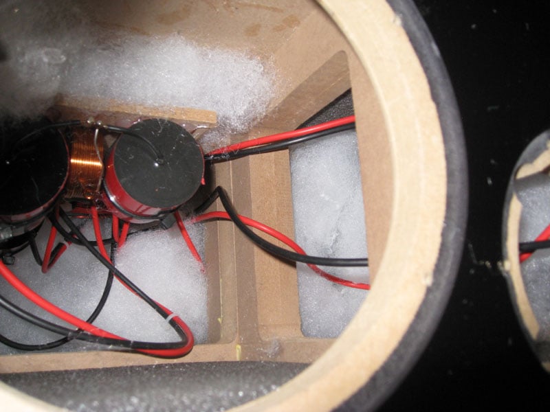

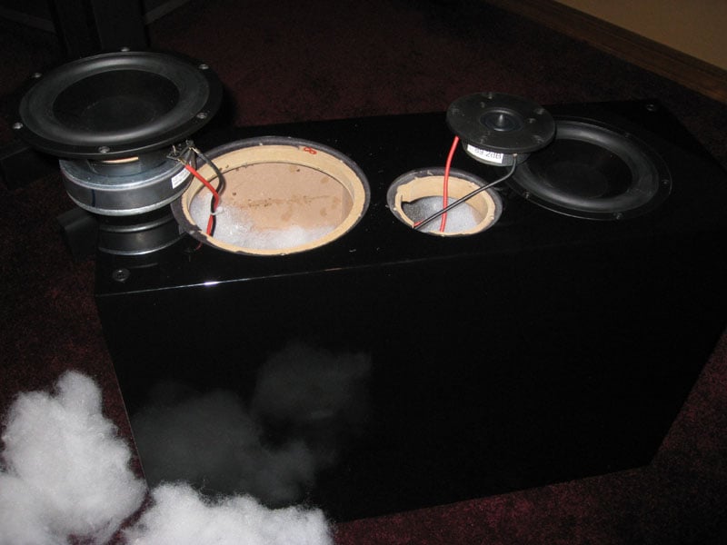

It probably doesn’t matter to most, but the drivers were fastened with Allen head screws. This prevents a screwdriver from slipping off into the cone although most people will never be removing the drivers. Once the drivers were removed the first thing I noticed was the cabinets were completely stuffed with a polyester fill. In addition to the fill all of the walls were lined with ¾” foam.
Trinity L/R Drivers and Bracing
The cabinets were extremely well braced with double layers of shelf bracing. Now I know why I felt no vibration with heavy bass playing. All of the wires from the crossover were soldered to the drivers. I personally do not put a soldering iron to speakers for fear of damaging the voice coil but since I do not know Angel City’s process it may be completely safe. I didn’t pull the crossovers out but they looked well-constructed with good components.

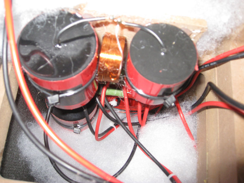

Trinity L/R Crossover

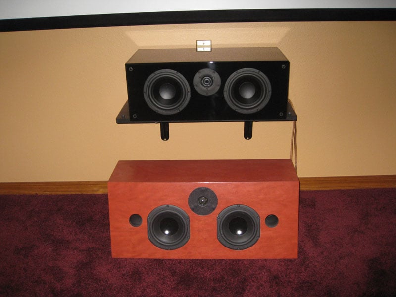

The center channel speaker is basically the same design as the main speakers except that it is not as deep (4” less deep actually). Having the offset tweeter for the center channel is a pretty good design when you lay it on its side because it gets a little closer to a vertical alignment as opposed to a Midrange-Tweeter-Midrange design where the design concept is completely lost when on its side. I did the same type of design for my own center channel speaker as you can see here.
Center speaker design similarities

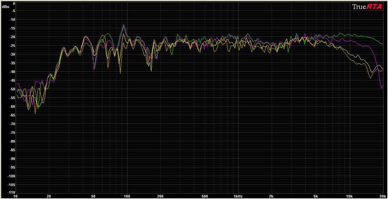

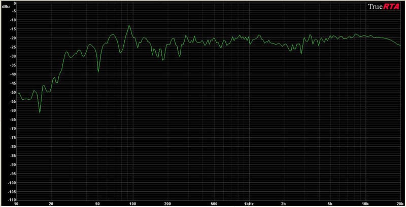

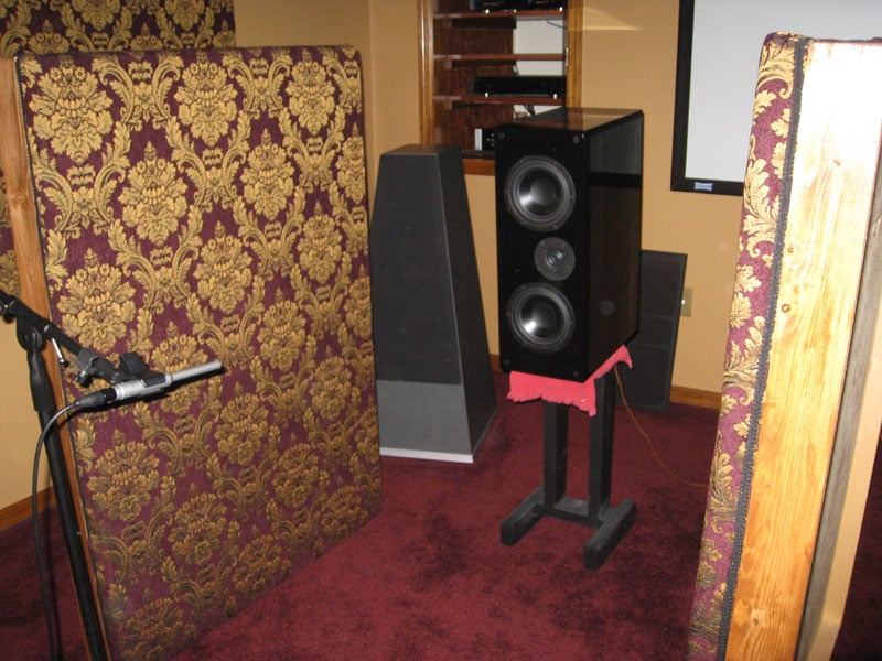

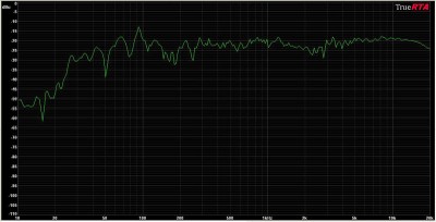

ACtrinity.jpgThe measurement and analysis I performed for these speakers are very basic; a frequency response at 1 Watt at 1 meter and then the off-axis response. I did take care to isolate the speaker from the room by placing the acoustic panels on either side of the speaker. I usually overlay a near field measurement of the woofer up to 300 Hz with the rest of the response. Since the Trinity’s have 2 woofers I didn’t do this measurement so don’t pay too much attention to the response below 300 Hz. After the direct measurement I did off-axis responses. I used True RTA software because it is easy to use and I like the quick sweep function.
The on-axis frequency response of the Trinity’s is very flat above 300Hz except for a small dip at the crossover frequency at 2 KHz. On the low end remember that there was some room interaction.
Trinity L/R On Axis Response
For the off-axis response the microphone was place at 30, 45 and 60 degrees off axis. In the Home Acoustics Alliance training certification we take off axis measurements for the purpose of seeing the response shape as the microphone is moved off axis. The shape of the off axis response indicates what kind of acoustical treatment, if any, should be used for the speakers direct reflections. If the shape of each off axis response is identical to the on axis response then direct reflections are okay. If the off axis responses are not the same shape as the on axis response then some sort of acoustical treatment should be used. It is not bad that the responses may not match; it is only an indicator of what to do acoustically. As can be seen for the Trinity’s, there is a change in the response shape at 15 kHz which means that these speakers’ direct reflections should be absorbed or diffused.  As I mentioned earlier for my listening tests I placed absorption panels on the floor for their direct reflections.
Trinity L/R 30, 45, 60 degree Off Axis Response
