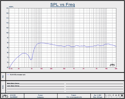

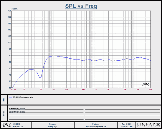

Frequency vs Impedance and Phase Plots
The frequency response graph is a near field woofer response summed with a 1
meter on tweeter axis response that has been 1/3 octave smoothed. This graph does not include the
port response which has its maximum output at 49 Hz as indicated by the woofer response dip at 49
Hz.

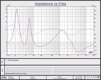

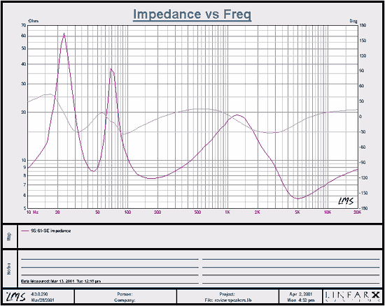

The impedance graph includes magnitude and relative phase. The smooth plot
represents phase scaled in the right vertical axis. The bumped plot represents magnitude of
impedance scaled in the left vertical axis.
