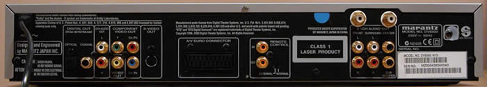

  • System Motor Driver: Rohm BA5888FP
  • MPEG/MLP/DD/DTS Decoder: Panasonic MN2DS0004AB
  • DSD Decoder: Sony CXD2753R
  • Memory (Flash): L324 45K
  • Memory (DRAM/SDRAM/SRAM): 16Mbit (512Kx16x2) Samsung K4S161622H-UC60, (1Mx32x4) 48LC4M3282
  • D/A Converter for Video: MN35202 54MHz/10bit
  • D/A Converter for Audio: TI/BB DSD1608 192KHz/24bit
  • 2 channel audio op amp: KIA4558F
  • 5.1 channel audio op amps: 3xJRC4580
  • Clock generator with dual PLLs: 8707FV

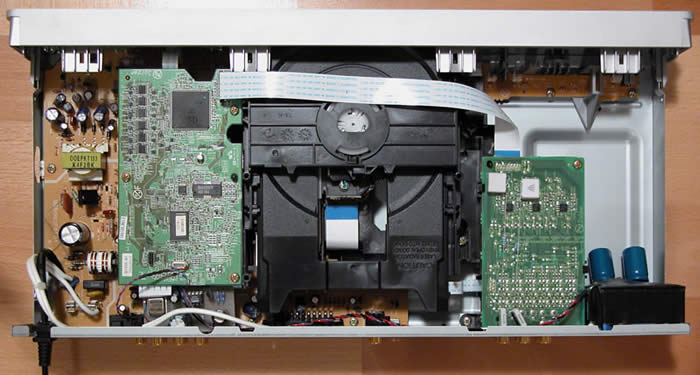

  • JLTI modifications: Level 2 Reference clock 27MHz, improved analogue 2-channel audio, and SuperReg power regulation

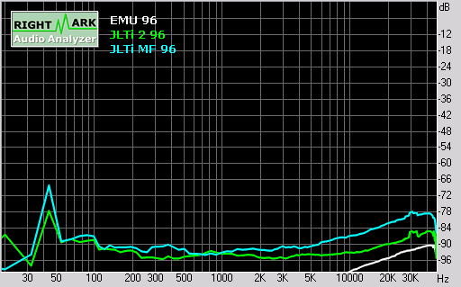

  • Poor progressive scan implementation (not motion adaptive, no film mode detection, chroma upsampling error, and overly soft image quality)
  • Poor measured audio results (low and high frequency attenuation, reduced output level, high intermodulation distortion above 1kHz, and clipping on 0dBFS+ levels)

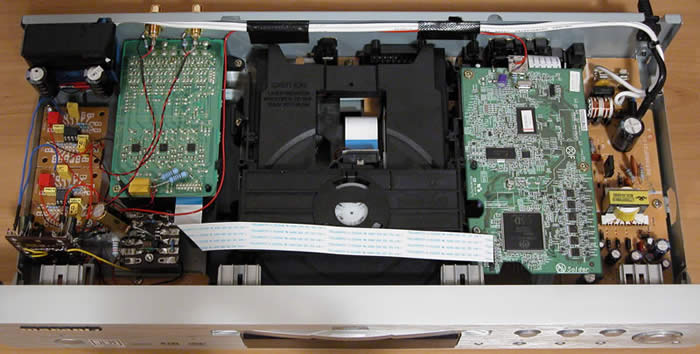

Ever wished you could own a truly high end esoteric digital player but your budget is limited to mass market players? Joe Rasmussen from Custom Analogue Audio reckons he has the answer. Using a cheap mass market universal player (the Marantz DV6500, normally retails for A$799 – US$649), Joe has upgraded it with technology from Vacuum State Electronics (Joe is the Australian agent) to create a “state of the art” two-channel universal player called the “JLTi SACD Player” that is being sold by Pymble Hi-Fi in Sydney, Australia, for $2,500 (~US$1,900).
