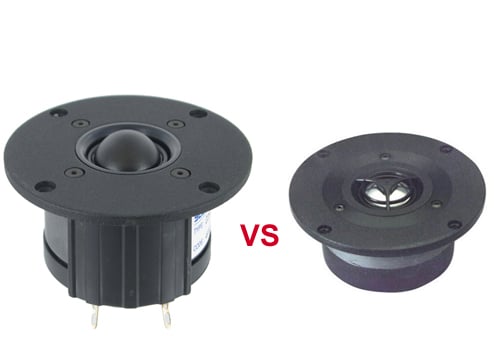

There has always been an ongoing debate about the sonic characteristics of tweeter dome materials. Do metal dome tweeters really sound "harsh," as some claim? Do silk domes sound, well, "soft" or  "silky"?
Different materials do have different physical properties as it relates to diaphragm performance and these can and do influence the audible behavior of the driver. With full knowledge that many well-respected designers and engineers have opposing views and opinions on the subject, there are a few basic generalizations that can be made about different tweeter dome materials.  We discuss these points in our recent YouTube Video below.
Soft vs Hard Dome Tweeters Comparison: Which one is better?

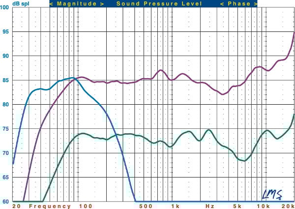

The metal dome breakup manifests itself in the frequency response curve as a sharp peak, or a sharp dip in its usable frequency range.  You can see a prime example of this in a recently reviewed Infinity speaker by Sound and Vision Magazine. Notice the frequency peaking of +10dB out to 20kHz.  Some folks may perceive this as detailed or airy while others with more sensitive hearing may find the speaker to sound harsh, especially at loud listening levels where the tweeter can get overdriven.
Infinity R162 Frequency Response
Infinity R162 Speaker Measurement Courtesy of Sound and Vision Magazine

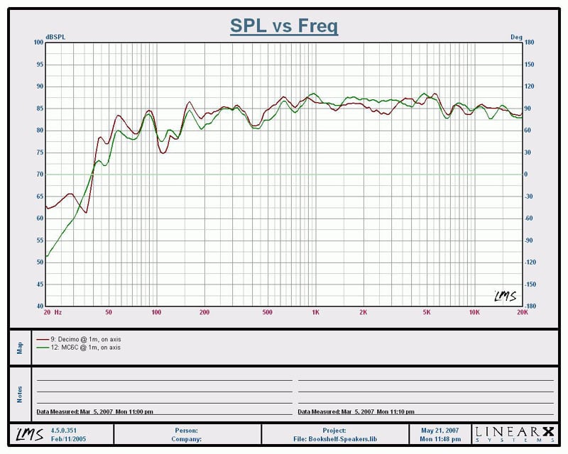

In contrast look at how smooth the frequency response is of the speakers below.  One of them uses a properly engineered metal dome tweeter (the RBH MC-6C) while the other uses a soft dome tweeter (the Status Acoustics Decimo).  Both speakers are excellent examples of products that utilize high quality tweeters with well controlled dampening properties.
RBH MC-6C and Decimo Speaker
RBH Sound Frequency Response Measurement
Red trace: Decimo (soft dome) ; Green: MC-6C (metal dome)
..regardless of dome material chosen, a lot comes down to implementation
